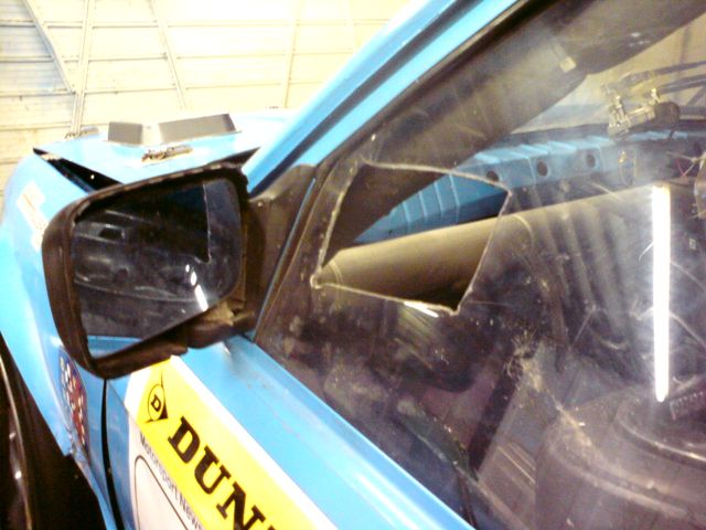

                fisrt stage of the anti misting up fixes, well it might not help misting up, but whats not there cant mist up, so whatever happens from now i will always be able to see in the mirrors obviously the shape of the hole is dicated by seating and mirror postition, this hole is slightly weird shaped the other even more so

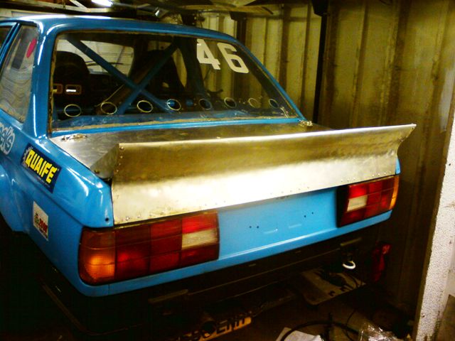

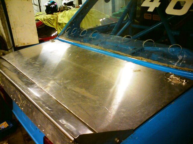

                somthing that did unnerve me about the way the car went at brands is that it was rather backendy in the very high speed corners, not something im used to, in a way it wasnt suprising as i not only have removed quite a chuck of weight from the car, most of which has come off the back but also am now running a very small rear spoiler as oppsoed to the big wing spoiler which was on the car before and i havnt tackled any real high speed corners since i took it off, so after a coupleof false starts as further modifying existing spoilers and boot lid into a duck tail design, i realised the simplest, lightest, neatest and most rigid way to do it would be to cut the back section of the boot lid off and attach an alumiunium spoiler directly to the body work, the spoiler is hand formed mainly using a rubber mallet to beat it into shape using an old RSJ to get the sharp creases
                after finshing the spoiler i realised it was now just a small step to replace the rest of the bootlid with alloy, so hey presto more downforce and i've saved 4kgs of weight, shame richard tells me he's lost 12kgs out of his 205
                you can also see the second anti fogging stage, a row of holes in the rear window
