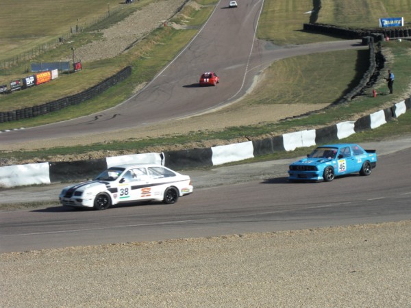

        In the mean time while Graham does his write up heres a pic of his car that I think he'll like that I just found on my camera from Lydden
          #889
          nice picture its good to think i actually had two engines on track that day they both behaved impecably
          it goes without saying the cars werent in that order for long

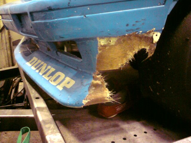

            actually i didnt do that much prior to the event
            i looked at the now battered front bumper/spoiler which after my lydden grass tracking
            is totally missing its splitter and one corner
            and decided not to do anything with it! its getting late in the year not many events left, and im short of time, plus it was an ideal chance to try the car without the splitter at a fast circuit as i certainly didnt notice any difference after loosing it at lydden.

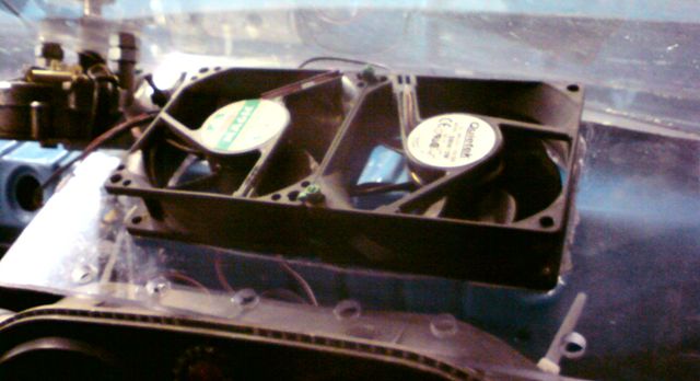

            the only other thing i did was to act on an idea from jimbo and install a couple of computer fans to give me some demisting equipment, they actually blow a suprisng amount of air and consume only a tiny current

                    loosing the splitter made no differece! only once did the car understeer when i simily entered a corner way too hot, even then it wasnt terminal,
