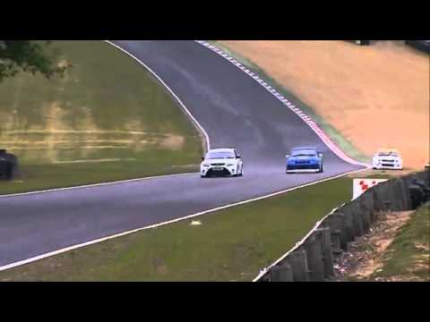

        a link from the last brands outing,race1 was damp at the start and was wet twards the end making life of slicks interesting, race 2 very wet, they just caught my trip into the pitwall

          #1639
          we need more of that on normal tv, great to watch, thanks for posting it up

            #1640
            That is some excellent racing. It is great to see such a variety of cars together from different eras of racing. The first race looked like fun but the second one must have been a nightmare.
            If there was more of this on television it would help everyone in that it might generate a bit of sponsorship to help pay for the race cars.

              #1641
              damn, that really was wet, and the LED's stood out quite nicely. Are there going to be more videos of races or was it a one off?

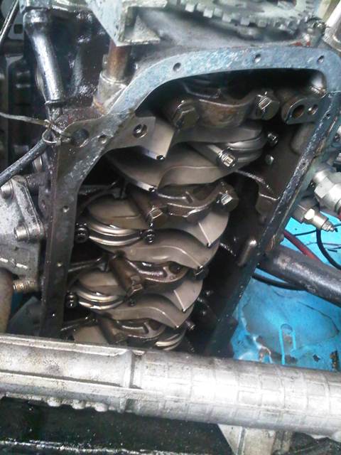

                                pre event prep was minimal, apart from fitting a new windscreen i dropped off the sump to attend to the leaking gasket, lucky the dry sump pan just about wriggled out with have to remove anything else
                                TBH i didnt expect to see this again so soon!
                                whilst the sump was off i did split the ends and took a look at the bearings, they clearly had done some work but werent worn as such, in fact the mic'd up thicker than my new spares! so they went back in, along with a new oil filter and valvolene 20/50, several people have questioned why im running thick oil pinto oil in a multivalver, simply because i've never had an issue running the stuff and despite not running an oil cooler oil pressure holds up perfectly even over a 20min race.

                                i wasnt unhappy with practise but didnt feel i had gone very fast, more worrying was i appeared to of done yet another wheel bearing,
                                what was really nice was stephen my son had made it down to the meeting so with his help we checked out the bearings and found nothing! eventually i found the issue, the R/H engine mount sits on a plate which sits on 2 RS2000 engine mounts, the metal disc and stud on the rear one was was coming unbonded, and allowing the engine to more sideways enough to touch the steering U/J, so with the help of a ratchet strap, wheel tether we found a way to lash the engine over a bit so it stayed clear of the U/J
