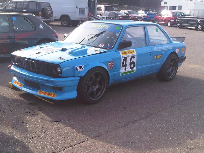

      not much progress to show today, a work college came over and repaired about a dozen chips in the screen, after which i stuck some new decals on, i went to change the clear film over the headlamp lenses because it was pretty grotty, and both glasses basically fell to bits, so que fitting two new headlamps, and a few other bits of tidying, stil got quite a few other jobs to do, but its looking a lot better

        I know theres not much space but i'd like to see a pic of the whole car so we can see the new ride height..
        Looks pretty low from that pic.

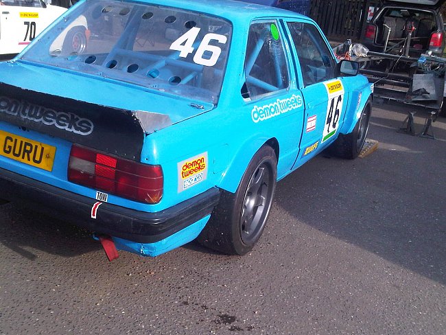

          that gives a clue, i cant jack it up under the diff from the side of the car any more, the body of my bradbury jack wont clear the sills, niether can i get it under the front x/member, so if i want a whole end of the car up in the air it needs one jack either side

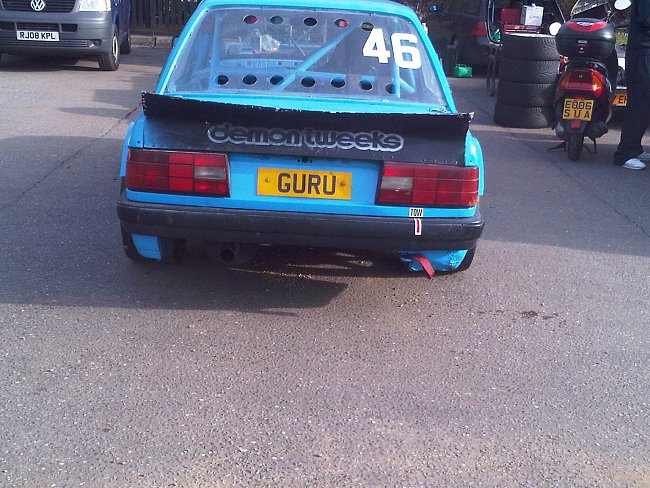

              is it me or is the back of the car on the wonk?
                #1807
                some of it may be camera angle but yes the o/s quarter has been squashed down

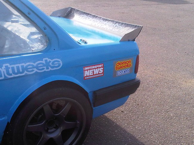

                  that's a shame, was hoping for a masterful plan on making the n/s edge of the wing higher up, clever aerodynamics
                    #1809
                    its already higher
                    what i might do though is remake the end plates so its a bit flatter and will cut the high speed drag
                      i remember you saying it was really noticeable at thruxton, so like you say it could be more drag than downforce at it's current angle.

                          a couple of the jobs was to fit new pads all round as ebc had made me a set of their new orange stuff to try out, change the brake fluid, to tidy the back of the car up, i stripped an outer skin from a rear bumper cut it down and attached it to the car, i have to say im well impressed with how much smarter it looks, i had to chuck a new set of headlamps in, as when i tried to peel off the protective film which was looking very dirty and scabby, all the glass came off with it, as the film was all that held the glass together, i made some new end plates for the rear spoiler so as to lay it over more, and improve the areo a bit and reduce drag slightly, and spanner check the suspension, track it up and give it a general clean.
