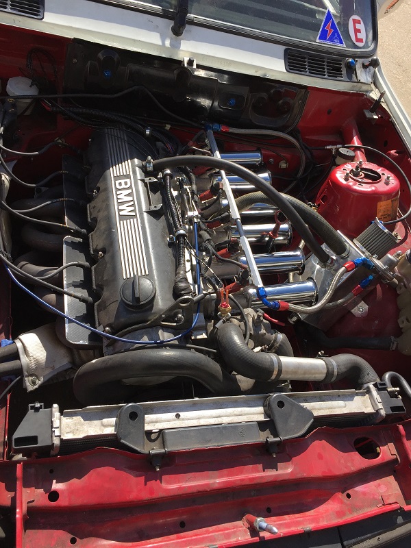

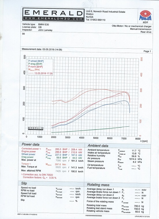

    i had a trip over to the rollers today, to check the engines health, mechanically its almost the same as it was when last run up, the only difference being ive fitted some slightly longer inlet trumpets, which it really liked, they have moved the torque up the rev range a bit, and it hangs on for longer which has added 16bhp, its now got 283 bhp, which is stunning for a bmw m20. we did also try some 102 octane fuel, that did make a bit more power but only a bit, another 2bhp to be exact, so i wont be buying any of that, that said the 102 did hang on longer, so if the engine were to rev to say 8500 i think the difference may of been more

      Very respectable I guess the top end misfire is cured then?
        yes proper fixed, i was pretty certain as several times id tried it round the industrial estate, where i could run it into the limiter and hold it there. i did think it felt stronger than its ever done certainly the way it pulled right to the limiter, but i put that down to where i was drive.
        Doing the maths the extra power and cars diet has improved the power to weight ratio by 35bhp/tonne, no wonder it felt quick

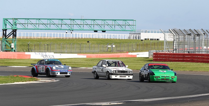

            at least i had a decent enough idea of where i was going to be competitive and had a good dice with first a 911 and then a 944 both in the above picture i got past them both, interestingly i was able to get past the 944 on the brakes, keeping an eye in the mirrors it was clear the lower powered fwd cars were practically as quick over a lap, looking ahead i was pleased to see i was catching another beemer an E21, i know that car slightly and round brands it cant get anywhere near me, but an unfamiliar circuit is another matter, still i was catching him and hoped to pass it when i noticed the car push on in a couple of corners, more throttle problems, this time it was sticking. i pitted, got out bent the pedal which seemed to fix it, got strapped back in and headed out again, a couple of corners it was sticking again big time, so i pulled off for good.

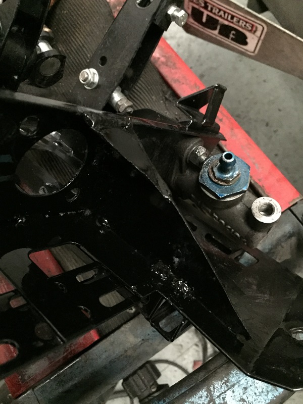

            looking at the car the problem was obvious, in use the pedal box has bent and that was jamming the throttle. another DNF, oh well, it should be easy to fix!
            i have to say despite the dnf i was pleased how it went, i enjoyed the way the car handled and actually got to race other cars, the sea sick pills seemed to work too
              • 25249
              i whipped the pedal box out, and welded in a brace between the brake cylinders

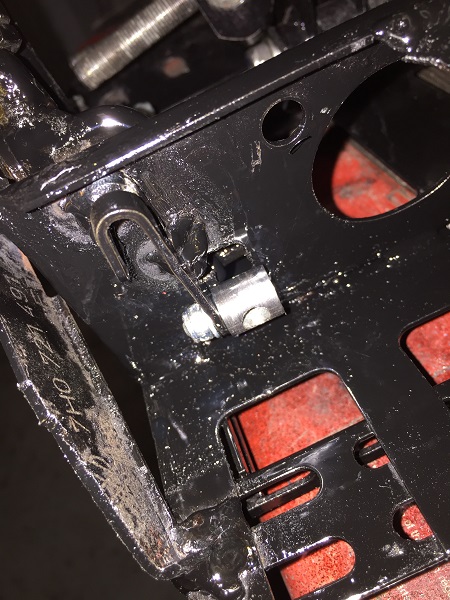

              i reinforced the throttle pedal pvot, next i changed the throttle cable attachment, robbing some bits from an old linkage kit, the outer cable is now retained by a retainer that can pivot, before when you got to about the last 3rd of travel the linkage would bend the inner cable and pull it tight up against sides of the drilling in the cable retainer, it was only a matter of time before the cable either snapped of frayed, now when you are deep in the throttle the cable retainer will pivot, keeping the pull on the inner cable straight, so it doesn't rub on anything or get bent, so in theory ive seen the back of throttle issues. i must say i now think that when its time to get a pedal box for the 2002im going to spend proper money and buy a tilton or AP box

                i did the pivototing cable holder on a westfield. it was stretching the cable every outing but once i fitted the pivot it was sorted.
                  Very good figures. What camshaft does it use?

                    schrick 302
