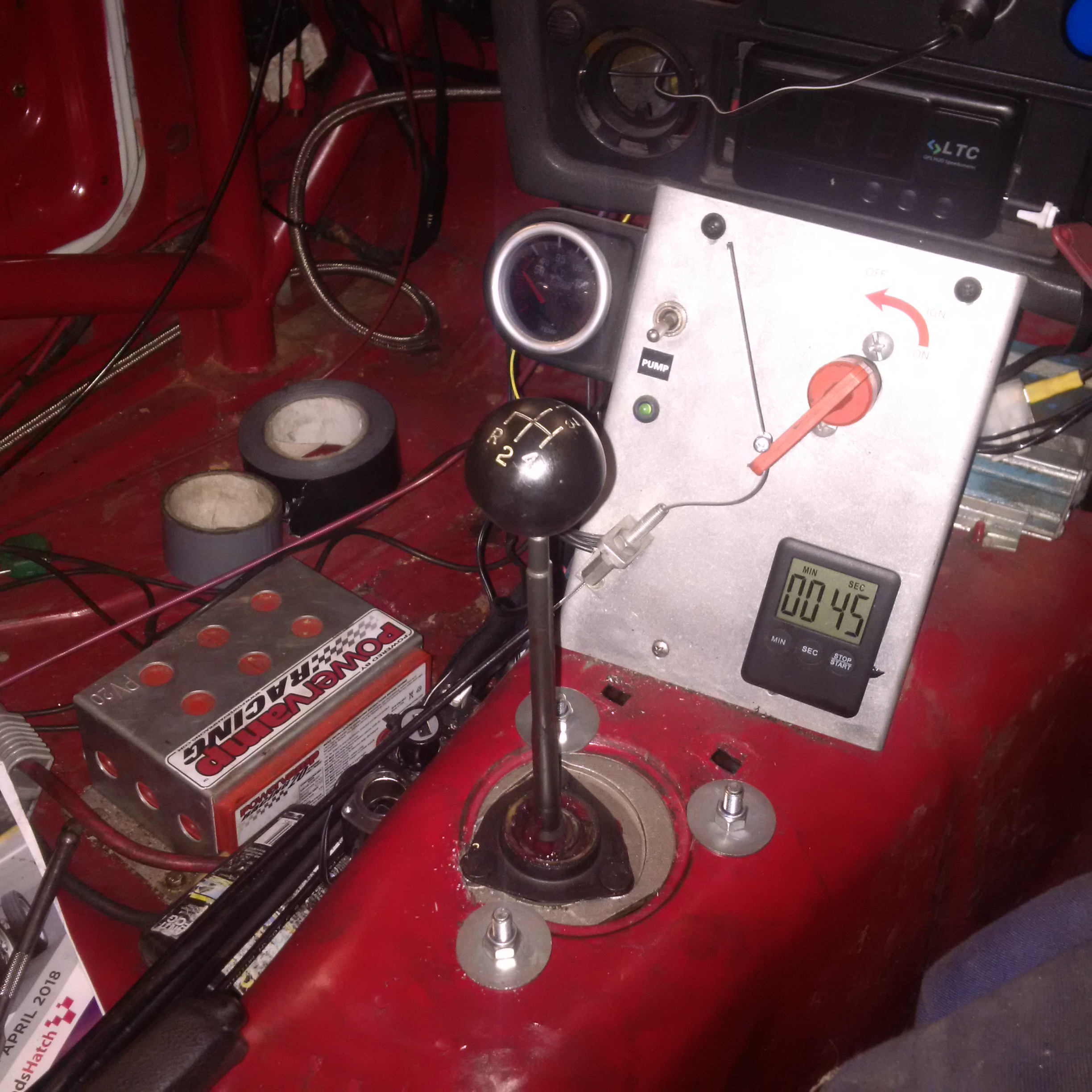

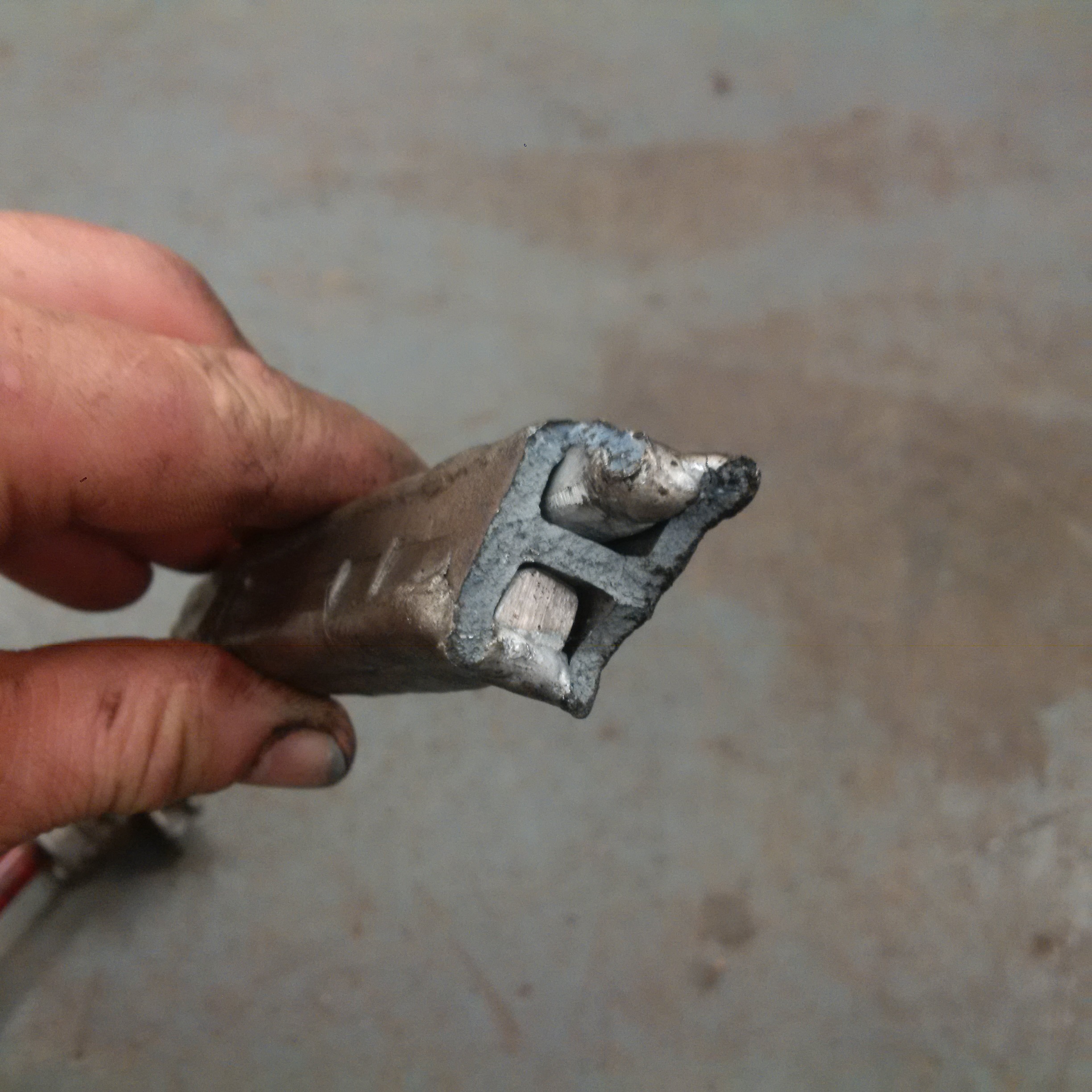

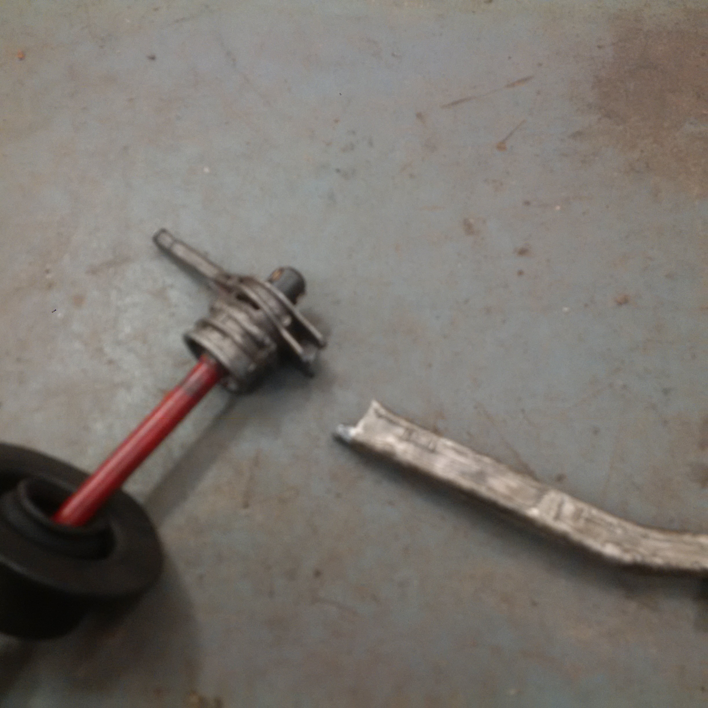

        its took a while, but finally ive got to do something on the car,
        someone spent a lot of time and effort welding and strengthening the gear linkage, unfortunately, it broke just where the work finished.
        what ive done is do away with the remote stabilizer part of the linkage, something i did on both the old e30 and 2002, and fitted a pivot to teh bodyshell itself, the pivot is actually rover P6 auto, coupled with a modified manual p6 lever
        on the trailer at least, the gear change feels very slick, the old lever had been modified to shorten the throw, ive gone a bit further and been able to get it slightly closer to me, handy because it was a stretch to reach the gear lever before

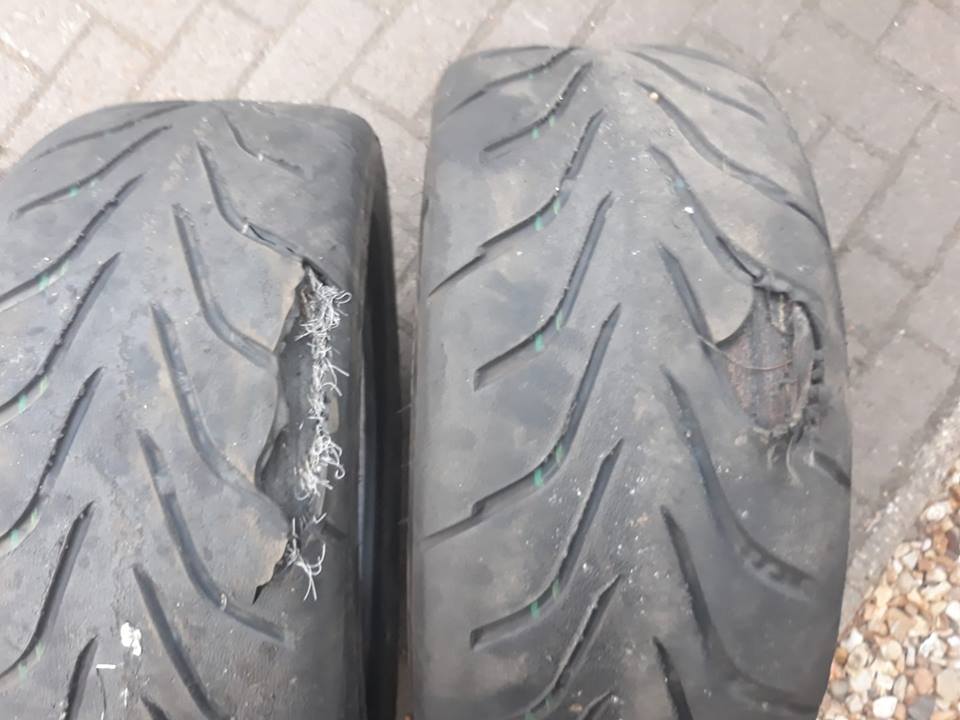

                after that it was off to brands for a 40 minute pit stop race with the cscc, considering gear lever aside the car was the same i felt much more at home in it, we had a long 30 min practice session i decided not to bother pitting if felt good, about 20 mins in the tyres started to go off , so i did pit, i wasnt sure if i had overheated them or something else, or whether it was the 30 plus degrees temp causing issues, i sat of a coupe of mins and went out again, that was a mistake i had a violent steering judder and the car just didnt turn in, i was missing apex's by miles, so immediately returned to the pits and checked the tyres. the left front had de-laminated badly.
                back in the paddock i showed the tyre to the tyre technician and asked his advise, he thought it was merely down to the heat, not helped by the tyre being 11 years old! interestingly he didnt see an issue with the set up, only the track temperature, i would of bought a new tyre but as i had a spare he didnt want to sell me a new tyre, that was a first! .
                the good news was with no real changes to the car i was 1.2 secs a lap faster than my previous outing, and for sure if temps had been a bit lower i would of gone faster still, i had an idea i was fairly quick, but stunned when the practice times came out and i was 7th fastest overall! the was nothing to do to the car other than change the shagged tyre so we relaxed in the very hot sun.
                come the race despite a start procedure which was new to me i got a good start and made up a place only foe the race to be red flagged half a lap later. after what felt an eternity sitting melting in the car on the grid the race restarted, i held my position and even made one up, i was running a comfortable but lonely 6th overall, the leaders had pulled about half a lap on me, and i was way way ahead of anyone behind me, trying to push really hard had the car just sliding around, at one point going through surtees i lost the rear and and ended up sliding broadside a full 90 degrees to the direction of travel, finding myself looking where i was going out the side window i thought i was going off into the tyre wall, but somehow collected it up and carried on, proper drifting stuff, just not what you should be doing in a race!
                i didnt have a plan regarding when to pit, i had decided to play it by ear, as i had clear track both infront and behind me the best thing seemed to be wait until i start to lap back markers then pit, if i was lucky and the guys at the very front hit traffic sooner perhaps could get me back in touch with them, wasnt to be, about 25 mins in a familiar steering judder came back. i pitted and sure enough another tyre had delaminated
                so another dnf, but i wasnt too bothered as i had front running pace, but was never going to trouble those at the very front. Afterwards talking to the cars previous owner he is sure the issue with the tyres was just the age of the tyres, i think the heat had a major part to play, but im sure some of it is suspension geometry, i have been running the car set up as it was previously raced, thats with 4 degrees negative camber in the front end, to my mind that is probably ok for a 15 min race, but given the air and track temps and me trying to do a 40 minute race i think i was always destined to melt the tyres, 11 years old or not.
