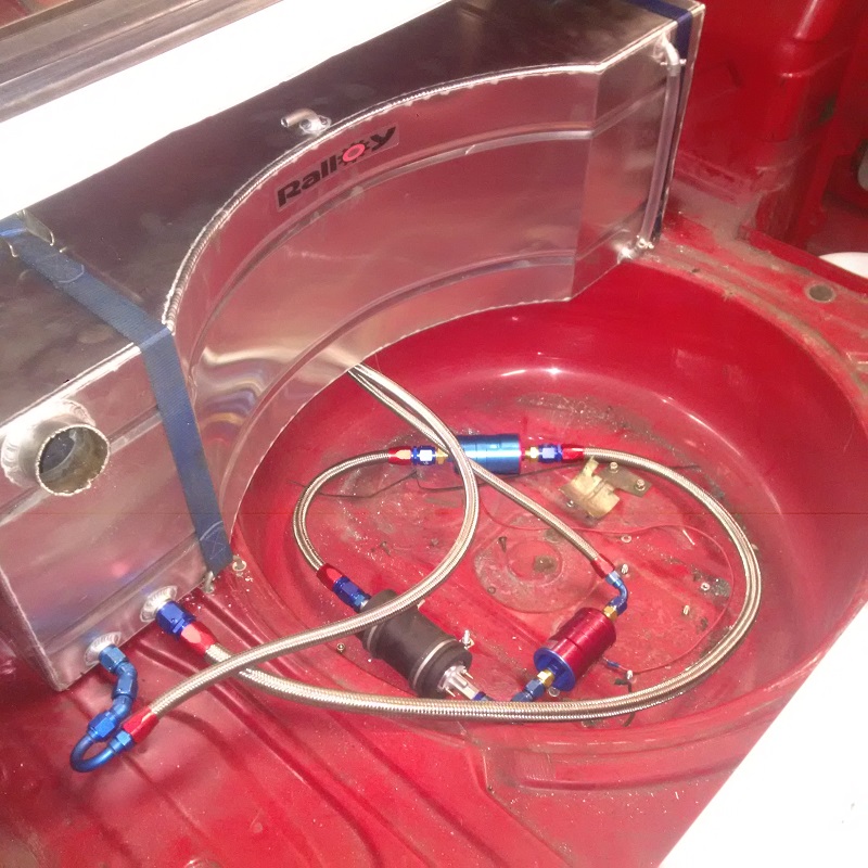

progress . more than the pic shows actually, i decided to make things simple and use an escort tank with a built in swirl pot, but then i had to weld a well into the boot floor to accommodate the swirl pot! initially i just cut a hole, but MSA regulation does not allow exposed alloy tanks, plus the swirl pot is right over the rear silencer, and also in the firing line if a drive shaft failed.
the pic does look rather like everything is just thrown in, but that partly because i was running very low on fittings and i really really didnt want to buy anymore, so i just had to find a way to make it all connect up, ditching the badly plumbed standard tank set up has cost about £600 with new filters pumps etc, i could of done it cheaper, and in the past i would have but the scrut in me is saying dont take chances with high pressure fuel lines

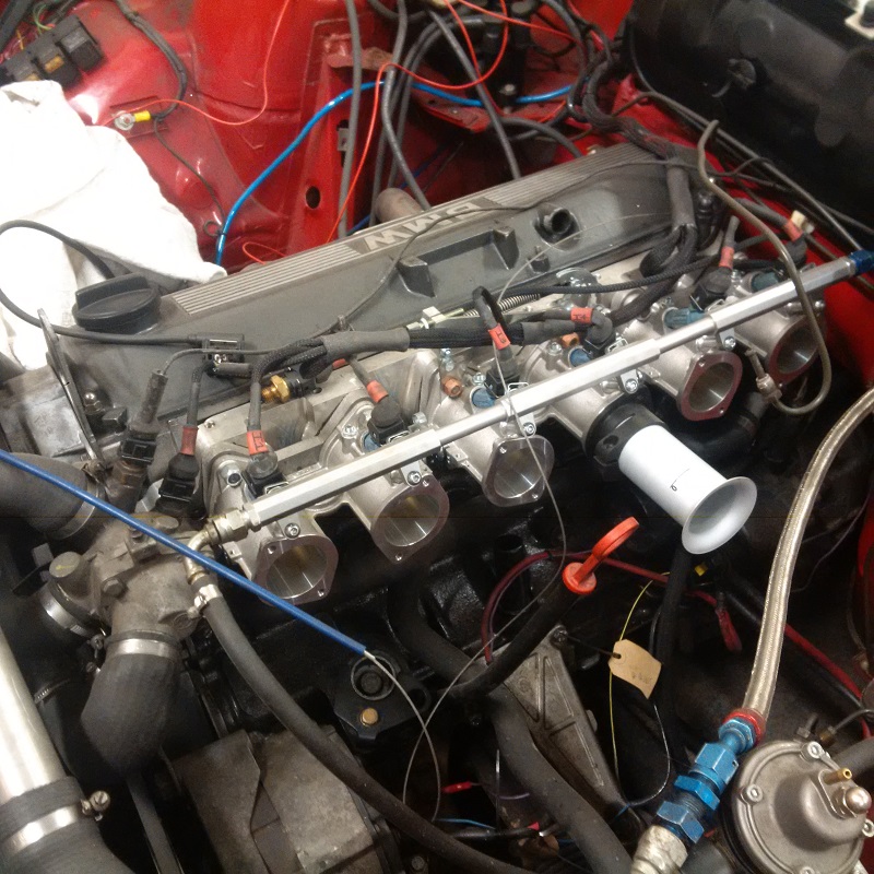

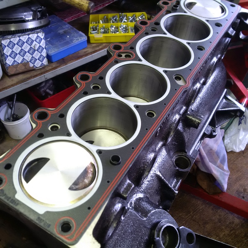

yeah, its still got a bit to much compression, at low revs any real throttle opening it wants to det even with the timing fairly retarded, as the revs go up and the head start to strangle airflow its happy, most we saw on the rollers was 267.5bhp , but that was at the limiter which currently is only at 7K and power was still climbing slowly, it will probably make a bit more power with a few miles, as the first full power run with timing and mixture correct gave 262, but after we did some more work on the mid range mapping and did a further full power run it went up to 267, so it loosened up a fair bit with not a lot of running, so a few more miles will probably show a few more horses.
the main thing is engine wise at least its ready to race.
