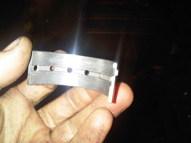

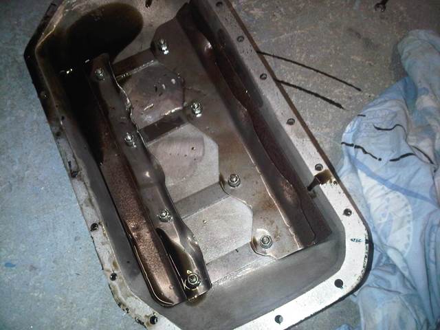

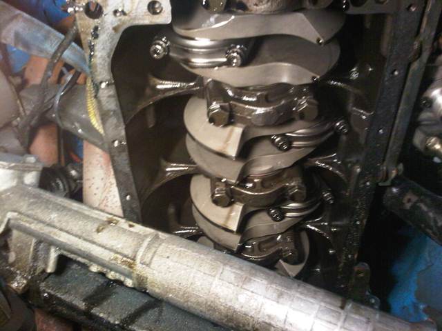

      bit the bullet this morning, and dropped the sump, it looked good, no surprises, and no evidence the engines eaten itself
      looking up at the crank same again, no evidence of anything amiss

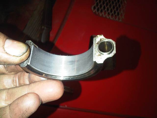

      nothing wrong with the ends, i might even just put them back.
      some of the mains are looking rather battered, im guessing the long stroke shortish rods and no crank damper are giving them a hard time, guess i'll have to use a damper if i ever build a longer stroke 2.7, but tbh they dont look that bad, infact they were secondhand when i built the engine!

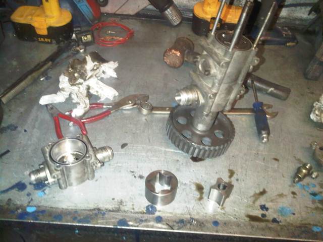

      nought wrong with the oil pump either!
      so i'l get it a new set of mains and put it back together and see what the gauge then says, but what ever its says i will know the engines actually ok

        good news , sort of, would have been nice in a way to find something obvious so your'd know the cause of your problem.
          #1834
          the main thing is it isnt in need of serious surgery, god knows where the metalic bits came from, i guess the could be left overs from the broken crank, dunno where they could of been hiding through it was all cleaned to within an inch of its life before the rebuild.

            Glad the engine looks ok, i take it the issue cant be top end then?

              i dont think theres an issue in the top end dave, the blocks oil feed to the head a restrictor in it so you cant loose significant amount of pressure through the head, plus it mechanically sounds good, s14's are known for sounding like a bag of nails at the top end, this is anything but.

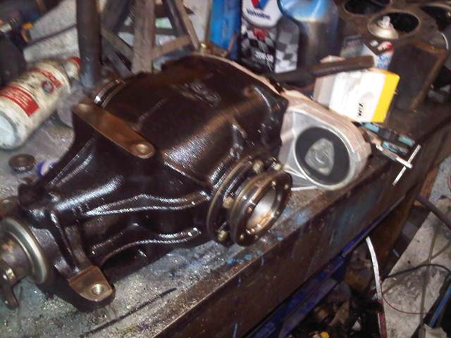

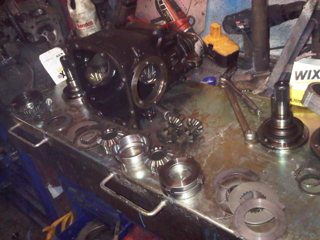

                            after the last brands meeting i had to make a couple of changes, first i dropped some softer springs in the front, secondly the diff needed attention, it got noisy last race, but then again i cobbled it together to last one race only, and it had now done a couple of meetings,
                            as ever a budget of nothing came into play, i had a couple of problems, first off i didnt have a really suitable cwp and secondly a hole diff, what ive been using is a mishmash of bits from several different diffs, so in reality i needed a whole diff a suitable cwp and a new lsd, ideally the lsd would be a gripper, but that was out the question as i also wanted a complete diff and new cwp, in the end i took a bit of a chance and bought a complete diff from a specialist, i was told it was low mileage and in really good nick plus it was a 4;1 ratio, which is really rare
                            your note how clean it was, plus it came with a solid bush in the rear cover which was a bonus
                            i stripped it and found it to be as good as new internally, so good infact that even the lsd plates were perfect, so i robbed a few plates out the old diff, and machined the end cover so i could get 4 sets of plates in it rather than the oe two and gave it 75lb preload
                            with the diff back in the car i headed to brands, i have to admit i was a bit nervous going out in it, having dropped front spring rates by 200lb and put in a lower ratio diff with a lot more preload than the one i took out, but no changes to the rear suspension i was a bit concerned i might of made the car really tail happy.
