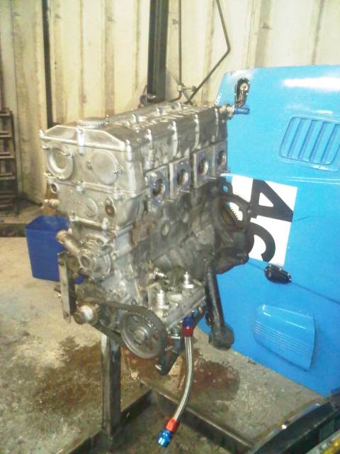

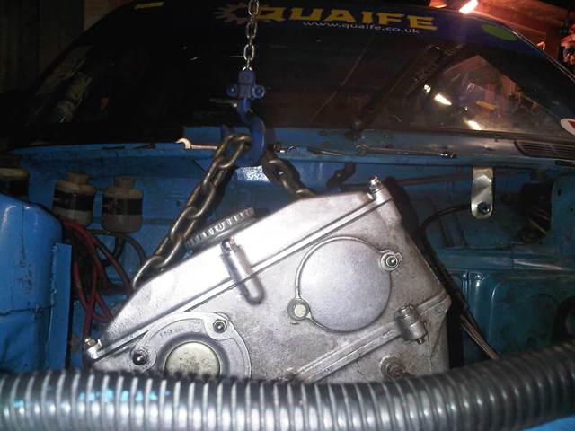

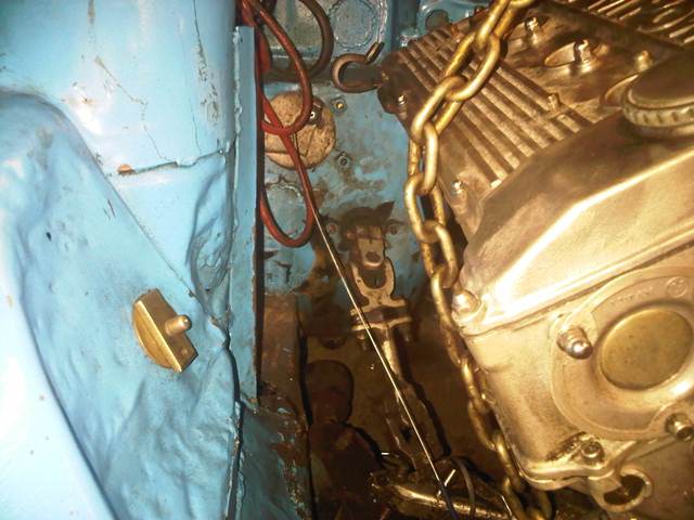

                            ok my seasons deffo over now, i've pulled the motor out
                            pics looking down the side of the engine are me eyeing it up with a view to getting a better exhaust manifold in there, im probably going to straighten the engine up a bit, not only wil that give me more room for the exhaust, but the dry sump should work better as its supposed to be fitted to a single seater with a more upright engine

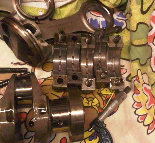

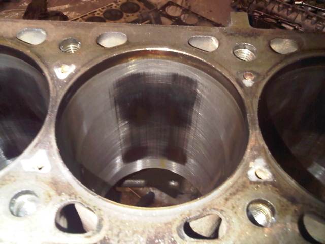

                            some interesting wear patterns on the bores, although thats only just polishing there isnt actually any wear as such

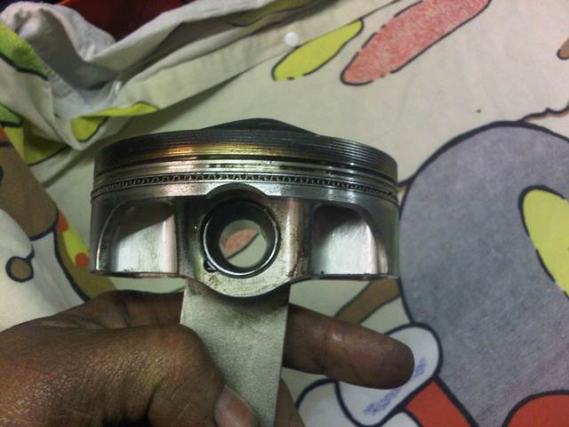

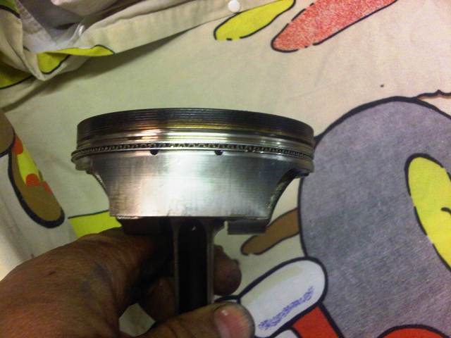

                            the ultra short skirt pistons slap around all over the place when the engines cold, no wear on them though piston to bore clearance is still 3.5 thou

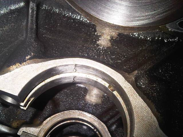

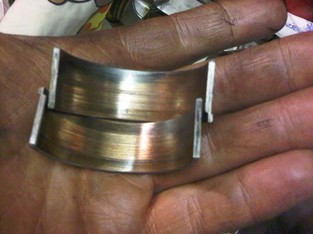

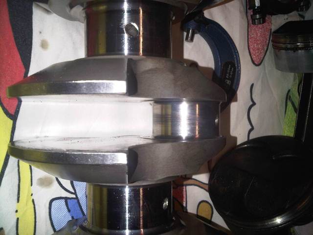

                            bearings were all ok except no3 big end, it looks like im wise not to do the last race, its been run low on oil a couple of times this year so im not suprised and i did end up doing a practise earlier this year with oil surge when the oil tank got down to a couple of litres so im not suprised
                            fortunatly the cranks still on size so just wants a polish, mind you its hard as nails being nitrided en40

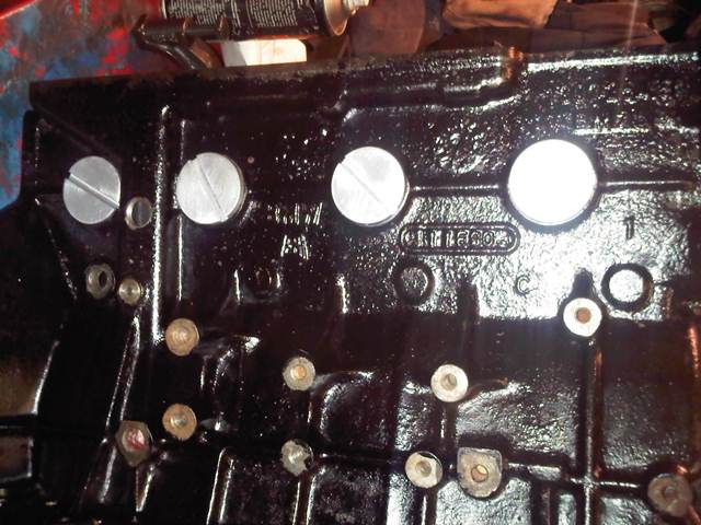

                            i bought another block, hoping it would make a better basis for a rebuild that teh current one, the current one has been heavily skimmed and i want to get some longer rods made so it made sense to have them made to suit a full height block, the block which is aledgidly ex dtm is on its last oversize but has had a lot of work done to it looked a really good deal until i got it home and discovered a crack through no2 main bearing housing

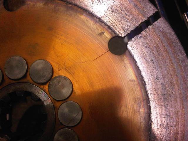

                            more expense required! both clutch plates are cracking up, mind you they are about 5 years old!

                              Its a good thing that crank and pistons are ok. How much longer rods can you get a way with? Never seen piston slap so clearly demonstrated.Those pistons are very cool looking though. Hopefully its more stabile when in propper temperature.
                                #1920
                                in the current skimmed block i could only use rods 2mm longer, with a fresh block 4mm is possible, if you haddnt guessed those pistons are supposed to be used with longer rods. 149mm long in fact, mine are only 144 long, though you have to take into account my crank has a 91mm stroke not an 87 as intended.
                                i think if a good block doesnt turn up soon i ill just hone the current one re ring and go with 2mm longer rods, otherwise its all getting very expensive as i will end up buy a block rods and pistons, you can still buy new blocks but 2k plus tax is a bit steep.
                                i warmed the piston crowns with a blow lamp for 20-30 seconds and the grew by 3-4 thou, you only ever heard it slap if you started from stone cold and drove straight away
