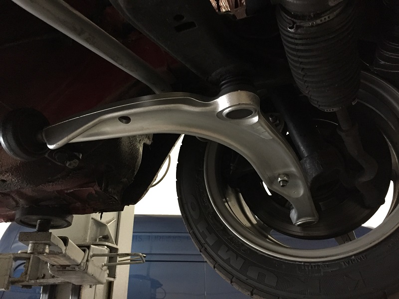

            its been a while since ive touched the car, but the racing season is coming, so had to pull my finger out, and get some upgrades happening.
            i didnt get a lot of seat time last year but its clear on the right day at the right circuit, the combination of me and the car have the pace to run well inside the top ten overall, which means ive been giving thought as to how to get on the podium.

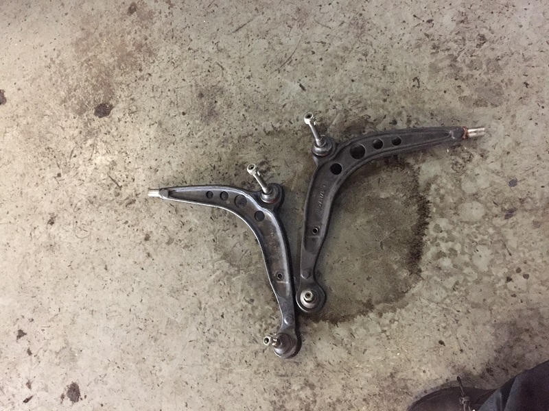

            i cant easily find more power, but i know from chasing Porsches and lotus sunbeams around various tracks what i need most is a car which will carry more speed in the tighter corners, which means taking weight out the car, and more importantly off the front. the trouble is most of my attempts to lighten the car whilst being successful are all taking weight off the back so doing nothing to help the car turn in better, and not something i can fix by just drilling a few more holes, so ive splashed a bit of cash. ive ordered a polycarbonate windscreen, and some alloy front arms.
            so these have been changed for, these....
            the alloy arms being half the weight of the steel ones

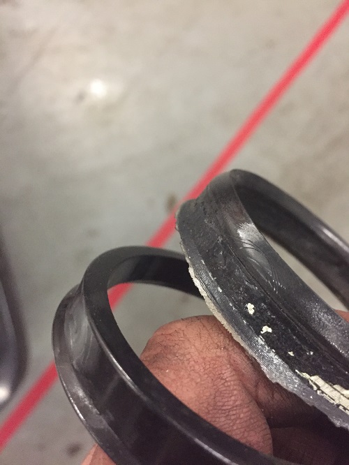

                i did another couple jobs, one was to change the plastic wheel spigots for alloy ones, as i keep melting the plastic ones, even when its wet

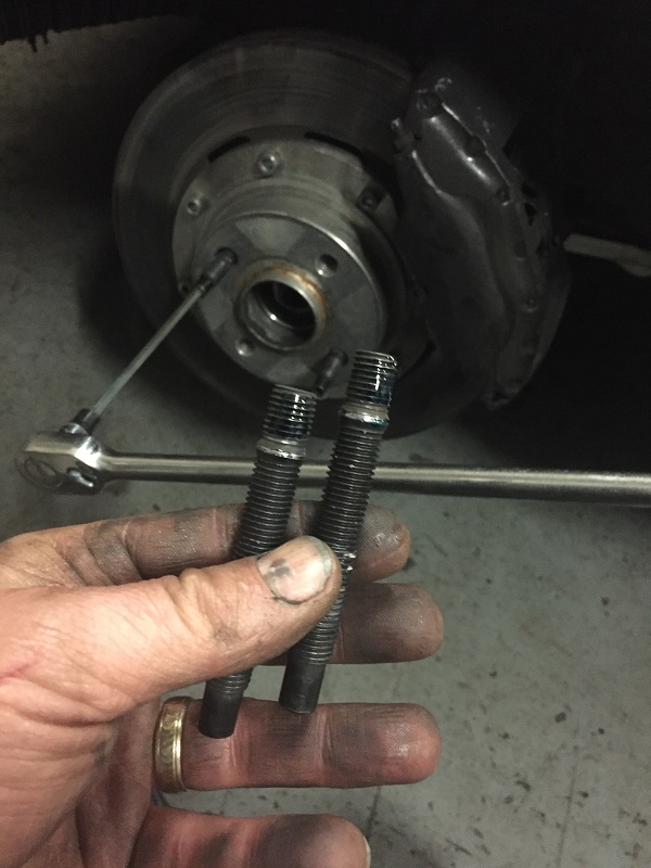

                also loctited the wheel studs in, they have a habit of unscrewing when the wheel nuts are undone, its not actually an issue they dont need to be tight in the hubs, i usually just twiddle them back in, but it did dawn on me that i often have pit crew who may not be switched on with regards to loose studs, and therefore possibility send me out on track in a car with studs barely screwed in

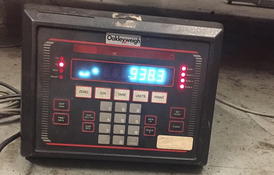

                its always slightly tricky working out what the changes have done weight wise, simply because always has a different fuel level, that 938 at the last weighin was with around 25 litres of fuel on board, so the car with a low fuel load is getting closer to my goal of 900kgs, not bad for a car with an iron straight six in it, and the only non steel body panel is a grp bonnet,

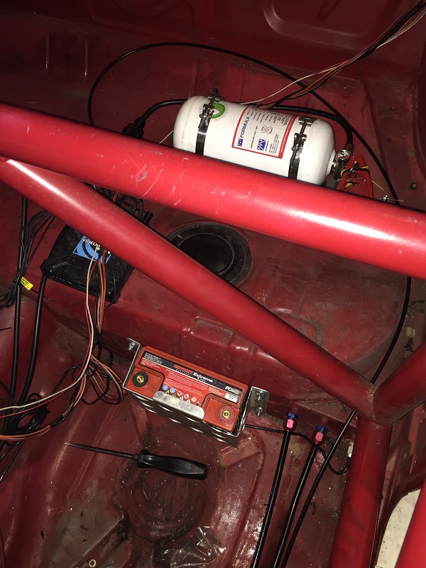

                          TBH its not that tail happy given that it has 220lbft and 285bhp the main reason im trying to shift weight rearwards is to try and stop it understeering going into tight corners
                          the latest effort, ive moved the both battery and fire extinguisher back about two foot each

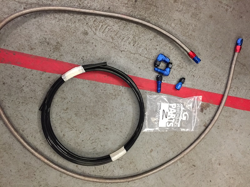

                          i also changed the fuel return pipe, the new one is slightly lighter but it wasnt for that reason, although the braided goodridge hose doesnt leak fuel it does leak fuel vapour, i heard numerous times they ooze vapour but never experienced it myself before.
                          a cabin stinking of fuel isnt an ideal way to start a race, and probably isnt helping with regards to me getting car sick!

                            Graham, is it just on entry that you're having trouble in the slow corners, or does it feel slow/like there is some push mid corner too? That shot of the new alloy arms seems to show a lot of caster on the front, which might not be helping in the slow stuff. Is there a way to temporarily back it off to test?
                            Also, now you've sorted out the rear, what kind of ride height front to back are you running (roughly)?
                            Lastly, are the dampers adjustable in any way? There could be a few setup tweaks to help in the low speed stuff. Even a little more toe-out may help. Ok, its not weight saving, but it may help!
                              #2129
                              ride height wise the car is now level, rather than arse end up like it was, corner weighing it shows its taken a bit of weight off the front which should help. geometry wise the alloy arms are exactly the same as steel, i had changed the front toe to give it some toe out, that has helped sharpen the steering but down nothing for low speed, lap time wise the car is considerably faster than it used to be, so it going in the right direction, slow speed turn in is its weakest point now, probably not helped by the stiffer front ARB, i plan to back off the front damping, what it probably wants is less rebound, but the shocks are single adjustable only, so will just have to try
