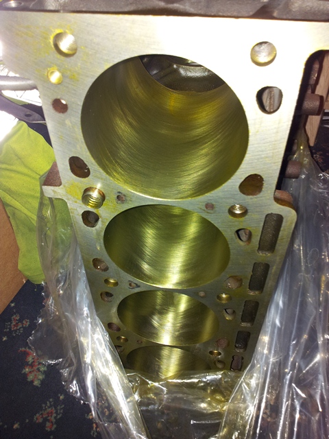

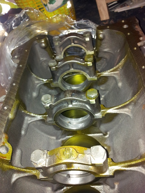

            a modicum of progress, robbing the main caps from another couple of blocks i came up with a "set" that had minimal miss match, and sent the block to ivor searls to have it line honed, as it honed ok they also bored it and gave the top face a light skim.
            so i now have the basis for the rebuild

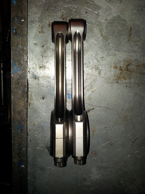

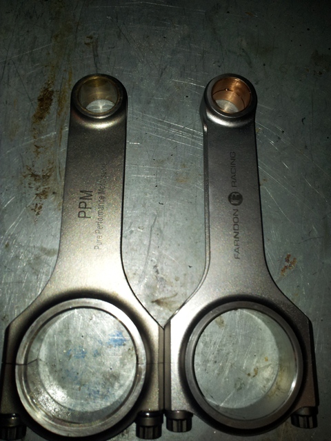

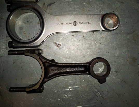

                        the new longer rods arrived last week, the fardon rods being 4mm longer, obviously they look pretty similar to my auzzy rods, the fardons ones only really differing by being thinner round the bigend, the beams are a bit narrower but also thicker, i think they are a bit lighter but the scales have packed up so cant tell. and the oil hole for the pin is in the top not bottom of the rod which to my eyes makes far more sense.
                        the old rod is a pinto one just to give a comparison as to how long these rods actually are

                              Nice looking rods, are they around 150mm? its going to be a really good engine, even better than before
                                • 25239
                                148mm, std s14 are 144mm
