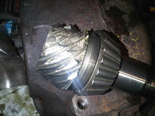

                      practise was uneventful for 8 laps, circulating in a fairly leisurely 56 sec staying out of trouble, bill passed me at some point and i decided to watch and follow, that plan didnt work as i suddenly found a noise from the rear, it varied with throttle load so clearly it was the diff, it sounded like it had run a bearing, pulling off i headed back to the paddock, jacking the back end up the only thing obviously a miss was the temp of the diff, with no excessive backlash it seemed worth attempting the race, not having a spare diff with me or time to change it even if i could borrow one, it was a case of risk it or just not start, i decided to risk it, not starting left no room for error if things went wrong on Sunday, starting and having it lock up at the wrong time could also be disastrous, in the end i choose to start the race, it didnt do me much good though, the car sounded ok driving to the collecting area, as soon as i pulled out onto the circuit it made really horrid noises, i figured i'd take the green flag and pull off if the noises stayed, as it happens when the flag dropped i let the clutch in to be greeted by noises that sounded like the prop had snapped off and was basing its way through the floor, so i dnf'd before the race actually started!
                      after lots of pondering back in the paddock, i remembered i had a 180,000 mile old non lsd small case 316 4.1 diff , the ratio would be ok (diff in the car was a 4.3) the lack of lsd would be a serious issue not to mention the a low mileage small case diff struggles to cope with less than half the power of my motor but would be better than nothing, i also had a spare 3.9 pinion in a case and a loose crownwheel cwp that woulld fit my lsd depending on how trashed it was, 3.9 is too long but again better than nothing,
                      back home that night ii ripped the diff out, actually apart from the missing pinion teeth and a chewed but still intact crown wheel everything was in ok shape, but i'd have to mix and match casing parts, so with a quick rebuild i fitted the 3.9, i say quick rebuild, it wasnt so quick, by now it was 10pm and i'd been up since 4am, with an equil mix of b373, kendle and millers lsd oil (i only had a dribble of each) the diff went back in and midnight the car was ready to race again.
