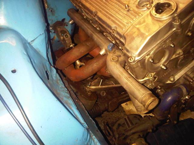

          a little
          exhaust manifold and water rail are on, doesnt sound much but i had to modifiy one of the secondary pipes and part of the system

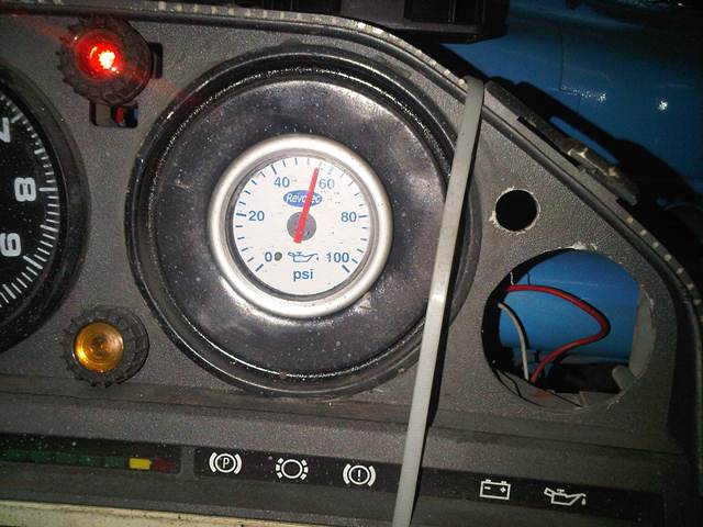

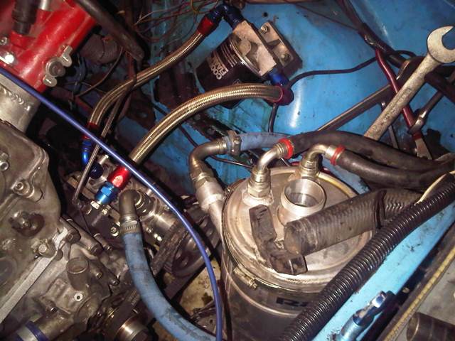

            a little more, oil tank and pipes in,
            connected battery hit starter button and a big fat nothing!
            ponder ponder, remember to fit engine earth strap and she cranked, some more cranking later and we have pressure
            55 psi on the starter not bad going, ok theres no plugs in it, but the battery was far from fully charged
