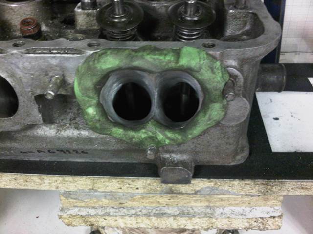

              nothing much to report, im now waiting to see if my ebay woosner pistons from greece will turn up and are indeed what they are supposed to be
              measnst while i nipped over to daves for a few hours and attacked one of my new heads, nothing too scientific about which one i chose i used the one which has already been heavily skimmmed in leu of my new pistons being a long way down the bores.
              even using daves electric die grinder it too me hours just to do one port because so much metal has to come out, it also went on and off the flow bench a couple of times to check results, no great suprises i got a best of 158cfm @10 inch, which puts it in the league of a very good xe or a std duratec (im told that ported correctly a duratec will actually do 170) with a bit of detailed seat work i might just scrape 160cfm from it
              so there we are one port down 3 to go, i did number 4 which was the one i broke through to the waterway on last time, interestingly beging a bit more agreessive with the porting on the base of the port fairly near the port face i got the flow without going quite so large on the overal port size. the nice thing is the cam i will use goes to 0.480 but by 0.400 the heads flowing 97% of its capability and after 0.480 theres no more flow to be had, obviously a higher lifting cam would still give more power because it would be at full lift longer, but as its £500 of ebay cams or 3K to put more radical cams in the decisions already made!
              edit, this time with the bench working as it should i flowed both ports together, the result? not a bit of difference whether one or both ports were flowed

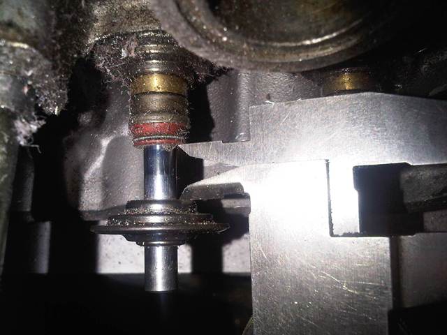

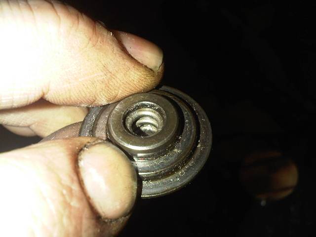

                        a quick meassure up this moring showed theres isnt quite enough clearance between the retainer and stem seal with the cam at full lift
                        fortunatly the cure will be quite simiple i shall just trim a bit off the bottom of the retainers seeing as the collets dont go right to the bottom of it

                          #1392
                          Would it be possible to cut the groove a bit higher up the stem ? Even if it doesn't suit you , I'm curious as to whether this can be done .

                              #1394
                              it could be done but would be tricky to get it in just the right place, get it slightly wrong and something wil break, much simpler and safer to just nibble a bit off the bottom of the retainer

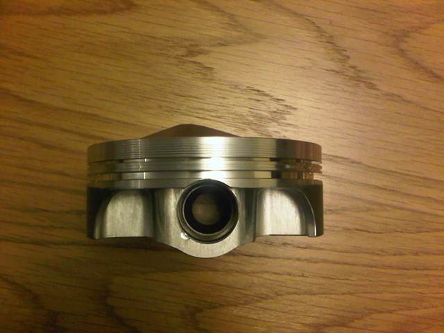

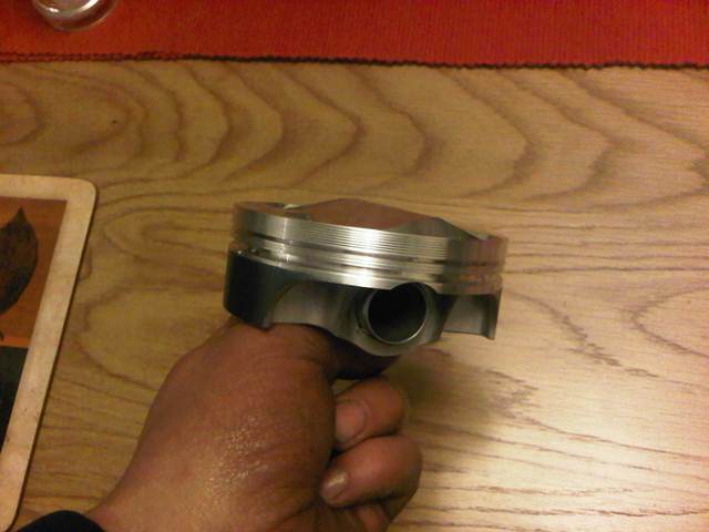

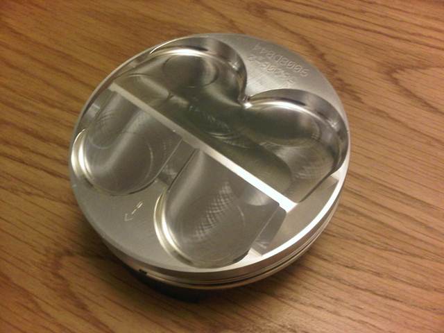

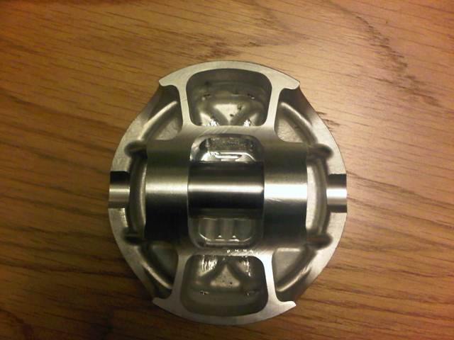

                                pistons turned up today shame the rings were missing!
                                as you can see thet have an extremely low compression hieght, no skirt to speak of and are very sexy bits of kit, not sure how well i will get on with them only having a single compression ring cos it wont rev hard enough to really only want 1 ring, but we will see, they are certainly very very light
