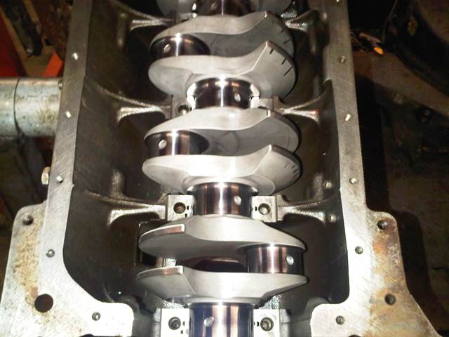

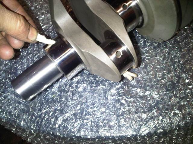

                anyway here we have a nice new crank, and im using my usual pipe cleaner method of making sure the oil ways are clear of crap which they werent!
                in the block at last

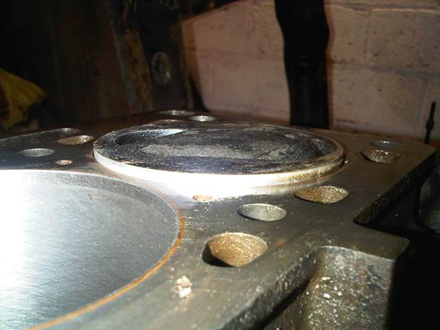

                finally for now i dropped in a rod with one of last years pistons ( same piston just different cut outs) in to check the crank/rod asembly would actually rotate in the block, which it does with very little room to spare, as you can see i have some serious piston protrusion going on here, its not as dire as it looks as the head gasket is 73 thou thick and i have a 42 thou/ 2mm decomp plate so i currently have about 0.75mm sqwish, although its rather unusal to run the piston so far up into the head gasket it pokes right through and out the other side!

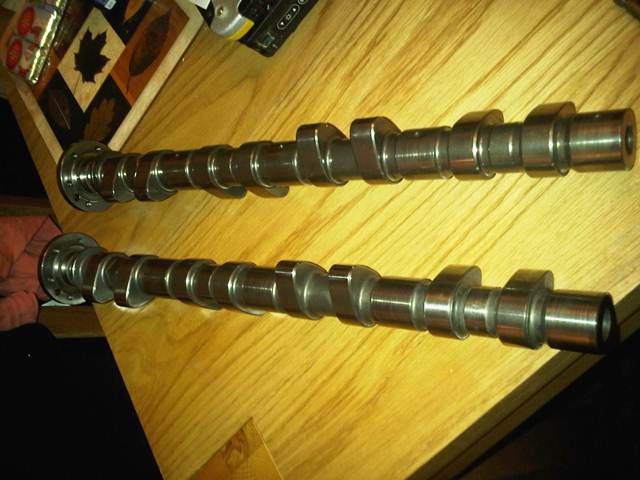

                  cams turned up today
                  they are minter than mint, and although a lot of money at £500 there cheap as they are about £600 plus vat each my other alternative would be spend £300 odd on getting cams reprofiled which would be a compromise especially on the valve lift front
                  that was the good bit, the bad bit is ive spent most of the day trying to machine pistons to work with these cams, its really rather a non starter, so im well hacked off because buying pistons wil probably put me out the running for any racing in the first half of the season.
                  woosener do a very nice piston 12.8:1 cr with an extra low comp height to suit 149mm rods (s14 are normally 144 like mine) if i use a set of these i can bin the decomplate and the piston will be 2mm down the bore, using a thin ferriday headgasket i can grab back the compression lost by the piston being down the bore, engineering wise its a much better soultion and will even allow me to play with the cam timing.
