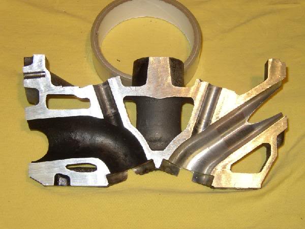

        M42 use 35mm buckets (and there are shim under options - I have Eurospec buckets for my M42). Supertech have buckets for S14s (link).

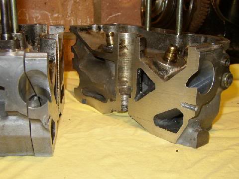

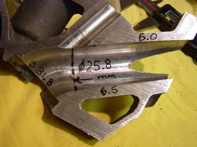

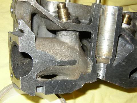

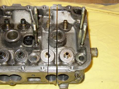

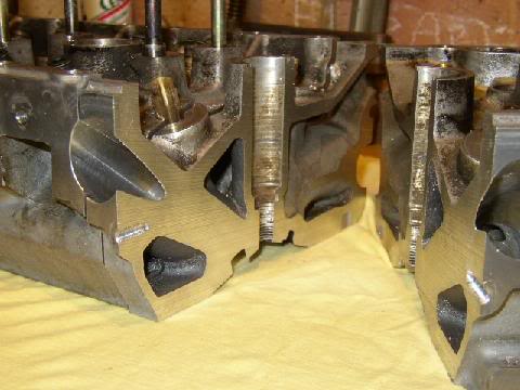

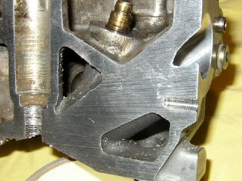

        Also Graham have you seen pics of the chopped up S14 head on S14power.com (UweM3)? These could be useful.

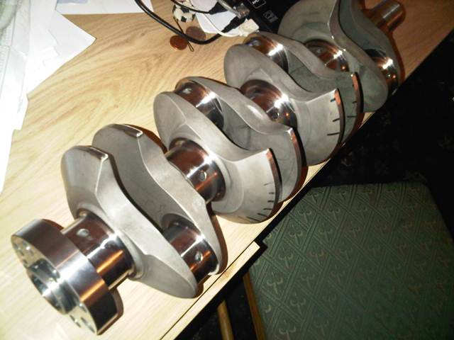

                What exactly is that Crank Graham? apart from looking fab?
                  • 25249
                  custom made EN40B steel billet from fardon, 91mm stroke will give 2580cc with a 95mm bore

                    and how long did that take farndon?

                      Niiiiice, man that's going to be a sweet engine!
                      • RWD fords rule
                        • 3579
                        Great to hear you have gathered some of the most important parts, the cams will surely add a lot more power potential, can't wait to hear this monster when its finnished

                          so what was the plan? 11,000 rpm?
                            • 25249
                            not with a monster 91mm stroke! the auzzy steel rods are recond to be safe to 10k, but they didnt envisage my crank! or a near std top end!
                            the cams probably give me 280+bhp potential, as long as a lash up of exhaust and inlet manifolding dont rob me too much power

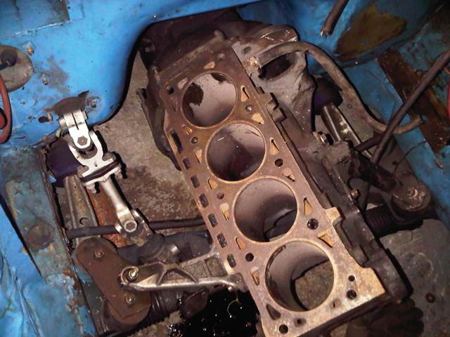

                              ok finally got something done on the car itself today, i bolted a scrap 1.8 block in so i could get on with sorting the exhaust manifold

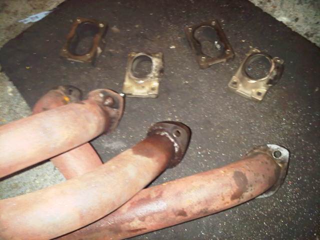

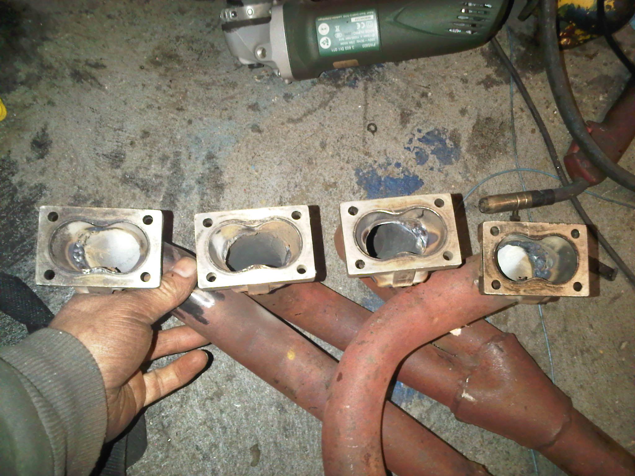

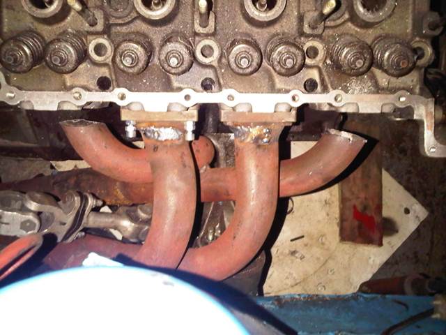

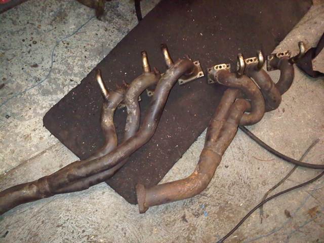

                              i recently aquired some m5 exhaust manifolds with a possible view to using 2/3 of them to make a manifold, 2 or 3 of the branches would of gone quite easily, it would of been very difficult to connect the 4th cylinder to make a 4 into 1 and nigh on impossible to build a 421, so i opted to cut the flanges off and weld them to my existing ashley pinto/bmw m10 manifold
                              so far only got the middle branches done strangely it was harder doing this than turning the pinto manifold into a bmw one in the first place
                                • 25249
                                ex manifolds now sporting s14 flanges just got to do a little work cleaning the internal joins up, poor things had a hard life, it was secondhand and beaten up when i got it having previously lived on a rally car
