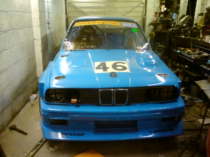

    Considering how much time you've had to prepare the car I think it looks pretty good.
    I think you've gone the right way with the brakes, now that you're N/A you can brake later and harder than the turbo boys and these should provide plenty of bite

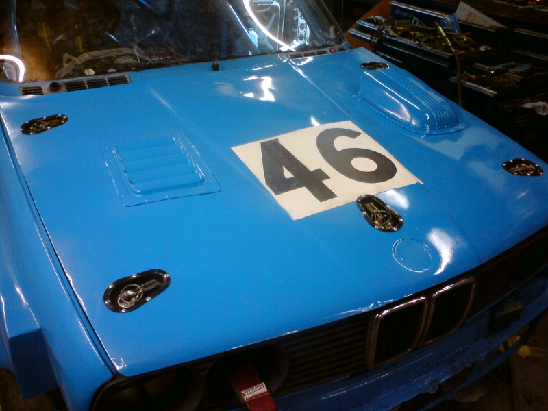

        more progress to day, although it seems to of been two steps forward one back all day,
        finsihed re fitting the bonnet catches, they now sit in some nicely recessed alloy housings, which were fairly cheap from rally design, bonnet now sits much lower than before

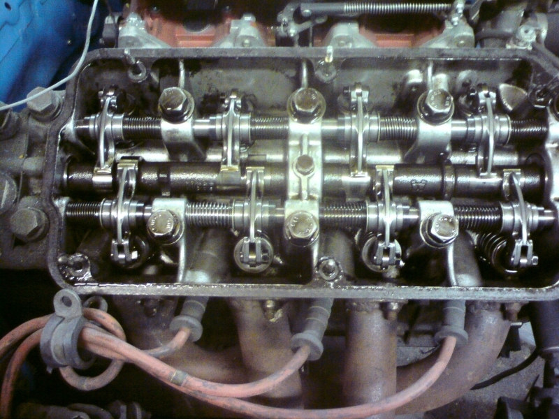

        i whipped the rocker cover off and checked the tappets, 1 exhaust was a bit tight, and put a torque wrench on the head bolts, the middle two tightened slightly, not bad after its been on track over 20 times since i last checked, so i rewarded it with an oil change.
        looking tidy- just dont look closely

                the rear mirror view , seeing the arches sticking out , is going to terrify anyone you're just about to pass/lap!
                • team_zi
                  • 1637
                  #1058
                  Re: A race bmw 316, 240bhp Atmo M10
                  Proper BTCC stylee now Graham.
