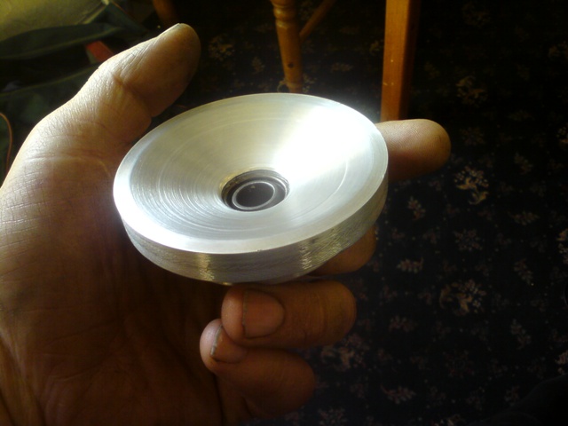

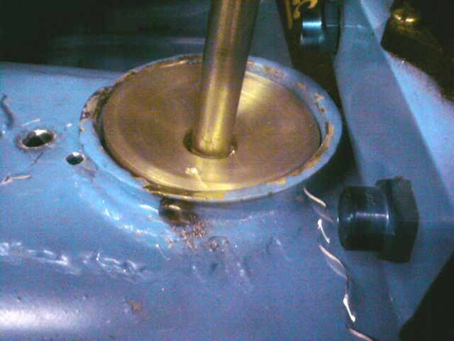

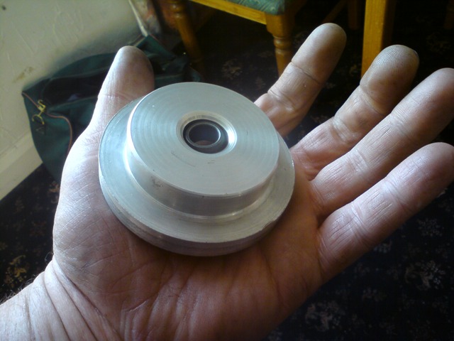

            after a trip to the local tractor spares shop for a sherical bearing, i grabbed a few bit of time with the lathe and turned up a mini top mount,
            hopefully thats the end of my gear lever woo's as the levers now supported by the body work rather than by arose joint on the end of a rod attached to both the body and gearbox

                after a trip to the local tractor spares shop for a sherical bearing, ... <snip> ... hopefully thats the end of my gear lever woo's as the levers now supported by the body work rather than by arose joint on the end of a rod attached to both the body and gearbox
                Graham, I have been lurking here for some time admiring your tenacity and ingenuity. This is a interesting solution to the shifter mounting. I know with some of the body mounted shifters with standard engine and gearbox mounts, there is a risk of missed shifts. I cannot recall what engine and gearbox mounts you are using.
                A question, how do you locate the shifter in the spherical bearing to stop it moving up and down?
                  #953
                  the engine mounts are heavy duty RS2000 and gearbox mounts are bmw 635, so its all pretty ridgid, the bearing is located with step at the bottom and on top a wire circlip from an old piston,
