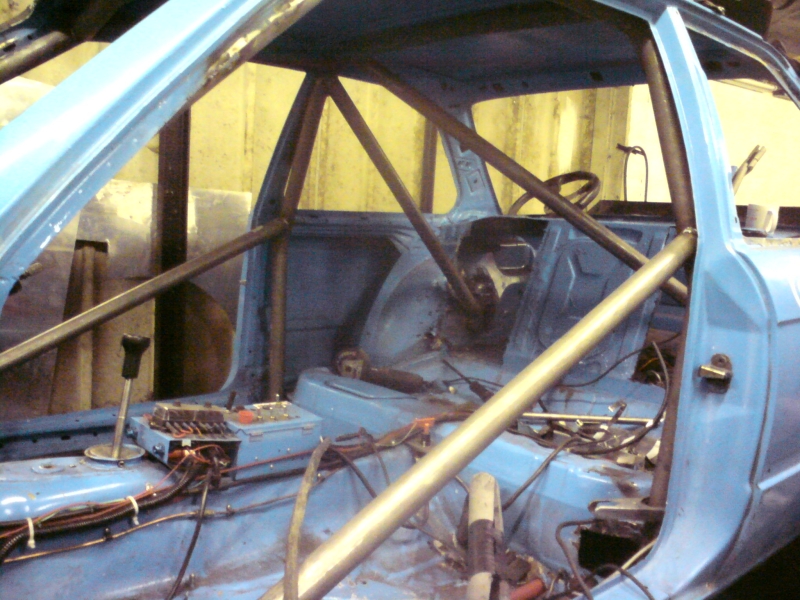

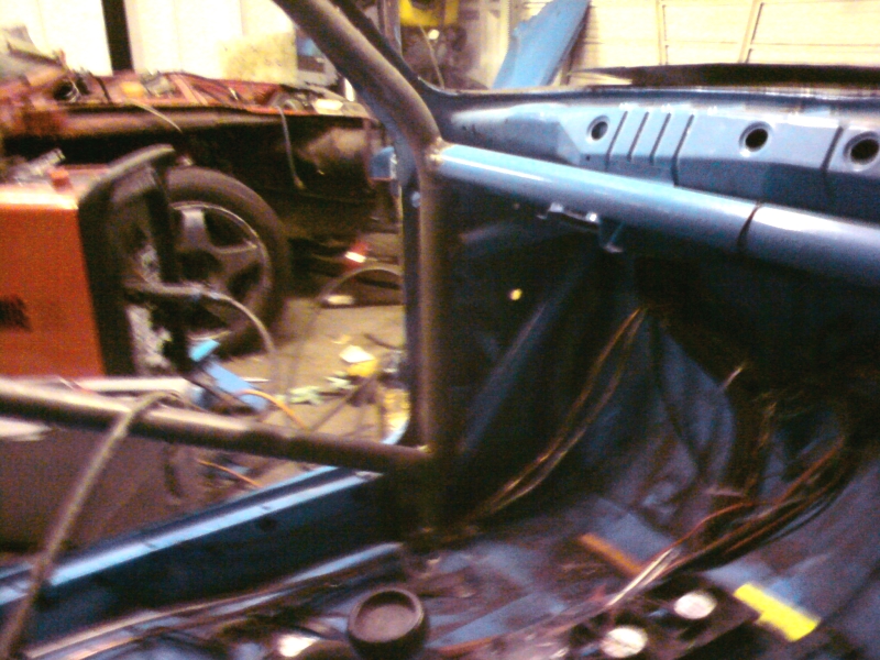

                        anyway back to the thread, after more grinding etc i was ready to start the cage reinstall, as per usuall with a cage from custom cages ist doesnt fit! and i've had to trim some of teh tubes, but eventually i got the main hoop, front legs and screen bar all in postition and tacked then together, a task nearly impossible single handed, luckily i had just bought a portapower and by using teh door bars a temporay wedges mainaged it,
                        once done the cage is dropped through teh floor to fully weld the joints

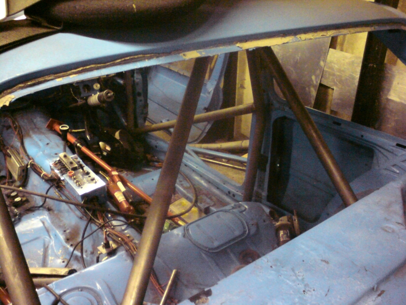

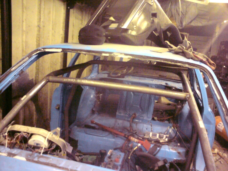

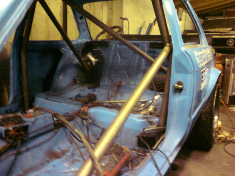

                          sorry about the crap pics my phone cameras now full of iron filings from grinding.
                          a bit more progress, i jacked the cage back in and fitted the back stays and diagonal, the diagonal was a complete arse t fit, being both the wrong length and having the notiches in the tube cut to the wrong angle, lots of work with an angle grinder fixed it
                          in the second pic you can just make out the remants or the origonal cage consisting of the dash bar and front stut mounts, still got the drivers door bar to fit and rebuild the floor under the cage feet,

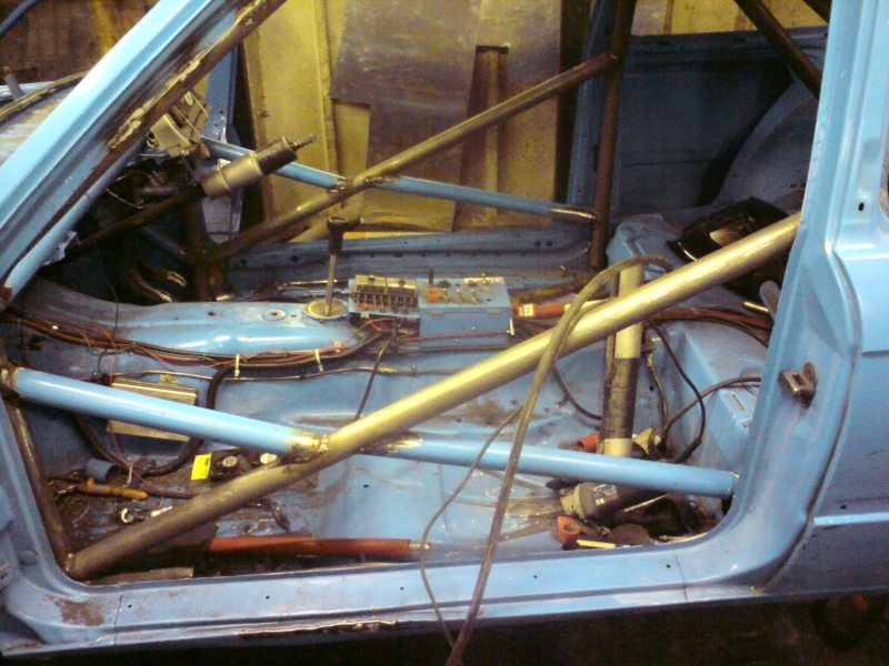

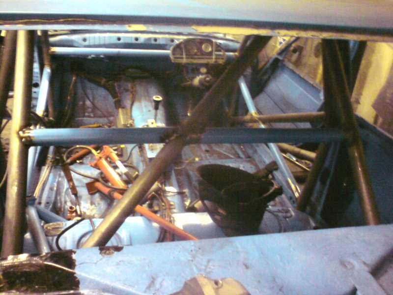

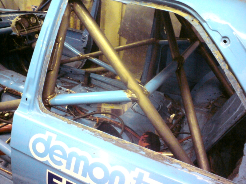

                            ok not yet repaired the fllor under the main hoop or front feet but the cage is otherwise fully in and welded
                            but it looked oh so little, i ended up putting the X's back in the door bars, they dont add a huge amount more side protection but must help as was as making the whole affair more rigid
                            not sure pre painted weld in cage bars will ever catch on though
                            and as you might see i've pulled out the worst of the dent in the n/s sill from where john cross took a bite out of it

                              the rest of you wont know but gary and i have been having an on going disgussion regarding roll cages,
                              i want less cage to save weight, gary says more cage adds performance with rigidity, the truth is were both right, assuming the shell wil benifit from great rigidity then yes more cage should give better performance in corners, the down side is weight, in an overweight car which is practically on its ceiling as far as weightloss and power gains go then more cage will hurt performance.
                              i was going to stop with the basic cage, well aware of torional rigidity gains from xing the door bars i did that, then the plan was to stop! gary wasnt keen, feeling that i should at the very least turn the main diagonal into an x as that will brace it and stop it bending, luikewise i should also pick up on teh main hoop where the door bars attach and run tube back to teh turrets,
                              with a bit of thought i realised it would be lighter to add a belt bar to the cage than reinforce the bulkhead and run snap hooks etc, a bit more thought i realised the belt bar would triangluate the diagonal to the back stay, a good move, and so ended up adding a passenger belt bar also!
                              standing back i realised with two very short lengths of tube i could brace the main hoop to the diagonals and so added yet more tube! but thats it i stop now!
