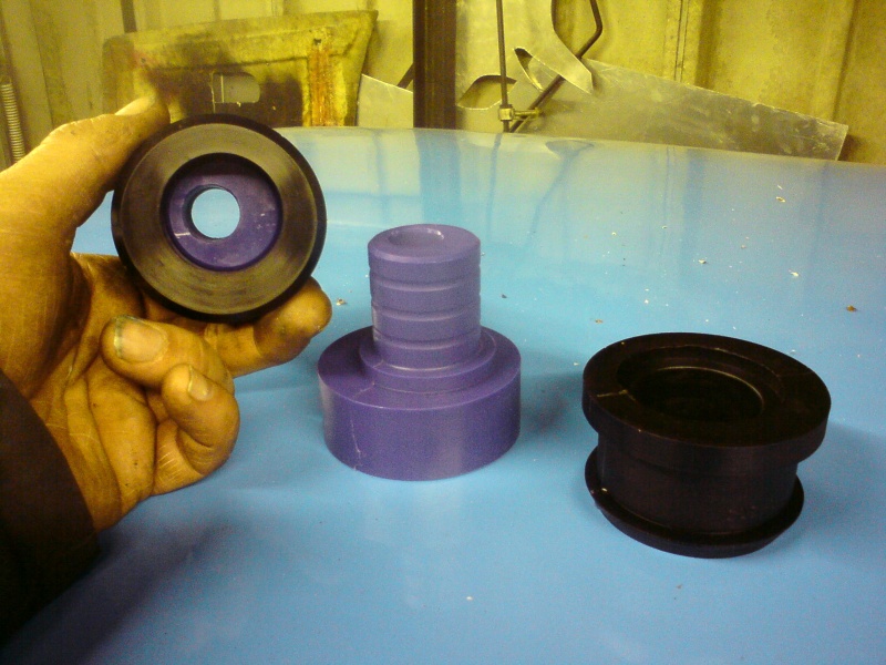

      ok i've actually done something now, i've bought and fitted some eccentric wishbone bushes, these give several degrees more caster and have allowed me to reposition the top mounts to take some camber out, bringing teh camber back from 2.5 degress to 1.75 which should suit my wide tyres and very stiff springs better.

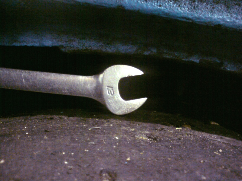

      i also took out the spacers that sat between the inner wings and top mounts which has dropped the ride height by another 10mm, ive been gradually dropping the ride height, but am very limited as to how low i can go as the underside of the inner wings sit VERY close to the tyres i dont think i can go much lower theres only just over an inch of clearance, check out the pic with the spanner to give some scale

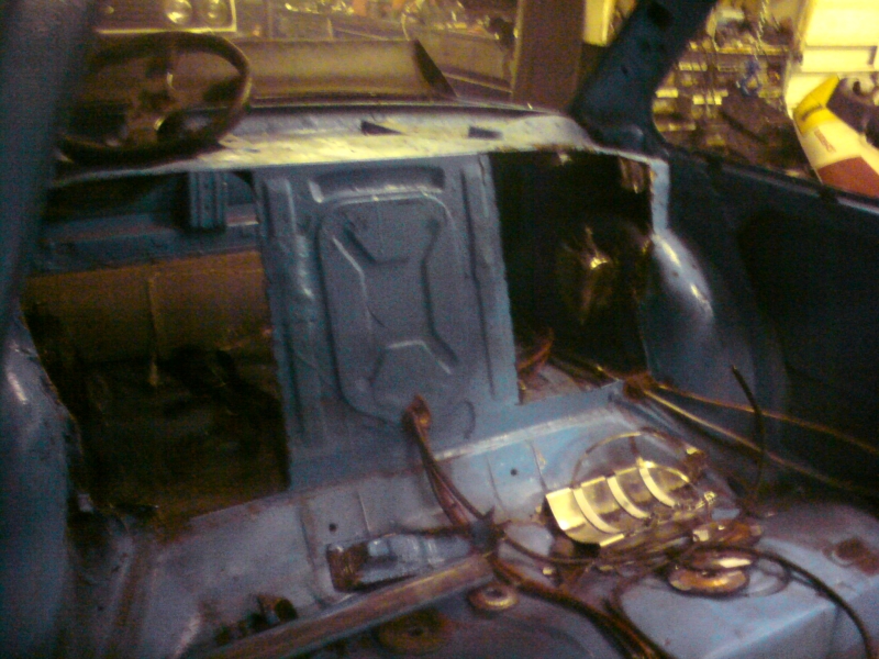

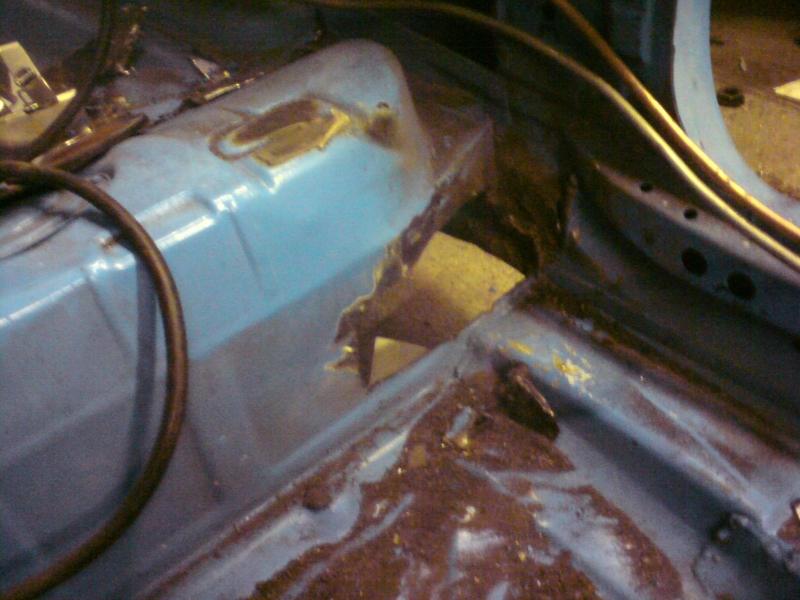

      unable to find a good shell at the right price i've removed the old cage leaving only the extensions that pick up on the front struts, when the origonal cage went in it was a right nightmare, it didnt fit and due to the way the reinforcing plates that go under the main hoop were designed it was impossible to weld all the way round the tubes in the roof with cutting holes in the roof and its supporting framework, now as teh new cage is basically a simplified version of the old one from the same manufacturer i will have the same problem, so i've decided to redesign the feet and have totally cut out the old cage mounting feet, leaving big enough holes that the cage will drop right through teh floor so i can weld the top of the cage properly then jack it into place and put the feet back in.
      fitting the cage also requires holes cutting in the panel between the rear seat and boot, last time i made the smallest possible incission, which made life very difficult, this time i've cut huge holes, as when putting it back together it doesnt make much difference whether i weld back in large or small plates

        Nice bushes. Are they universal or specific to E30s. I could do with something like that on the sierra.
          #979
          E30 specific dave, they are the rear ones for the bottom arms which are basically "L" shaped

            Looks like you have your work cut out for you. But then again loosing weight is always hard work.
            I see you're running full slick tyres. So I guess you can find grip with the rear suspension set very stiff. On a semi slick tyre like mine that rear wheel travel would not be adequete.
            Have you tried it this low
              #981
              thats a front tyre, the front has 700lb spring is vertually solid even with the massive grip from 245 slicks, ive run it 10mm higher than that, so we will find out later!
