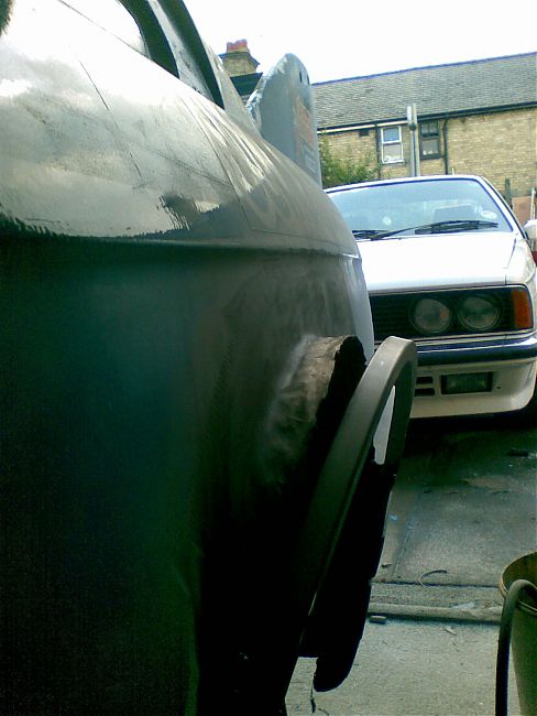

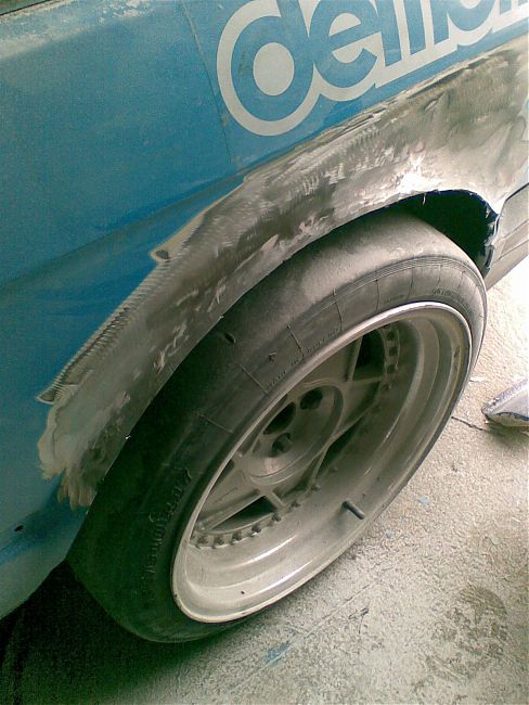

                  my AA shifts have kept me out of the garage, but i've dne a bit on the car, i've started to modify the rear arches to cover the 10x18 wheels im going to run next year

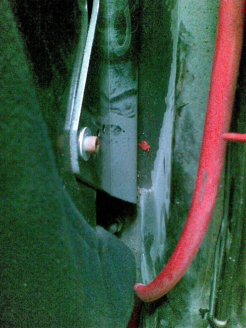

                    • 25239
                    i havnt yet got the bigger wheels or tyres, partly because i dont havnt ordered them as i dont want to buy new slicks then have them sitting around for 9 months, so the arches will probably end up bigger than they need be to make sure i have clearance

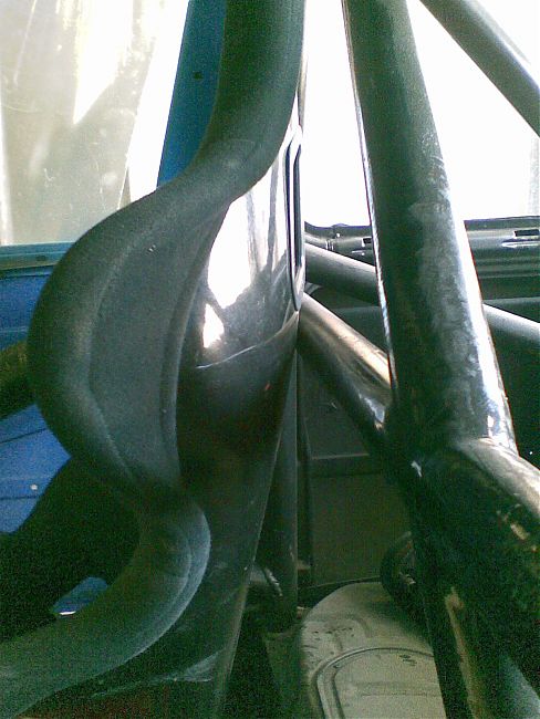

                      • 25239

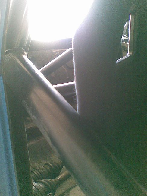

                      looking in my car from the passenger side the other day i wondered why i hadnt mounted my seat further back, looking at the seat from the other side i soon realised, its hard against the door bars and wont go further down or back, and the mounting brackets wouldnt allow me to move it over.

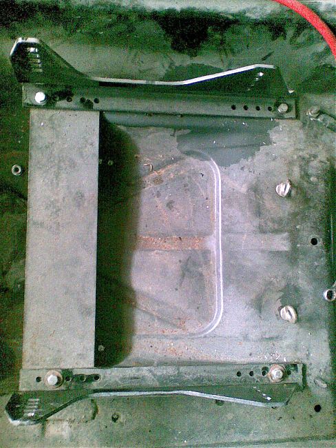

                        • 25239

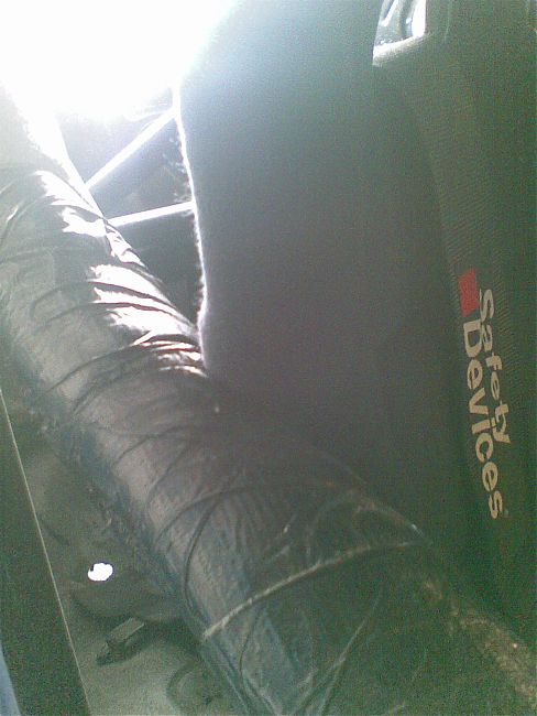

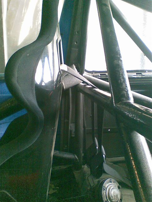

                        i then realise if i reversed the mounts i could move the seat over and back, it also allowed me to to alter the additional support welded to the floor to support the rear of the seat and i saved over half a kilo in weight
                        the seat is now several inches furher back and about 1.5 lower.
                        incase your wondering why all the effort to move the seat back, its because most of the weight saving meassures i have in mind will take weight of the part of teh car where i really want it at the back, so anything i can do to try and shift weight rearwards is a good thing

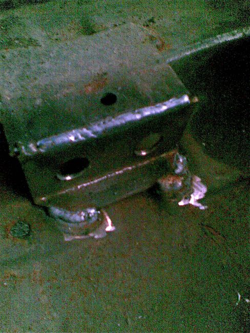

                          • 25239
                          heres the new light weight floor mount for the back of the seat

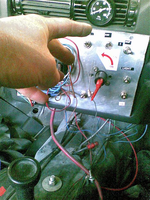

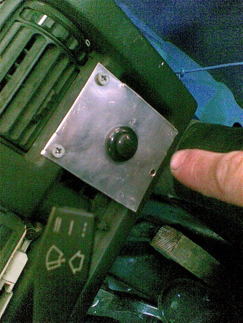

                            all this seat movement has caused another problem though,

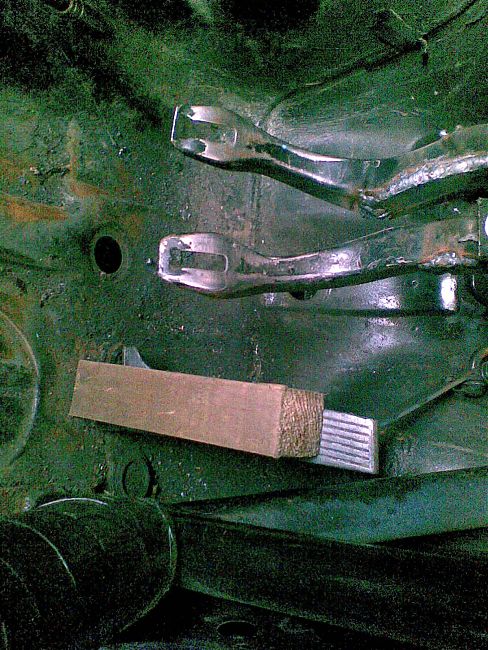

                            i now cannot reach ANY of the driving controls everything is too far away, so all teh switch gear will need relocating, the steering wheel needs to come down and back which i will attend to at the same time i move the steering rack back later on, the gear lever is too far way but that should come into reach when the engine and box get moved back, finally the pedals (mk2 escort bias box), which werent actually quite right anyway in this car as they were altered to suit the bmw 2002 with its sloping bulkhead, this car has a vertical bulkhead, so i will just reverse an earlier mod, with involves cutting and bending the pedals and rewelding them.
                            i thought long and hard about the throttle pedal, and realised a simple wedge shaped extension would by far be simplest and best

                              i've already altered the pedals, which has proved as i thought the angle/length of them wasnt right in the first place as i'm now pushing them with a different part of my foot which means i now have more leverage and it shows as the clutch needs a fair bit less effort to depress
