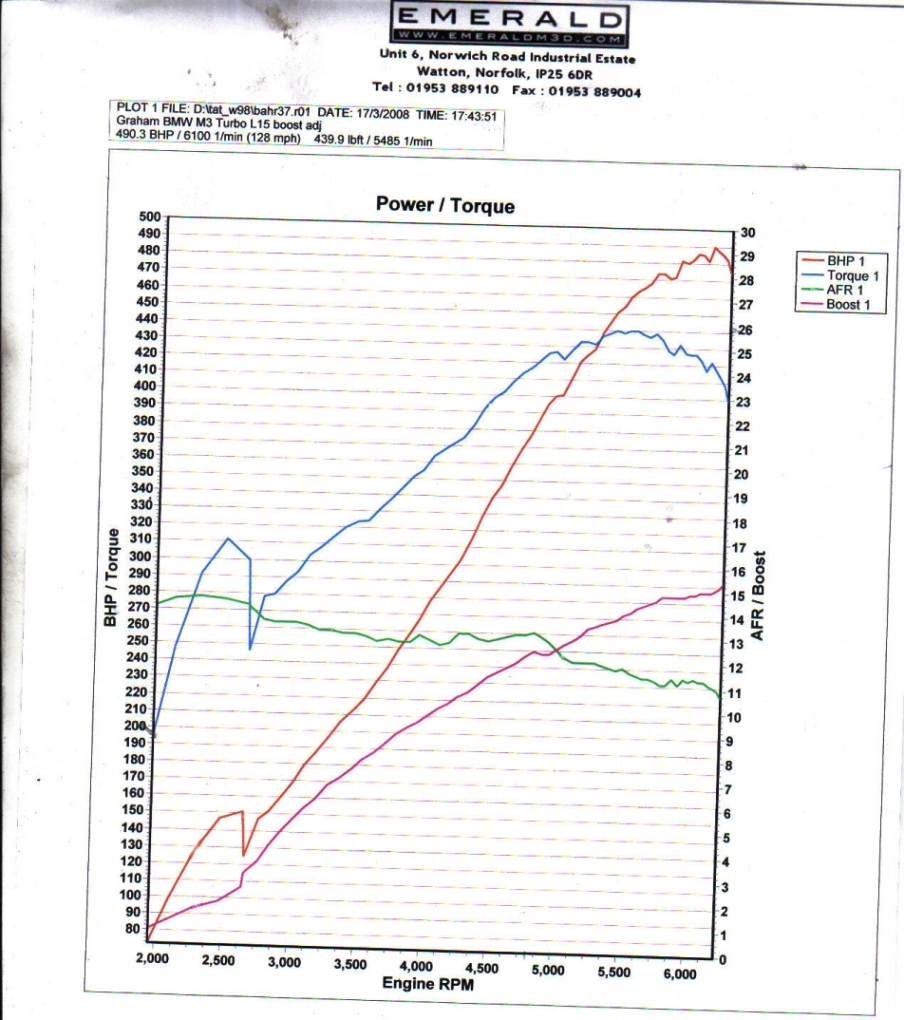

    thats one hell of a lot of rpm from an engine which is internally still almost a std production engine, let alone one with a 94mm bore and 87 mm stroke.
    after a few issues with fuel pumps playing up and the rail starting to leak we got on with it, it became obvious the engine isnt in the same healthly condition as when i first built it, but its still pretty strong, its made
    490bhp 440lbft torque
      #422
      actually i lie it made 439.9lbft!
      we still only used 15.5lb of boost, the boost could of probably gone higher, but we maxed out the injectors and didnt fancy trying to crank the fuel pressure up any more as its already 75psi on boost
        #423
        ignore the bump at the lower end of the graph, that was dave changing gear!

          impressive as always graham
          15.5lb of boost is low for that much power
            #425
            That's only 299lbft more than mine

                nice one graham, impressive stuff

                  And thats in "unhealthy" condition?
                  Thats very impressive, well done. Most importantly - are you happy with it? Sounds like there's more to come too if you can play with injectors and things.

                      Well done Graham, good solid figures there and very useable power
                      Hope you get ready in time for the weekend and get a good run, even though Andy is on the reserves it'd still be a shame if he made it in at your expense. Good luck
                            yes it is actually, if you do a cylinder leakage test a couple of inlet valves are leaking a fair amount of air back into the plenum, and i've got an exhaust valve thats not exactly air tight.
                            i've no plans to take it to bits before the seasons end, although seeing the tell tail showing i'd revved it to 9957rpm seconds before running it up worried the crap out of me
                              #434
                              thanks for the kind words
                              yes im more than happy considering its condition, in perfect nick i would of thought we could of got more like 525-550, we could probably of squeeked a couple of brake more out of it with a tad more boost because the injectors arent quite flat out, but its not really worth trying, as im never going to feel the difference a few more bhp would make, afterall another 25bhp would only be 5% more power
                              so its staying as it is.
                              anyway with the exception of the twin plate sintered clutch the whole of the transmission is bog std BMW, so whilst i could go hunting for more power, what are the chances of not breaking everything?
                              the gear box is an M3 one which bmw nicked out of the M5 is said to be good for 400lbft, so in theory im already well into gearbox breaking territory.
                              engine wise if i did want even more grunt, what i really need to do is put it one 8 injectors so i can get even more fuel in it and put some cams in it to make it rev more, i've no doubt that it could make 600bhp if i had the money or that balls to try, not only that the DMN rules mean if i did go 8 injector the car would become a class A and im happy in B,
                              IF i were to win the class by a country mile i or beat Rod birley in a fair and square fight then i would run in class A next year
