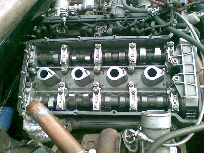

              cheers gary,
              done a quick valve clearance check this morning, inlet clearances are ok, exhausts are all huge, so it looks like 8 bent exhaust valves, which makes sense, your more likely to bent the exhaust valves on an over rev
              i dunno if the fact its the exhaust valves is a good or bad thing, the inlets are std bmw and thus reasonably easy to obtain even if horribily expensive new or even s/h, the exhaust ones are oversize race valves, made in small batches especially for my supplier who doesnt think he has any more, which could mean a very very long wait for more.
              i havnt got one but i suppose one way out of it could be to put a std head back on the engine, anyone got an m3 head they are willing to donate to a good cause?
