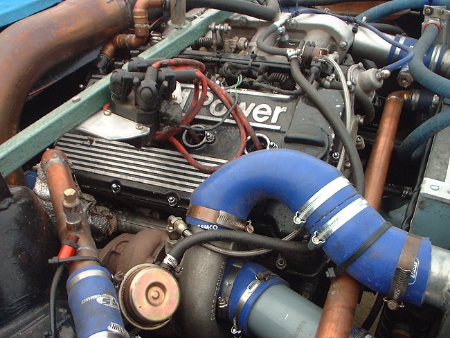

                      i've repaired the arches and changed the bent rim, fitted a new spoiler, and faired in the rad and intercooler as i noticed the engine ran cooler without the spoiler.
                      also got a rolling road session booked may 1st to try and ring a few more gee gee's out of the motor

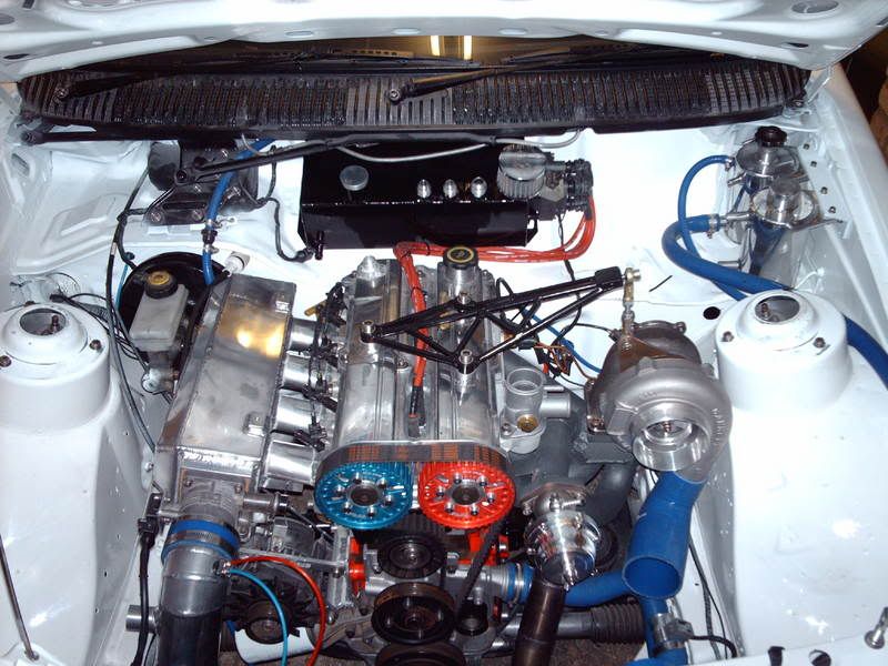

                              just realised i havnt posted any pics of the completed 2007 instalation

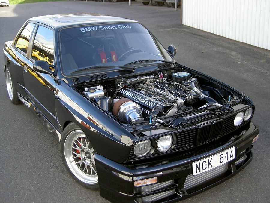

                                Graham,
                                Here is a picture of the install in martins car.
                                As you can see the turbo was mounted up high and this is prob where it will be in the new car. As the car was a left hooker we could run the turbo straight down by the chassis rail.

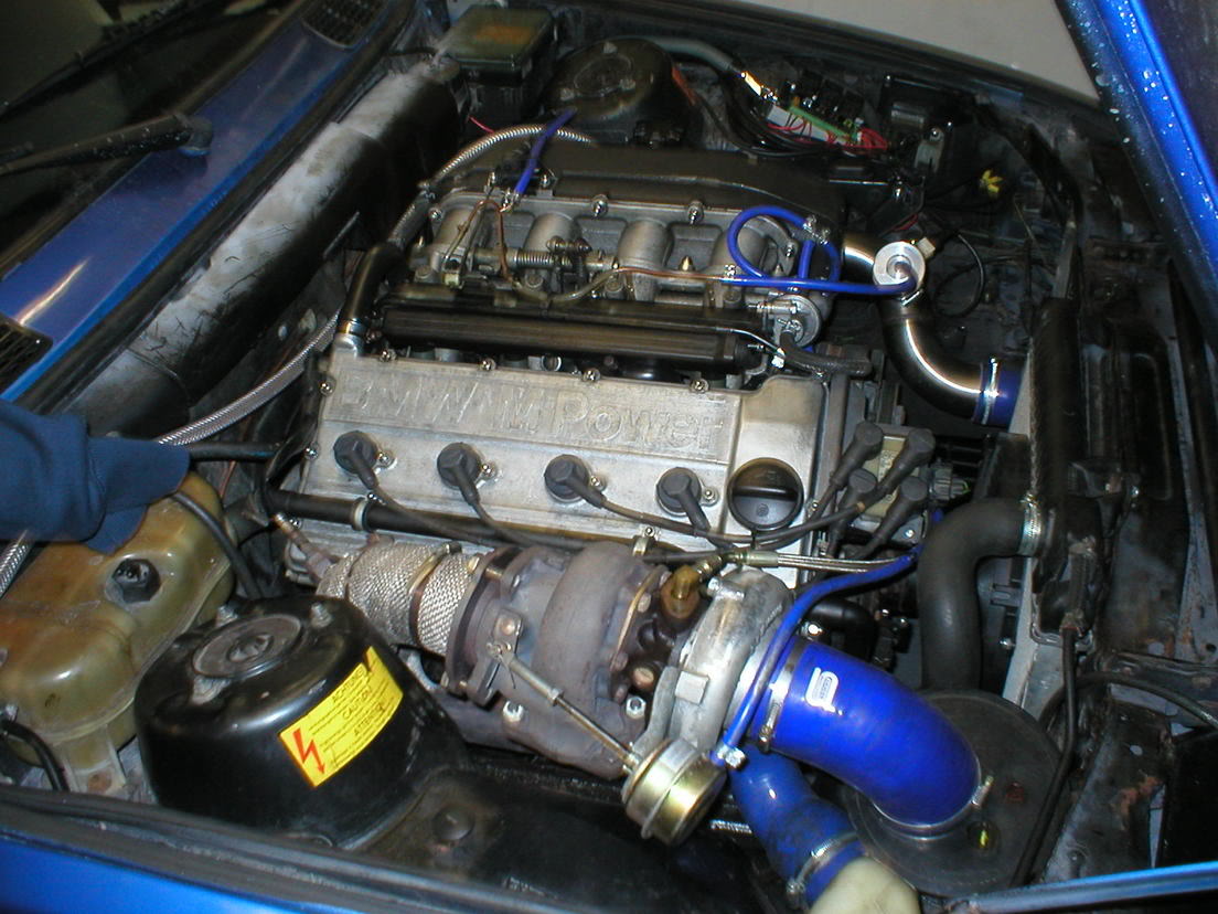

                                Here is a picture of the sort of turbo support i have run on alot of cars with good sucess.
