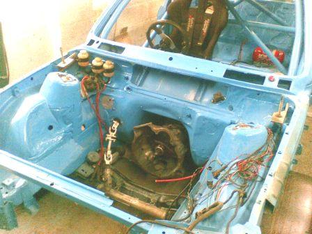

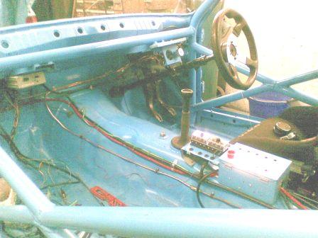

          finally it feels like somethings happening

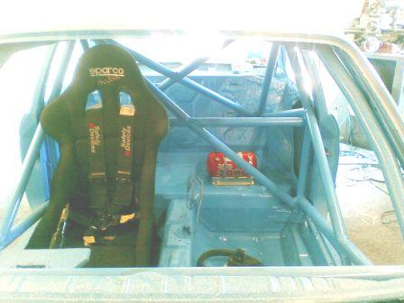

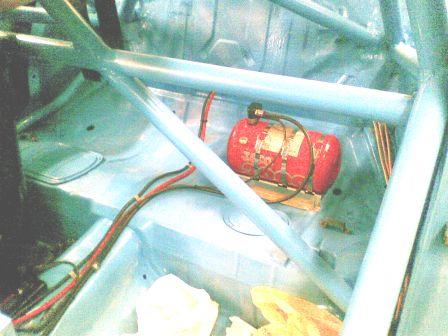

          got my seat, belts and fire extinguisher in on sunday
          been more busy since, wired and plumbed the fire extingusher, and the hard fuel lines, you can just see the 3 of them bottom right of picture, 2 feeds 1 return
          plumbed and bleed the brakes
          started on the wiring
          gearbox and prop on and clutch hydralics bleed

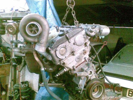

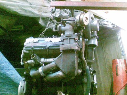

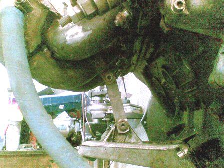

              ever since i bolted exhaust manifold complete with turbo, adaptor etc the weight of the whole thing has worried me, despite my damper/support mount, the it dawned on me that the majority of the manifolds expanion will take place at the hottest bit closest to the turbo so that if i supported the manifold close to the head i would hopefilly be ok, so here goes nothing and using some spare ashley exhaust clamps ( see ashley stuff does fit sometimes lol) i've used the coolant rail to support the manifold
              then added a support under the manifold,

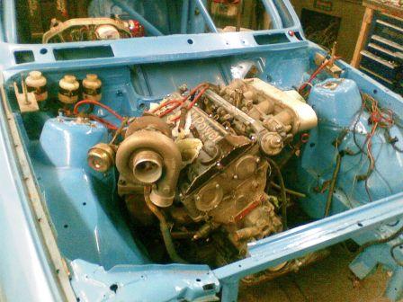

              this pic shows just how tall the whole turbo/manifold assembly is
              back in the car at last ,
              no real hitches fitting it, the n/s engine mount needed some "perswading" but thats often the case when you fit something for real for the first time having only previously mocked up so many modified bits

                sorry to hear about youre back troubles Grahamon the other hand im glad to hear the engine dropped in without too much fussthat turbo looks huuuuge on there.lets hope the supports save a once before problem out on track

                        is it not a bad idea to have hard fuel lines plumbed through the car, as in the event of a crash arent they more likely to split and spray the inside of the car with fuel!!
                        This was my reasoning for running the fuel lines under the car but i am runing a road car not a race car.
                        Live Life Sideways
                          • 25261
                          on a race/rally car its standard practise to run the fuel lines inside the car, far less chance of damaging them or ripping them off on kerbs, gravel traps you name it.
                          for safety reasons the rules say in car fuel lines have to be either metal or braided, your pretty unlikely to split open a metal fuel line, sqwash it maybe, either way your never goung to fill the car with fuel, the moment the fuel pressure drops the engine will cut, as soon as that happens the ecu will shut off the fuel pumps anyway

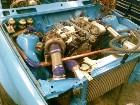

                                • 25261
                                with the rad, turbo and intercooler in it was time to try and plumb the coolant return from the engine to the rad, the new turbo location meaning neither the 2006 or 2007 setups would work, it took a while but i got there, at the monet the hoses are only mocked up, the hard bit was trying to do it using only stuff i already had, got no cash for buying new bits
