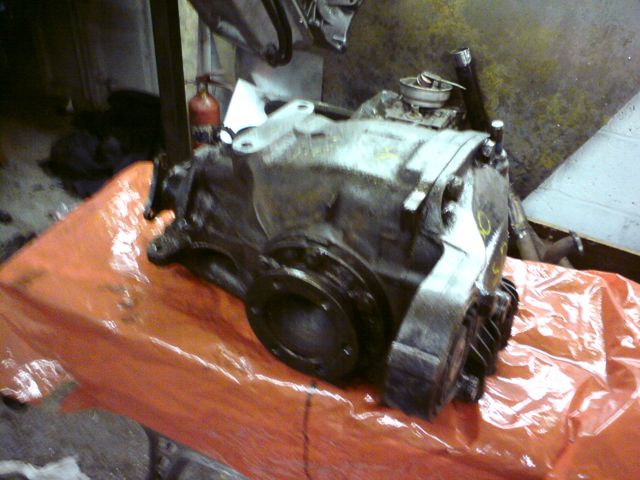

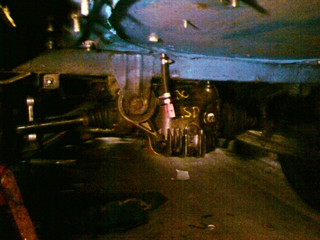

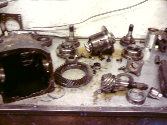

      i've pulled the diff out so i could change the ratio to suit the N/a engine
      i was a little concerned as to the condition of the diff interals as i bought it from a scrap yard and have never even looked inside it, thankfully it was like nw inside, so i simply got on swapping the CWP the only new parts i used were a collapseable spacer and oil seal it was a 3.46, its now a 4.27 which is possibly slightly short, but my only other ratio is a 3.9 and i think that is likly to be a bit long so better to undergear than over as that will have less detrimental effect on performance
      back under the car

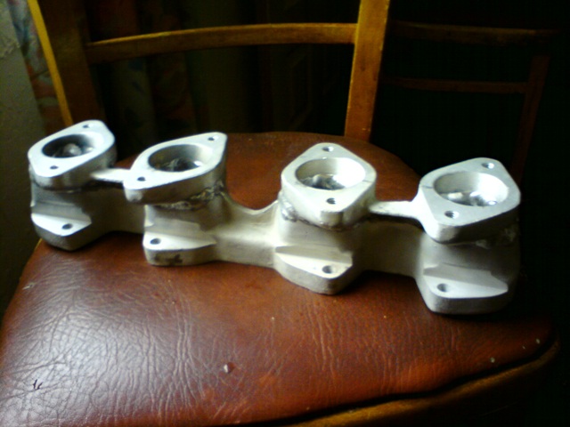

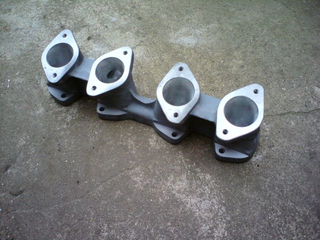

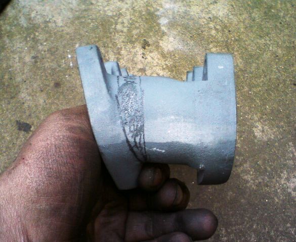

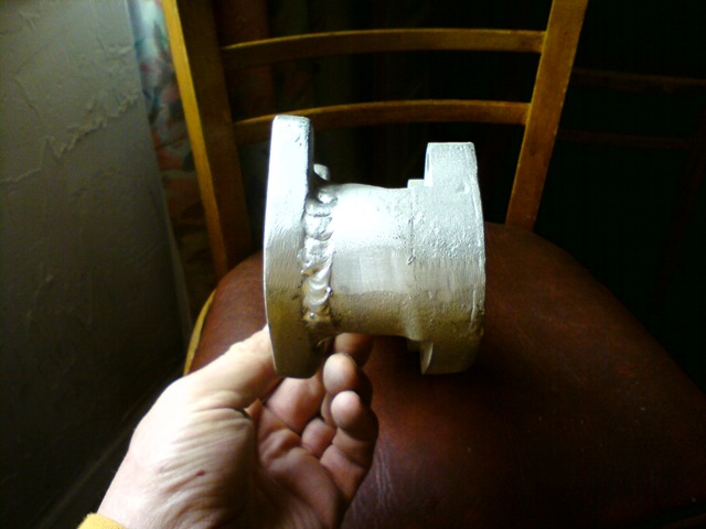

              after spending a while cutting holes in my head to throttle body adapter plate i decided i just wasnt happy with it, i just couldnt get the nice transistion from T/B to head i wanted and i know this engine really likes a good inlet, so i bit the bullet and ordered an inlet manifold

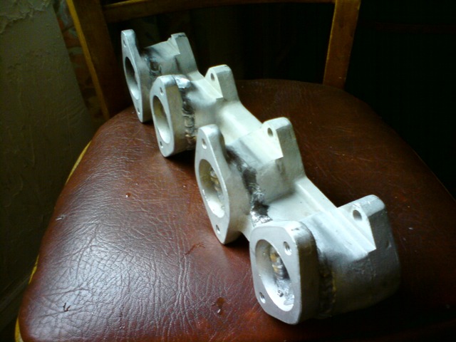

              now i have nice manifold, but its got a bend in it, i know for a fact the bend will cost power around 10bhp, so i hatched a plan
              i got a mate to cut it up and weld it back together without the bend

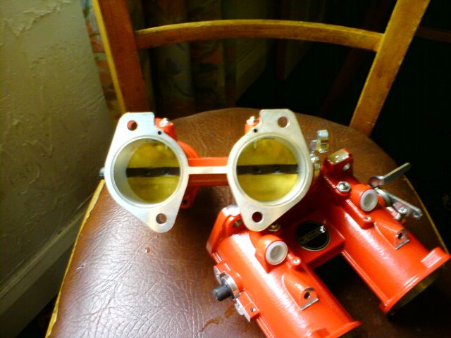

              rather than carry on trying to adapt my existing throttle bodies i phoned emerald and ordered some, they gave me a very healthy discount
              the bodies are an enorous 50mm, 48 would of probably been big enough, but oversizing t/bs doesnt have the same downsides as oversizing carbs it gives me a bit more tuning potiential and due to the slight offset in the inlet manifold the bigger size will give me a better straighter inlet tract into the bargin

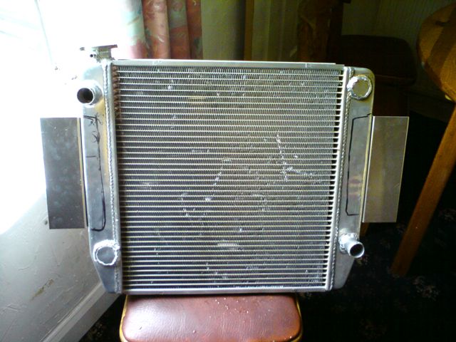

              lastly for the mo i also got my mate to add some mounting lugs to my rad and relocate and resize the inlet and outlet much simplfying connecting the cooling system

                Nice one Graham, those TB's must look mahoosive
                Rad looks good and as you say will now plumb in nicely with no messing about

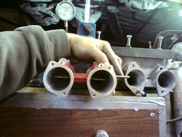

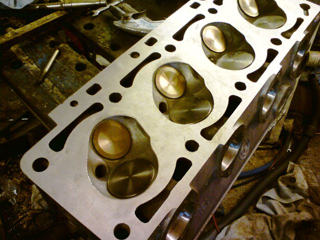

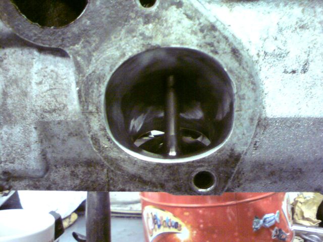

                  a little more progress i got my head back from being line bored to suit the oversize cam journals and its had a healthy 0.100 skim to bump the compression upto 12.1,
                  so i set about finishing the porting ( or so i thought!)

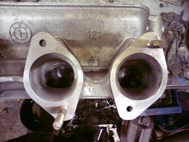

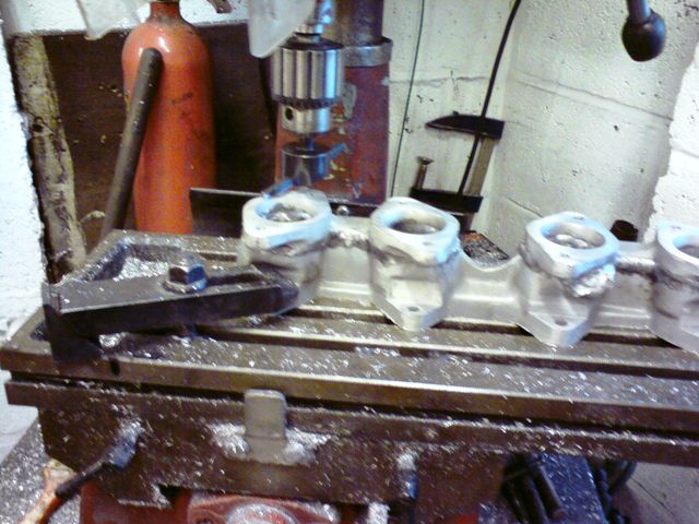

                  the inlet manifold needed a hefty skim on both sides to make its faces flat again,
                  and an enorous amount of porting to open it out to match the 50mm T/Bs

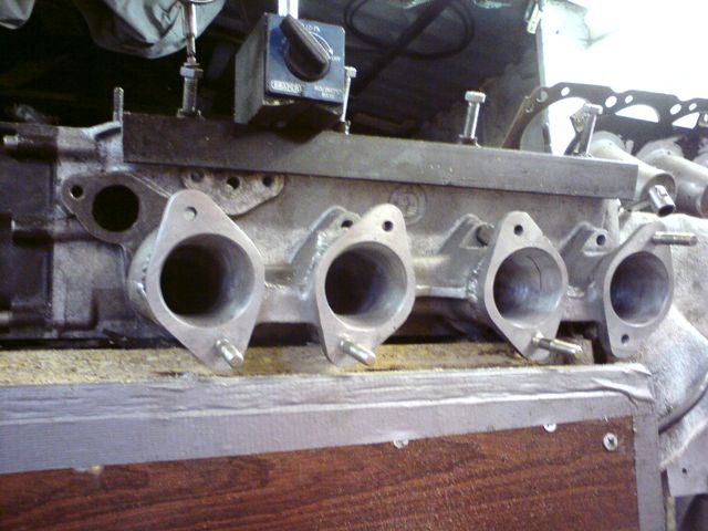

                  with the manifold now being quite short matching it to the head was very easily done with it bolted to the head,
                  next i egerly put the head on the low bench, here a problem emerged, either the head isnt flowing as well as it should although it still streets ahead of linford, or the hoovers have lost some suction so i need to do some testing and find out which,
                  either way i have found that the inlet mainfold has absolutely no reduction on flow, which isnt suprising as its straight and a finishes with 50mm large ports, although i didnt take a picture i found attaching a 45mm ram pipe made no difference to low, not suprzing really when you consider the valve is 46mm
                  next i added the 50mm T/B, which to my suprise does reduce flow slightly, not a lot but it does all the same, its the sort of difference you get from lifting the valve an extra 0.050 when flow is nearly at its peak, this suggests in terms of absolute maximum power the 50mm T/B as a good choice, clearly it butterfly and spindle are the cause of the restriction as thers othing else in the T/B althoug you can close off the throttle by a good few degrees without any further loss of flow, which also suggests its rather too big if rallying type drivability is your goal

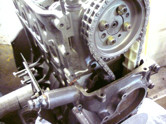

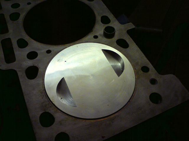

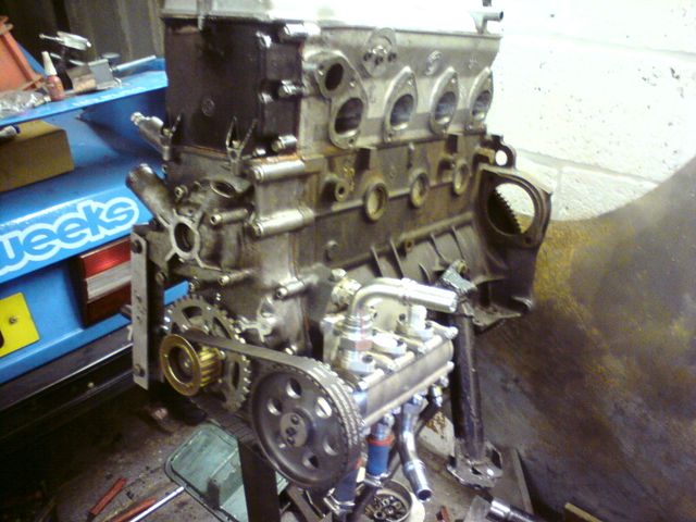

                            work on my engines been slow of late, its had several trial builds especially the head which took a couple of goes to get the rocker geomtry right, then i had to deepen the valve cutouts in the pistons, those cut outs are now scarey deep but have to be because the cam gives a monster 0.230 valve lift on TDC overlap i've turned a std cam sprocket into a vernier so we can swing the timing on the rollers although last time we tried playing with the cam timing on a 316 cam it had no effect whether it will do so on the 336 cam is anyones guess, i've also modded the timing chain tensioner so it now has a "stop", on these engines the chain is tensioned hydralically with a light "helper"spring, this set up isnt great when you lift off ar 8k+ as the tensioner backs off

                              Blimey - those valve cut outs are DEEP! How much steel is left below them?
                              • Doug@g19engineering
                                • Mar 2006
                                • 729
                                #645
                                None!
                                Apart from maybe the gudgeon pin
