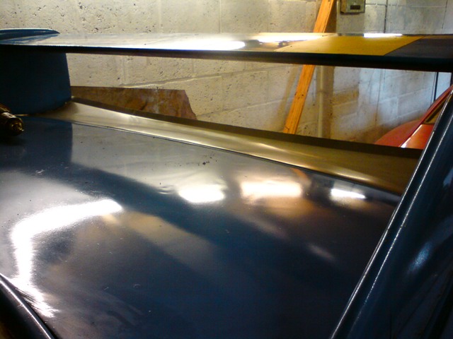

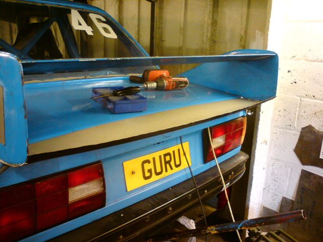

        an areo mod for the rear
        effectively ive just extended the bootlid, the idea being to get a bit more downforce but with out increasing drag, which it should do, it should also make the end plates more efficent as air going under the spoiler wont be able to fall away under the endplates, it shoudl provide a fraction more sideways grip,

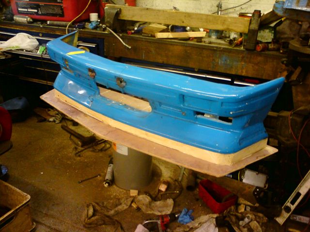

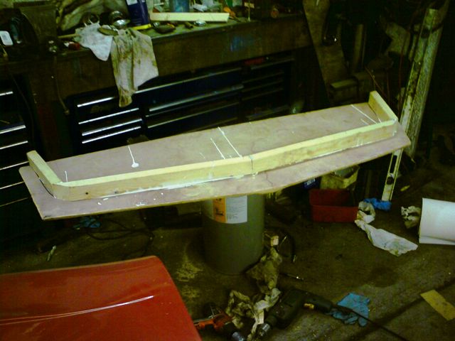

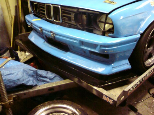

              after various comments on here i took another look at the ride height and dropped it a bit, but only by 10mm, anylower and the geometry wil all go to pot and im risking the front tyres rubbing on the stiffening ribs on the underside of the front inner wings
              after that i decided a front splitter may help a bit, so £17 later here we are!

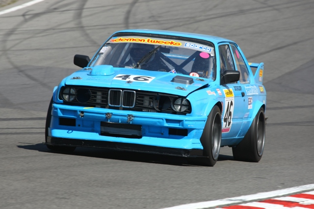

                            • 25258
                            jon bryant was busy with his camera too, from the look of this its me going into druids in practice
                            car looks very purposefull, it just needs pedalling fast to...............
