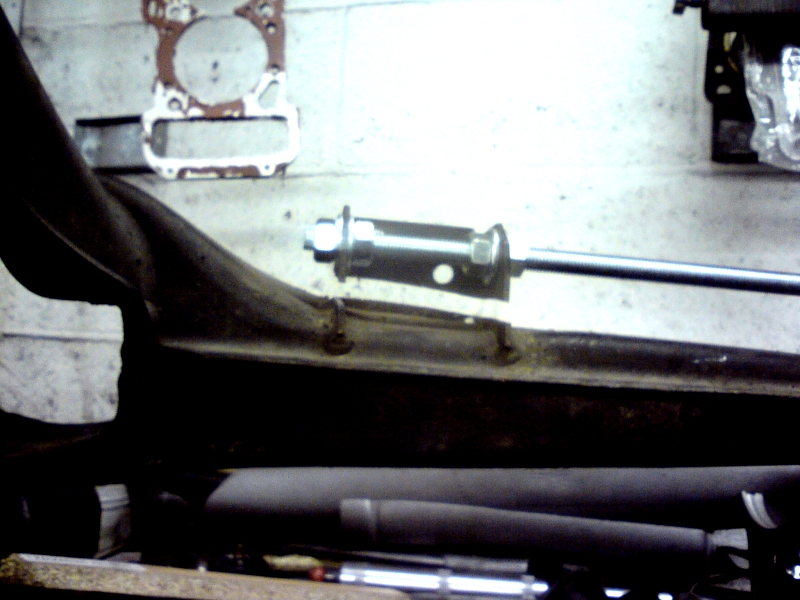

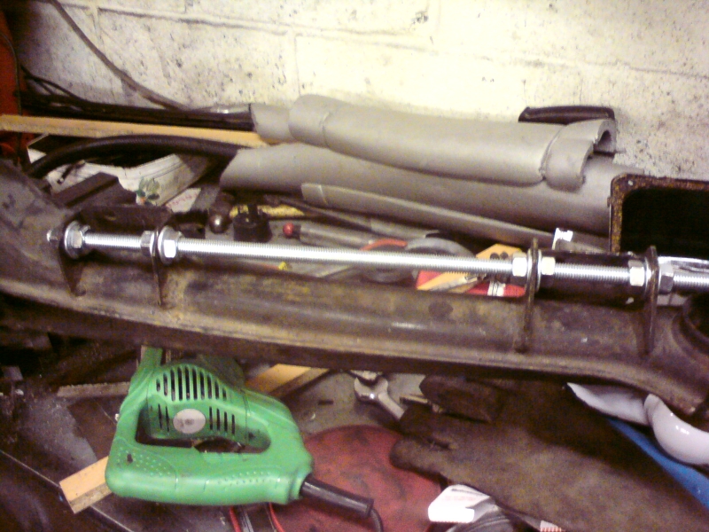

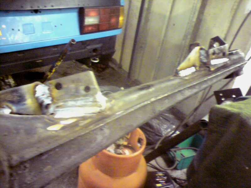

            a change of plan on the rear beam, without modding the floor in about 15 different places it simply cant go any higher, so i got out my spare beam to mod that, i just about have room under the floor to lift the inner trailing arm mount 10mm, this will take some more camber out judging by my 2002 which had a similar beam it wont be enough but somes better than none.
            after linking alll the mounts together with studding and nuts, i cut through the mounts leaving only the outer edge of the outer one still attached
            after bolting the beam in the vice and leveling it up, i bent up the outer mount on its one remaining attached side, the gap it created at the other mount looks enormous, but in fact its only change the pivot angle by a single degree,
            after welding it all back together i added a couple of braces, stregthwise they are not the most idealicilly positioned but anything else and i wont be able to service the trailing arms without taking the beam back out the car

              Graham, I like what you are doing keeping the centre line of the bushes aligned.

                some intersting ideas there, im trying to avoid modifying the trailing arms themselves, then repair in the event of a problem can be effected by simply fitting a new arm from a scrap yard, the watts linkage is a very interesting idea, but for me anything that adds weight to the car is also a no no, my car is chewing up trailing arm bushes, they are simply too compliant to cope with 250/640/18 slicks, so i need stiffer bushing so camber plates are out of the question because the arms will bind if i use them.
                had my wheels not been 18 inch them then the combintaion of the rear beam having a bit trimmed off the top of its mounting tubes and the shortened but upsidedown bushes would be enough to keep the rear camber sensable with a lowish ride height.

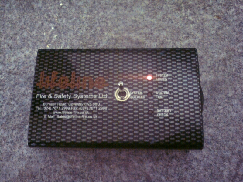

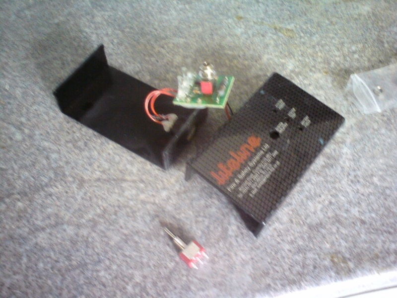

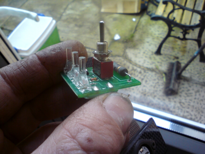

                    im feeling pleased with myself , having saved £100 by mending something, although it was something that shouldnt of needed mending in the first place
                    prior to doing the cage work on the car i removed the fuel tank, seat belts fire extingusher etc, but left behind its power pack big mistake i leant on it! and broke its switch, i wasnt happy especially when i found a new one was going to cost me £100 to replace it,
                    i instantly thought of maplins, but they didnt do the switch i needed, i googled for switches and miniture swicthes, i nearly gave up, but happened across a site called technobots, and oredered a 49P switch off them, i didnt know if it would work but at that price who cared
                    luckily when it did turn up it was exactly the same one as was in the powerpack
                    a bit of soldering later
                    dont get much for your £100 do you?

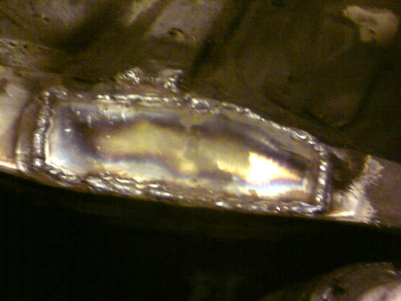

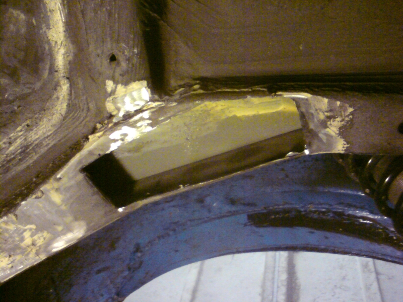

                            whilst the beams out the car i set to removing the OE rear brake pipe brackets because they will foul the modded beam, so i removed a few more whilst at it, including the origonal spring mounts which have long been redundant, to my suprise once i'd drilled through the spot welds one side i found a hole ( 2 one inch holes to be exact) in the chassis rail, im really glad i removed the mount now,
                            its very localised corrosion, because after cutting out the offending area and then some you can seet the inside of the chassis rail is as good as new and still full of wax
                            i cut a plate to but weld flush with the hole, which made a nice repair, the only downside being i had to weld it bit by bit, to stop the wax in the rail melting and running into my weld which the mig dont like

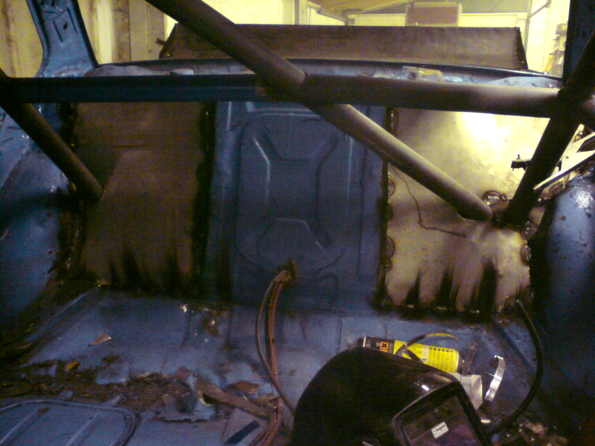

                              in between a zillion phone calls i've managed to put some STEEL back in the bulkhead
