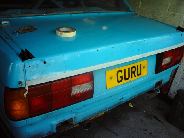

            using a strip of masking tape on both front and rear edges of teh boot lid, i trimmed it down a bit, saving a tad over 400 grams in teh procees

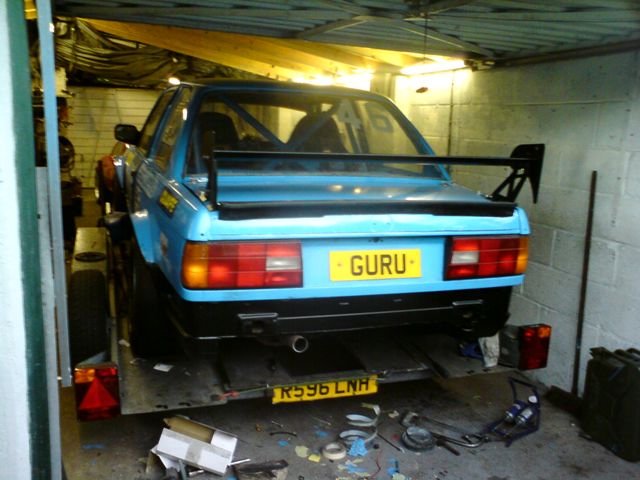

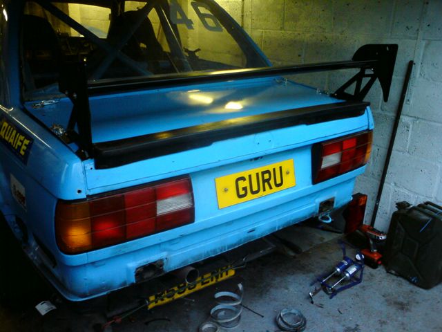

            also heavy spoiler has gone, replaced by a combination of a richard grant replica capri spoiler and a cheapo "wing" off ebay, i had to device my own method of bolting teh wing together because i dont recon it would of sayed in one piece for more than a lap of teh local high st on a saxo let alone the rigours of a race, it should actually have another element, but i darnt fit it for fear of it coming off!
            new spoiler combo has saved 5kgs, and if it behaves ok at speed i might take one of the spoilers off and save a bit more weight

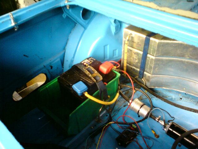

            i've tried the car with a much smaller battery, it still cranks plenty fast enough so thats another 5kg saved. in total teh cars down to 907kgs which is almost 100kgs lighter than when it was in turbo form, given a grp bootlid and no spoiler it could be down to 900kgs dead, but after that its going to be hard to find any significant further savings without spending a fortune

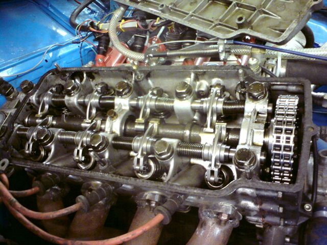

            lastly a quick tappet check, i just found one exhaust a tad tight, which is good news meaning nothings wearing out!

              hows about stuff like cutting the box that the battery sits in down? or doing away with it all together ?

                that box the battery is is weighs all of about 25grams, that to sort of thing you can go too far with weight saving, the other year i didnt use the box, i had another retaining method which was about 10 grams lighter, i finished a race only to find the battery had been sliding around the boot only held in place by the battery leads, i was lucky to finish!

                  yeah yeah i see what you are saying with the battery box, you are better off to carry an extra 15grams and finish than be lighter and not finish

                          Looks better Graham, bet the bootlid feels a bit lighter now.
                          Have you considered not using the rear wings for a race or a qualifying just to see what its like, you never know.
                          I think Tony Ryan still has some supertourer rear wings for if ever you want something a bit more authentic, not sure how much they were though, but they are quite light
                            #793
                            the plan is to see what "paddock" at lydden is like with and without, although its prob not for nothing that e30 m3 evo3 had a massive "flipper" on its rear wing
