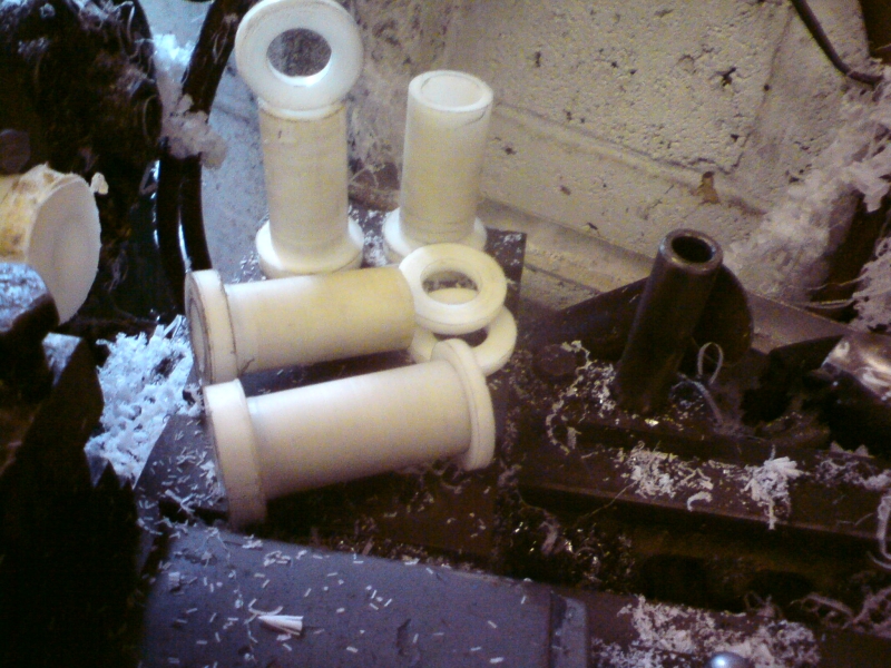

    i've bought sone nylon and made some new bushes for the trailing arms, as they are to all intents and purposes solid, i thought i might have issues refitting the arms, especially with my beam mods, thankfully there werent any issues, infact the n/s arm (the only one i've refitted so far) went in a treat easier than with std or poly bushes, interestingly it moves with less sticktion than the old bushes.

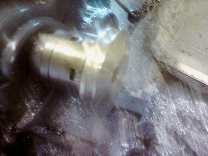

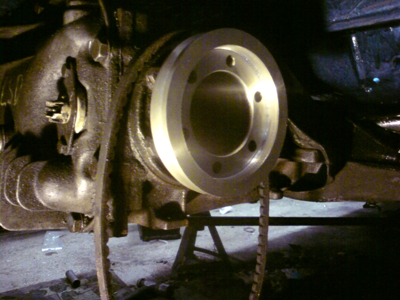

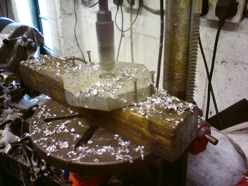

    for some time i've been looking for a pulley to fit between the diff and driveshaft, but havent been able to find anything suitable, but what i did have was a largeinch thick triangluar lump of billet alloy, an off cut i pulled out of a scrap bin somewhere, after roughly hacking it into a hexagon, i nailed it to a lump of wood, driled a whole in it and spent the next couple of hours at the lathe
    here we go one finished pulley, from a charging perspective it could of done with being bigger, but im not bothered the car wil be equiped with a working generator and as such wil satify ther rules, even if it proabebly wont actually charge if im pulling anything less than 7k in 3rd

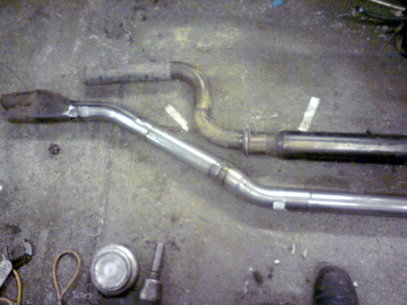

            ive remade the front part of the exhaust system, i didnt realise that when i remade the rear section in 2.5 inch to replace the previous 2.25 version that the rear section is now bigger than the front! the front bit being inbetween 2.25 and 2.5 ich, so the new front section is a bit bigger and straghter and without a silencer

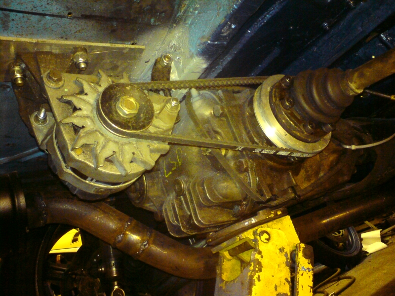

            and finished off the alternator installation

              Good work! I really like the position of the alternator
                #1042
                Looks good Graham, be interesting to see how 'out of harms way' the alternator looks with the car on the deck.

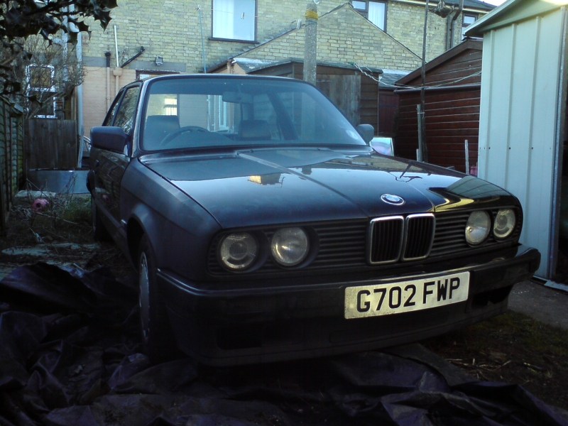

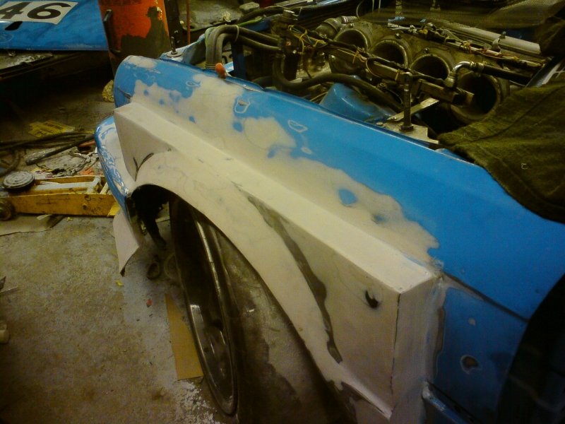

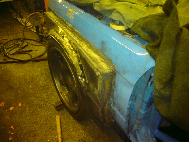

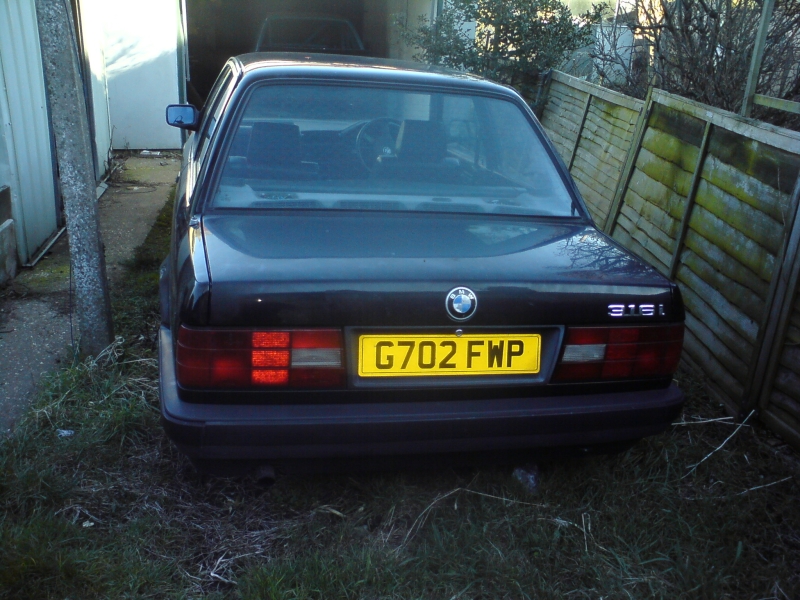

                  a slight sidetrack, i've bought another car!
                  its a base model non sunroof 316, ultimately its going to be the new shell for my car, but meanst while it wil provide a few spares

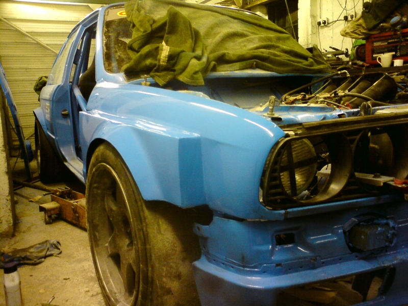

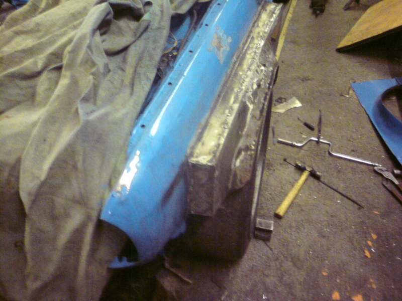

                  having lowered the front end a bit more i was once again in trouble with tyre/arch clearance, and have long since used up any clearance availiable by beating the arch upwards, so cutting a section of wing out and replacing it with a similar one from the new shell, ive effectively x packed the front wings, arguuable i should do the rears to match, but theres no actual need and times short so for now the rears stay as is
                    #1044
                    Good work but if it was mine I think I'd smooth/blend in the front of the boxes Graham otherwise the saying aerodynamics of a brick really do come to mind.
                      #1045
                      Just what i was thinking, but will still look mean once painted up
                      See what they look like all painted and then if you're happy do the rears later on to match

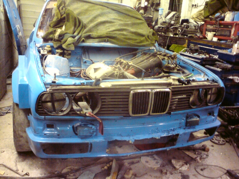

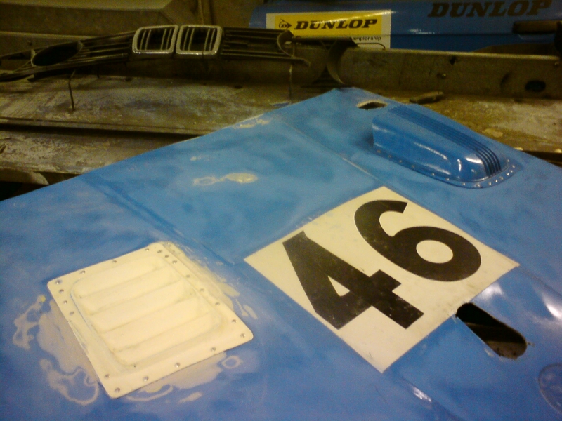

                            managed a bit more progress, swapping the baking tray for the scoop which was on the otherside of the bonnet will allow the bonnet to sit lower, the hole left by moving the scoop has been filled with a replica cossy bonnet vent i had spare

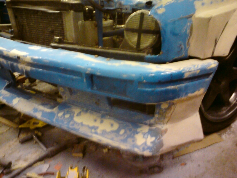

                            i've fibre glassed the front bumper/spoiler back together AGAIN! i had to make a whole corner from scratch, it should look presentable from a distance, to be honest i didnt try to make it really nice its been smashed up so many times it would need a whole day on it, i've also made it a new mounting system from a plank of wood a couple of coach bolts and some squirty foam,
                            finally the wings have had some filler. they arnt great, the folds and lines in the metal arnt straight enough, but like the spoiler i didnt want to spend a day on each one, in any case they should look ok from a distance which will do.

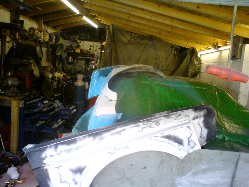

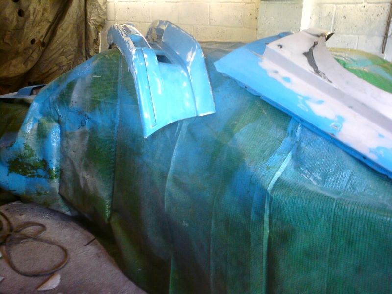

                              no time or space to shift the cars and trailer, so to paint the panels i simply put a trap over the car and used it as a stand to put the panels on,
                              at this point it occurs to me my garage looks rather like dave roberts shed,
                              unfortunatly the results are nothing like as good as dave gets, mainly cos i only had a couple of hours to prepare prime and paint the painels,
                              the finish is pretty poor, when i remember i used to do accident repairs and resprays professionally its absolutely dreadfull, but they will look ok when the cars on track, the top quality paintwork shall have to wait for the new shell.

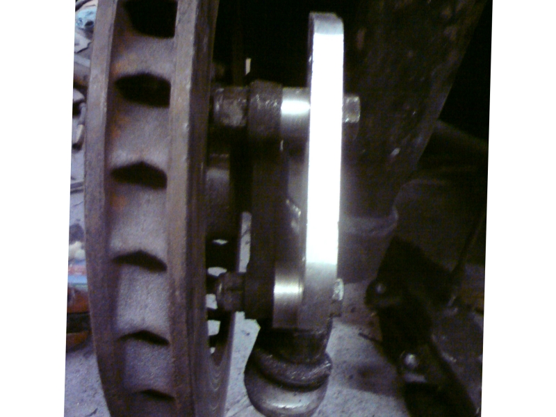

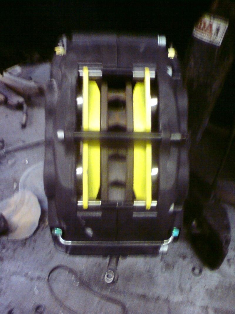

                              i've bought some new willwood 4 pots, there just like the old ones but have bigger pistons, the idea being to gain more bite froom the brakes pedal travel wil go up a bit, but i'd prefer a pedal thats a got a bit more give and feel, fingers crossed i dont have to start swaping master cylinders also!
                              bit of a hitch with the new calipers, they are 12mm wider than the old ones so i've had to make new spacers for the brackets
                              got the front winggs on and fitted a nice new unbroken front grill, which ive robbed off the new shell
