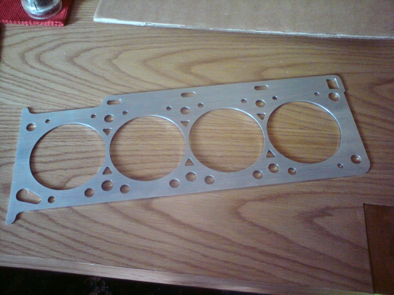

                back down to earth for a bit this turned up today
                a decompression plate from ferriday, although i didnt need it in a hurry, it was made to a drawing specific to my application and delivered in 48HRS!
                why do i want a decompression plate? well its to do with money really, my new crank will push the pistons 2mm higher out the top of the block (which has been skimmed by a couple of mm over the years), i cant machine the pistons down to suit, i dont want to buy new shorter rods or pistons ( which would have to be custom made) or a new block, which is 2K new or s/h as a whole engine. so given the choice of £100 for a decomp plate or £2000 for a block which will have to be bored i choose to spend £100
                if the decomp plate works ok with this engine it leaves the door open to further future capacity increases given a fresh blockand decomp plate i could increase the stroke more without changing pistons and rods, making 95mm stroke possible with a 95mm bore i'd have a 2693cc or 2722cc with a slight 0.5mm increase in bore size which would really and truely be the absolute upper limit of whats possible capacity wise with this engine

                  Re: A race bmw 316, 240bhp Atmo M10
                  will you use normal gasket sealer to secure it to the block or is there a special glue/ sealer as i have a decompression plate for my zvh. Looks like it going to a weapon on the track..
                    • 25249
                    ferriday say put the decomp plate between the head gasket and head, use a thin smere of blue hilomar on the top side of the plate to seal it against the head

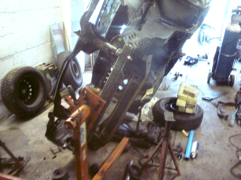

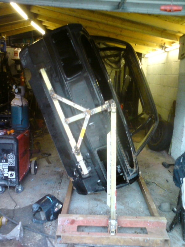

                          i decided i need a rollover jig, making life difficult for myself i also decided i wasnt going to spend any money on one!
                          this is what i came up with, using the base of my engine crane which is unbelievably heavy i welded together some old bits of A frame and attached it to the oe
                          bumper mounts, somewhere along the line i cocked up a bit and made and the pivot higher than i wanted, not that i realised until later, the plan at the other end was to use one of my engine stands (i have 3) getting very late in the day i hooked up the engine stand and realised my pivot mistake, the front and rear being at vastly different heights, at that point i went in doors rather dejected my work was proabaly a waste of time, differnt height pivots mean it wouldnt rotate
                          in the morning i discovered much to my surprise that despite the missalignment the shell rotated quite nicely and the whole things quite stable
                            Excellent idea with the engine stand, would never have thought of that. That means I am half way to a rollover spit myself.

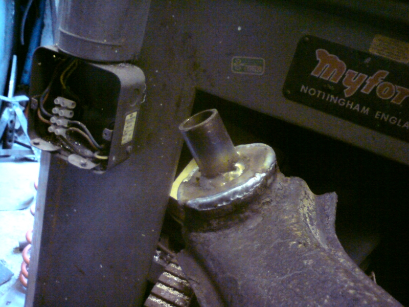

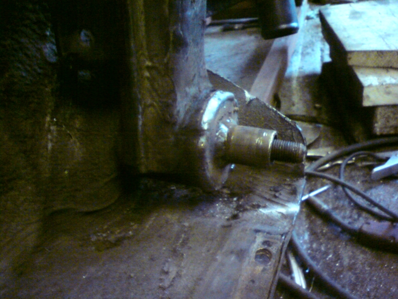

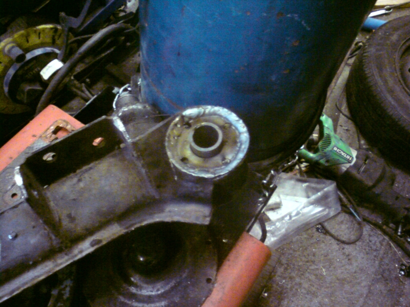

                                i sorta side tracked myself today and started modifying a rear beam for the new shell, gradually i've been moving the beam up in the old shell, as moving it up limits the adverse camber effects of lowering, i've now taken it a step further, by doing away with the bushes and by building solid mounts directly into it i was able to get the beam higher up than previously possible, ive gained about 1- 3/4 inch.
                                normally the tube through teh middle is flush with the underside of beam
                                pictures on its side because the car is! a rollover jig make working on the cars underside a pleasure instead of an arse!
