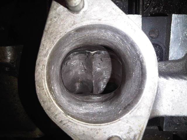

          in the end i decided not to fill anything and just blended everything together, not quite finished in this pic but nearly there, having thought about it the std s14 has quite a sharp turn on the short side, which doesnt seem to hurt it, especially when you think the standard road going 2.0 version still pumps out over 190bhp!
          the angle of the port means effectively its opening is slash cut so the area of its opening is much bigger than the port itself and as the area of the inlet manifold is greater than the area of the port i dont think it will flow any differently to when it was on the flowbench, only one way to find out...........................

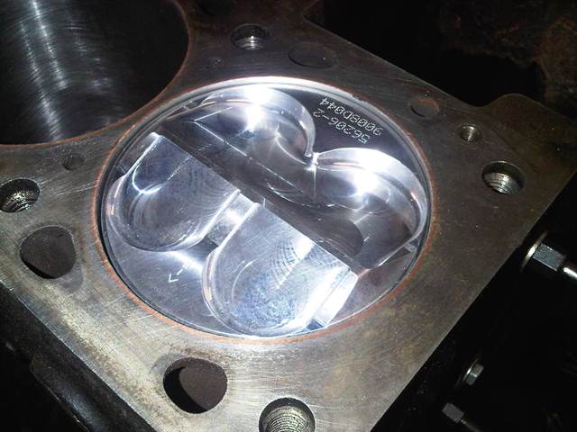

                                blocks now bored t suit the pistons so the capacity is now 2598.9cc
                                as you can see instead of being 3mm out the block its as predicted 2mm down the bore, i've had a couple of goes at working out how the piston shape effects the CR, by bureetting the volume above the piston with it a little way down the bore, i've got different results each time, possible because i got a bit of fluid leakage around the piston, will have to try again with rings fitted, eitherway though it seems the intruder volume isnt as great as the valve cutouts so compaired to a flat piston it actually drops the compression a bit, as it stands the C/R is under 10:1, so the blocks gone off again to have 40 thou skimmed off it, using a thin headgasket will take another 40 thou out the volume and should give me around 12.5:1 depending on the exact cc of the head once thats finished, as long as i have between about 12 and 13 to one i'll be happy, with s14 bits being hard to come by at afforadable prices i dont want to skim any more off anything than i really have to
