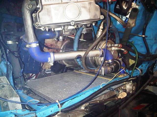

    it seemed to take ages but yesterday i sorted the top hose and remote thermostat and bleed from head out, the main reason it too so long was that i had to do it out of lots of small secondhand bits of samco most of which were too short, the inlet side of the head is higher than the exhaust where the coolant leaves the head, so it needs a bleed to remove trapped air, without a header tank (current rad doesnt need one) i was a bit stick and plumbed it back into the thermostat which i wasnt sure would work, because the thermost is only slightly higher than the head and i'd be plumbing the bleed back into the same part of the system the main water flow goes which made me think all the water might go through the rail and non through the bleed, but i tested the bleed circuit with a bit of clear hose and it worked, you could deffo tell it worked when the clear hose softened and blew off and the engine squirted water everywhere.
    didnt get much else done yesterday other than run out of fuel! then check the valve clearances once i'd got it properly warmed up, i swapped a couple of shims, dunno why i adjust them right when i build it because theres always a couple that are wrong once its run, i've got two inlets that are a about 4thou tight but will have to live with that for now as i dont have any thin enough shims to fix that and the chances of getting a couple before going to the rollers is slim, still if im 100bhp down i've got a ready made excuse _ not!

        as is often the case, one step forward and two back, infact today we prob had two or more steps forward and several back!
        mapping showed up a couple of things today, 1stly the engine doesnt like either the really long or large dia diameter trumpets, emerald are developing something that i cant reveal but we used that instead, the next issue is using small dia trumpets were getting massive fuel stand off which we never really got round,
        sadly though before working our way through all the inlet permutations it became clear that the cooling system was seriously overpressuring like one power run = 2 litres water in the catch tank!!!
        so it looks like i've got to rip it apart again, which im not looking forward to.
        otherstuff, well its doesnt rev, i say that it does, it just doesnt need to rev to make power, if the final mapping doesnt lift power higher up the rev range im going to have to change the diff ratio again, hopefulyl it will peak higher or hang onto it longer but the scores on the doors so far are
        257bhp @6600 and a wonking great 243lbft cant remember where peak torque was at around 3K

                  nope, we'd had a couple of hours on the rollers before it developed, i took the head off this morning, the gasket was deffo leaking at the fire ring and in couple of places too, no idea why though, the blocks been refaced, as had the head, the bolts were still tight and i'd checked they werent bottoming out, the rollers are fully booked for weeks ahead, but dave has offered me the chance to be squeezed in on this coming weekend even though they dont work weekends, so i'm having to work fast, with time against me, i've decided to refit it with a std type gasket which i already had, this will cost me about a ratio on the compression due to it being 3 times thicker, so the machine shop shaved another 0.030" off it while i waited earlier today, meaning i'l only loose about half a ratio but thats it for this head now it wont take any more being taken off it, as the skimming has now hit the valve seat inserts, but TBH the head i chose to use has had a very hard previous life, and isnt upto doing duty on the next evolution of the engine anyway

                          both block and head had been refaced and are dead flat, nope its wasnt overheating on either gauge or ecu temp sensors, cant see it being compression pressure, the engine was making 240lbft torque, which is only half what the same gasket held with the engine in turbo form so although the satic compression is higher dynamic is way lower.
                          its nearly back together now, just got to refit induction sytem cam cover and a few hoses, whilst in there i also sorted it the tight tappets
