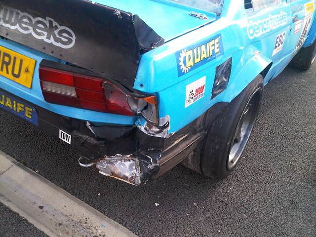

            #1670

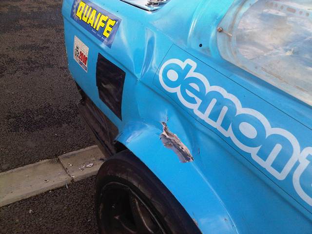

            ouch, nasty, your gonna need to sort that re shell out soon by the looks of things, poor old girl seen better days. hope your good with a slide hammer
            • rwd2ltrfiesta
              • Jan 2011
              • 1731
              #1671
              take more than a slide hammer i rekn alex, chain around a tree get that kink out or loadsa bogo,
                #1672
                Ouch !!! Bloody hell they keep banging you ? I hate body damage!

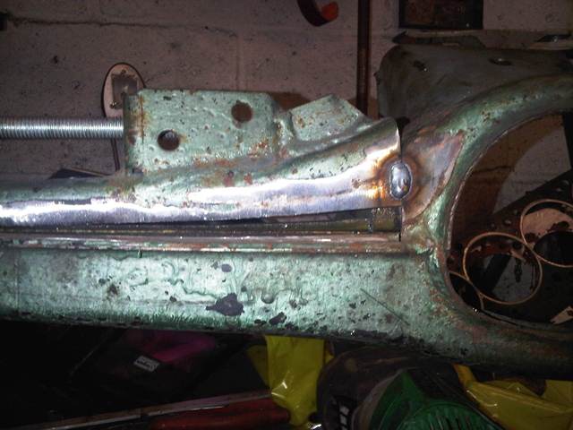

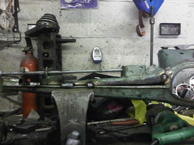

                    since then i've porta powered the worst of the dent out the back of the car, but perhaps better with the assistance of my son stephen we gave the garage a massive tidy up and got the new shell in a workable position
                    above pic is of modified beam mounts, which are now shorter and and a welded part of the beam the length of straight tube sticking out the bottom gives a clue how much higher the beam will sit, this will put the beam much higher in the body than the modded polybushed beam currently in use

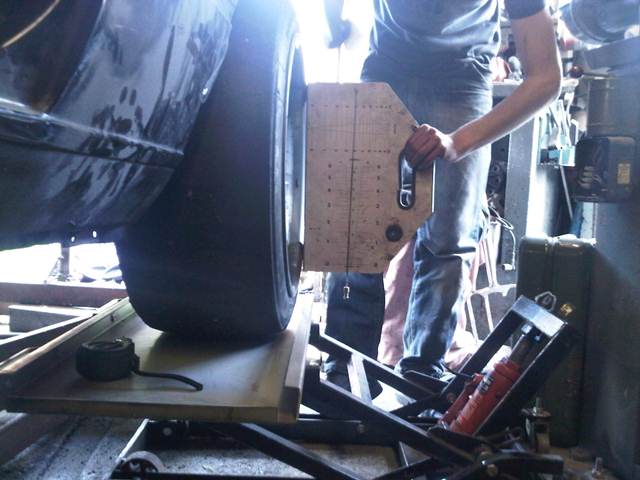

                    the current beam also has been modded to remove some camber, i wanted to see what effect that modding the mounts alone would have so we fitted a trailing arm and wheel and jacked it up to match the ride height on the current car, the good news is it gave exactly the same camber as the current car, this means if i carry out other mods to match the ones on the beam in use i can get the ride height down a couple of inches and keep the rear camber sensable

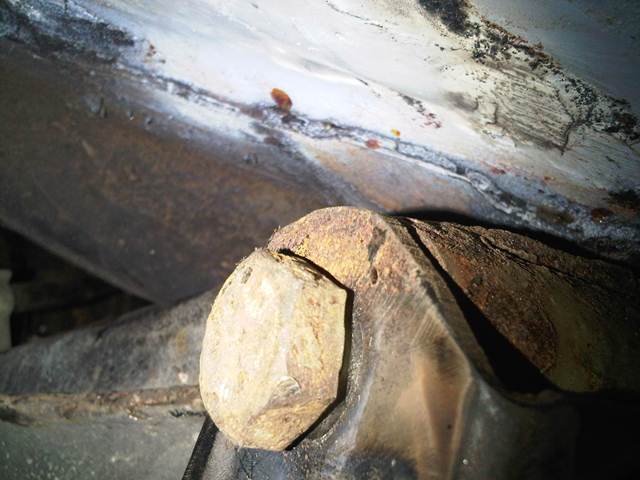

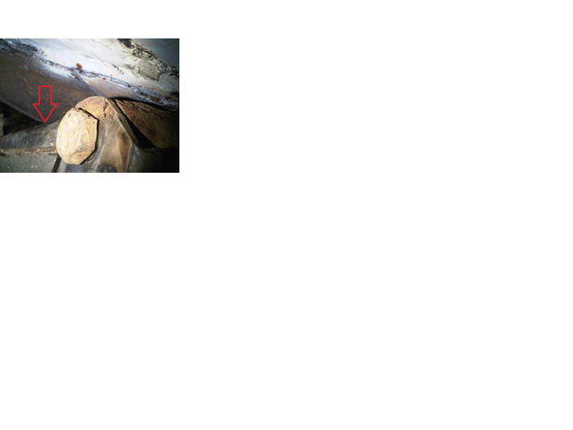

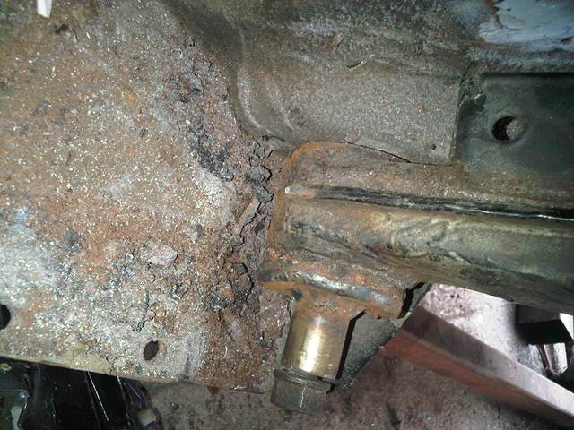

                        ok been a little bit busy, i taken about 10kgs of sound deadning out the car and did some more work on the rear beam, which basically involves moving the inner pivot up to take camber out, having refitted the beam initally it looked good, i had 1/2 degree Positive rear camber, ok positive isnt good but the ride height was only an inch lower than the current car, so when it comes down more (im looking for a total of 3 inch at the rear and 2 inch at the front it should of been about right) then i found a glitch trying to jack the supsension further up tipped the shell, odd seeing as no springs or shocks are fitted!
                        it turns out the combination of the much raised beam and me trying to drop the ride height so much further means the trailing arms was hitting hard on the chassis rail near its pivot, Dam!
                        checking the blue car indeed that has only about half in of clearance,
                        of coarse this would never be an iusse if i was using 14 or 15 inch wheels like the car was designed around!
                        a quick dig around the shed and find another beam, this time instead of just moving the inner pivot up, i've sliced the beam and moved in inner up only half as much and moved the outer down, which if i couple that with a slightly lower ( but still higher than the blue cars) beam mount i should be in bussiness, alternativly you lot can all sponsor me so i can switch to 16 in wheels
                          #1677

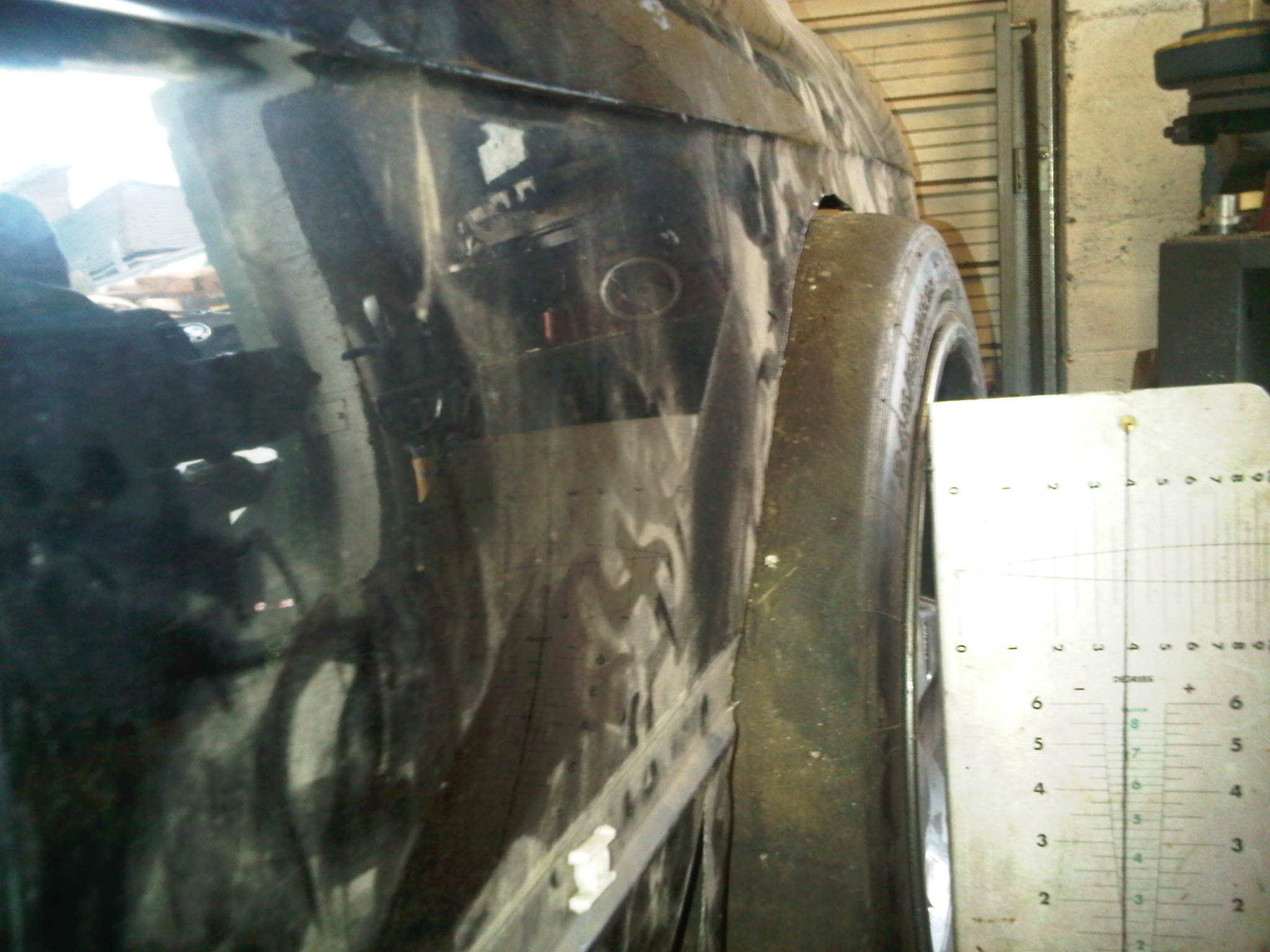

                          so after what seems a whole weekend of bashing cutting welding, i've reached a point im happy with, a 3.5 inch drop on the rear ride height results in 2 degrees neg camber, without the mods that would of been about 9 degrees! i wont run it as low as minus 3.5 but its worth checking to see what happens when the rear sqwats, the actual ride height at the rear will be about 2.5-3 inch lower than current and gives me a sensable camber of 1-1.5 neg,
                          the reason i cant go with a 3.5 inch drop is the car will end up with its nose pointing skywards, the tyre to inner arch clearance allowing a max 2 inch drop at the front, but as the rear sits a good inch higher it all sort of pans out
                          clearly i've a bit of work to do in the wheel arch dept!
