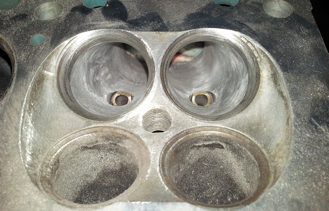

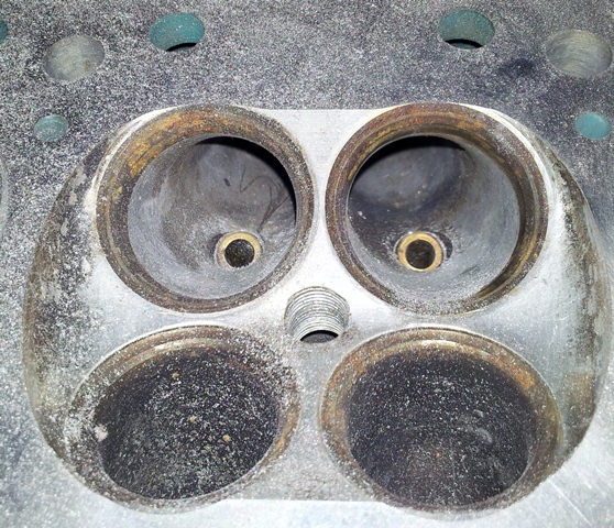

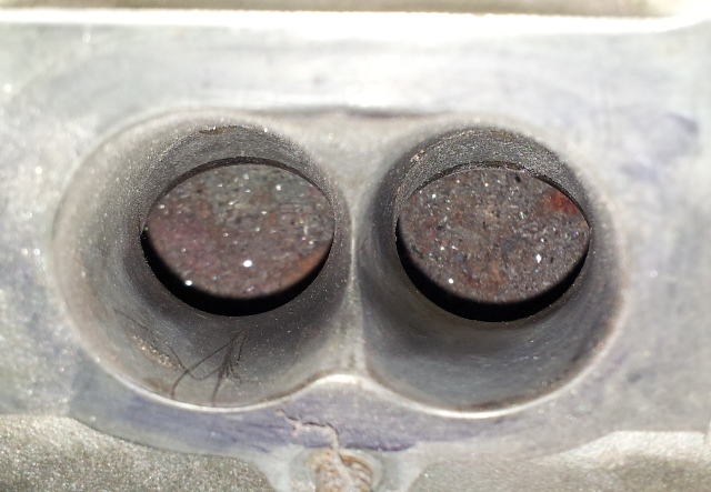

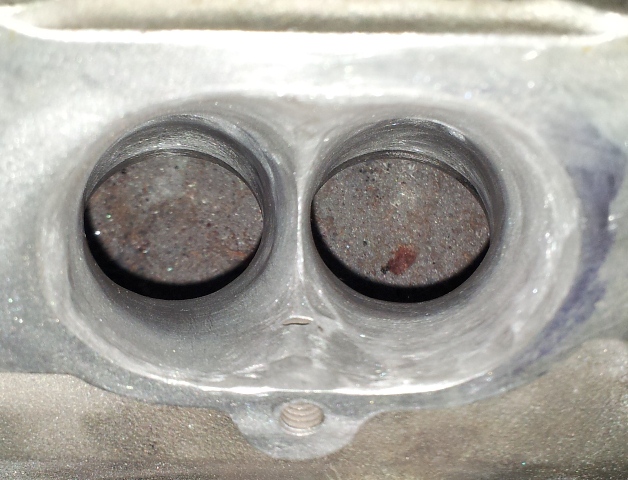

      some obligatory porting pics, fortunatly this time i've started with a big port head so it doesnt need hours and hours of grinding, like a yb or teh small port heads, the ports have been opened a couple of mm, most of the work has gone into opening out the manifold face to suit the slide throttles. bottom pic shows a hole in the port where i broke through, fortunately its only into a manifold bolt hole so of no consequence, tbh i was half expecting to break through there because i did on the last head i did

        Nice porting, makes a change to start with a pretty well ported head eh?
