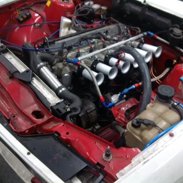

    As I know nought about BM's what engine is it Graham. Straight 6 2.5 or something...?
      #2042
      it started life as a 2.5 straight six, 12 valve, they make 170bhp as standard, its been bored and stroked so its now 2.8, reworked head, forged pistons, 6 branch and throttle bodies so give or take a fraction its got 100 bhp more than standard. lovely flat power delivery though and at quite low revs.

          #2044
          Nice... Plenty of torque aswell.
            #2045
            no progress worth talking about, but all the holes in the rear bulkhead have been sealed and belts are now in, so its getting closer to being race ready, that didnt make for any good pics to i took a pic of the throttle bodies instead

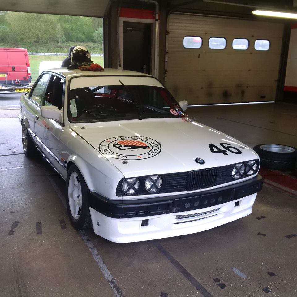

                i'd entered an all comers race last sunday it was a mixed bag of cars entered from a triumph gt6, renault clios, various bmws, hondas a very fast cossy and a ferrari 355 change car. As pic above shows i made it JUST! car wasnt ready until late Saturday night so no time for pictures in the build up. i hadn't had the chance to get any actual practice in the car other than driving it round the estate where i work, so to say i was nervous was a bit of an understatement, ive not raced since oct 2012 but i have spent a lot of time scrutineering so ive seen a lot of racing, crashes, things going wrong. even scrutineering was nerve racking, i dont think anybody likes it, but ,as a scrut myself my biggest concern was id missed something obvious. the thing is there are a large number of chief scruts, they tend to have their own teams, its possible i woulnt know any of them. driving down the scrut bay i realised i knew every single one, either my car would be pulled to bits or barely looked at, in the event it was something inbetween and there were no issues. that didnt do anything to reduce my nerves though, i dont know how many races ive done but it must be around 300, even so it felt like my first. in a way it was, a car ive never driven before, using tyres id never used etc etc. next up was to get up to the assembly area for qualifying, my mate graham had come down to crew for me, but having never done it before it i was left was struggling to remember everything, which including arriving at the assembly area without him, which left me legging it back the pit garage to collect him. i needed graham to make sure i was strapped in properly including the Hans device, which id never used and dealing with the slave starting battery. no sooner had a got back to the car with graham i realized i didnt have my balaclava! arrh! by the time id legged it down to the garage and back for a second time, i was now very hot, flustered and had very steamed up glasses, above all the whole time i had been concerned i might not be able to cut it out on track after the break so flustered was the last thing i wanted to be feeling. one major point though was id chosen to come back at the circuit id raced at most at least i wouldn't have to learn where i was going. we had only just got me strapped in in time and the steam had barely cleared from my glasses when we were ushered out into the pit lane, nerves got the better of me and i promptly stalled the car which takes some doing ( you can pull away in 2nd with no throttle) a quick panic later and it restarted.
                the moment i went up the pit lane exit i nailed the throttle and the nerves were gone, infact i was immediately cursing the Ferrari for holding me up. once on track i felt like id never been away. the car was familiar but strange all the same, the gearbox was throwing me, my other beemers have used a Dog leg 1st 5 speed box, this one has a normal overdrive 5 speed pattern, i was ok going up the box, but when i needed to go down i struggled as i found i wasnt sure which gear i was in and where a lower one was! the toyo 888's seemed pretty grippy and handling wise the car was without any vices, compared to its predecessor not surprisingly the longer more nose heavy m20 6 cylinder engine mad the car want to run wider after the apex's. the brakes felt really good, a bit too god really i found it all to easy to lock up the fronts. One aspect of the car did surprise me though, it felt slow! it felt like a rocket ship round the industrial estate but nothing like that at the circuit, i think thats mainly the higher speeds meaning higher gears in use and the better surface giving more grip so it went forward rather than trying to swap ends all the time, its also deceptive, it makes very similar power to my old s14 engine, but the much lower revving engine and flat torque curve dont give an impression of speed, it cant of been slow though as i passed the ferrari down the short cooper straight. my qualifying session came to a early end when the throttle cable snapped 4 laps in. annoying because it was a new cable, but none the less i was pleased to of posted a 58.8 second lap which looking at the competition and everything else considered wasnt bad going, i wasnt much slower than a another e30 fitted with wider tyres an s54 engine with about 100bhp more than me and a driver who hadn't taken years off.
