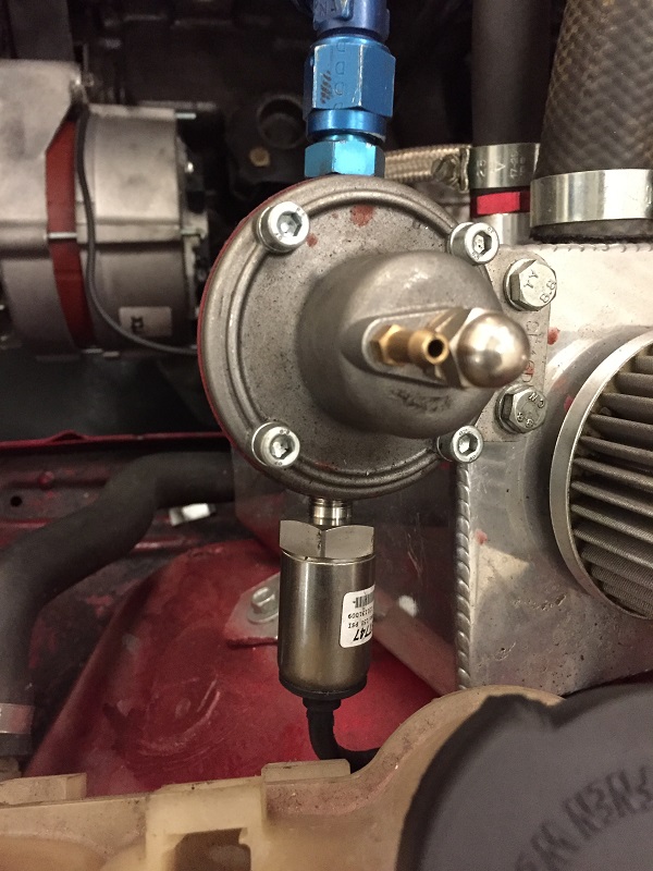

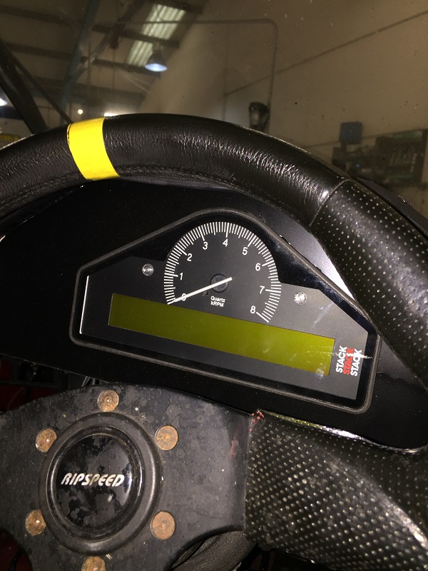

    although ive done nothing to the car for months i have spent some money, with the OE loom gone and thus factory instrument cluster now useless in most respects i picked up a nos stack dash cheaply, by cheap i meant relatively cheap for a stack, it wasn't actually cheap at all
    it came with pressure transducers for oil and fuel, fortunately they fitted in place of the old plastic oil pressure pipe which i never liked and in place of a blanking plug in the fuel pressure reg.

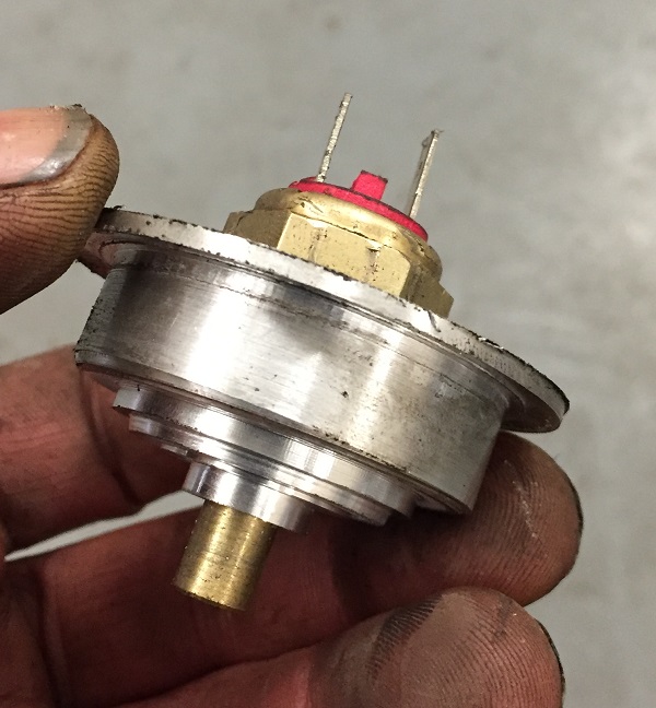

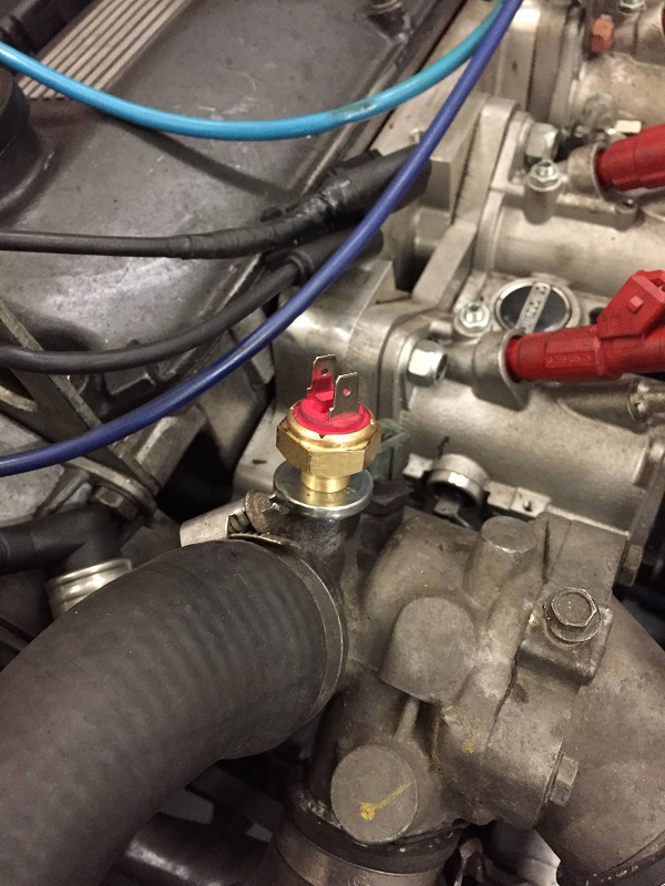

    i wasnt so lucky with the coolant temp sender, but got round that by drilling and tapping an 1/8 npt thread in a corsa sump plug which fitted in place of the oe bmw gauge sender. i havnt worked out what im going to do with the oil temp sender yet, theres not enough material for me to fit t to the sump plug

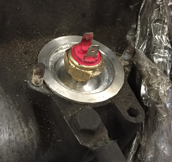

                ive sorted fitting the oil temp sensor, i turned up an adapter so it can fit in the sump in place of the redundant oil level sensor.

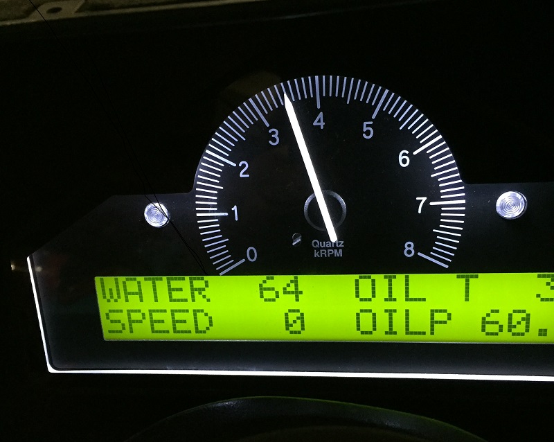

                ive also made enough headway with the new loom that today i realized i only needed make another couple of connections and i would probably be able to start the engine (i left the engine management loom largely intact) it fired up easily
                nice to see the dash works, its new but old and i bought it off ebay some time ago, so no comeback if it didnt work. it wil definatly be handy to have a fuel pressure reading and actually be able to be warned of oil pressure/temp issues via an automatic alarm, the car did have an oil temp gauge, but where it was located you'd of never been looking at it during a race, well not unless you wanted to crash!

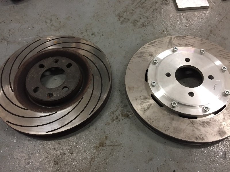

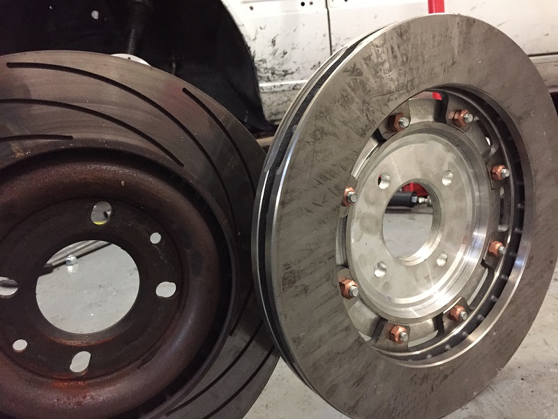

                      got bored with wires, im on brakes now, ive started re engineering the front brakes, not to gain performance as they work well, but to gain clearance for wheels, i have 4 different sets of wheels for the car, but only one set will fit the front. the big disc conversion (peugoet 406 coupe) uses a very flat disc with next to no offset so it pushes the caliper out a long way.
                      i bought some universal bells and willwood discs from rally design, the discs are almost the same size, but with the bell i can save a bit of weight and move the caliper to gain some clearance for the wheels.

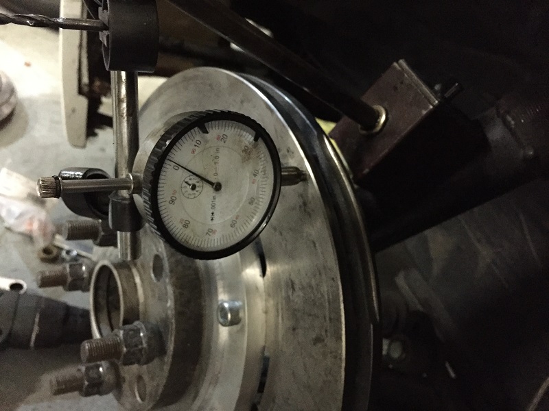

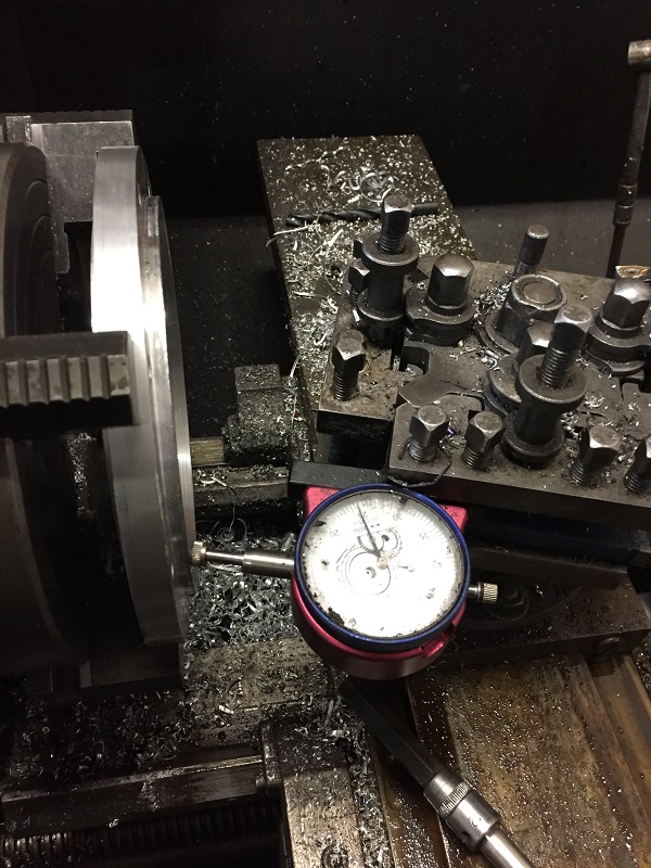

                      i had to bore the centre hole and add the stud holes and slim down the bell, it all mounted up quite well a check with a DTI showed i had 0.005 run out on the disc, that was probably ok, but i had another go at anyway, chucking up the bell in the lathe i trued it up in the chuck on a virgin surface ( well one that i had not already machined) i skimmed the face which goes against the hub, and took a lick off the disc mounting face, refitted to the car the run-out had dropped to 0.0015 at the outer edge of just over 300mm dia the discs, i can live with that

                          What grade bolts have you used round those discs and bells please, 8.8 or 10.9's? Look like copper locking nuts, like manifold nuts too?

                              • 25261
                              not sure, but 8.8s but would be good enough, yes they are manifold nuts, i wanted a lock nut but given teh disc glow red under race conditions i didnt think nyloc was a good idea
                              • rallyrob
                                • Apr 2010
                                • 2738
                                Ok thanks, yea I get what you mean about the manifold nuts.
