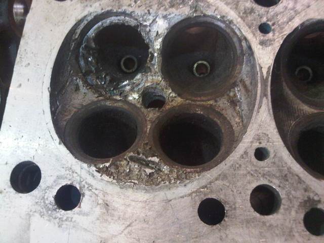

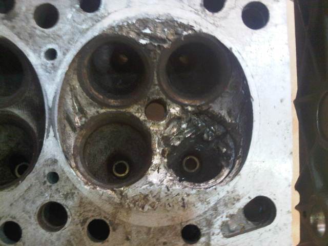

    some progress sort of, some time ago i bought a genuine 2.5 s14 head off ebay it was very cheap!
    you now know why. clearly its dropped a valve, judging by one of the inlet guides being deeper into the port than all the rest its likely that what actually happened was it was buzzed or used an un-advisably radical cam on the std shim arrangement, std shims sit in the top of cam buckets and can be flicked out.
    most likely a shim was flicked out, jammed and next time the inlet cam cam round, it tried to lift the cam way past its normal lift, the top of the retainer and collets punched the guide down and at the same time mashed a valve in a piston. ive just received a set of oversize valves from america, even with import duties etc etc they are a fraction of the price of buying them here. and have now dropped the head off to have it welded up and new inserts.

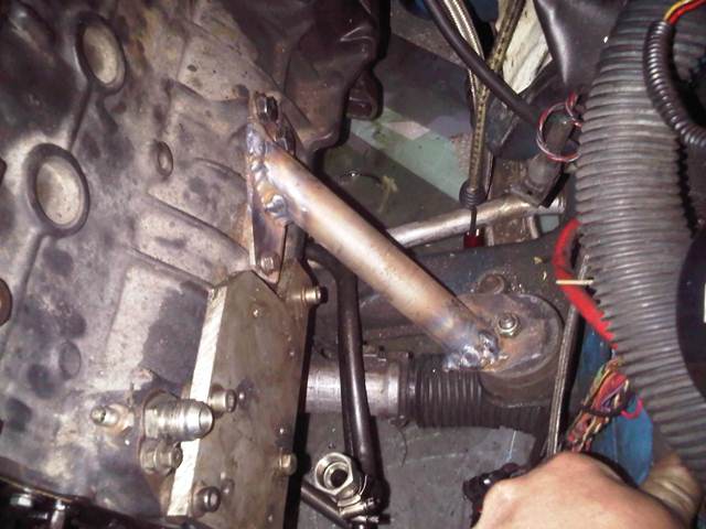

      done some physical work on the car today, made a new pair of engine mounts, the idea being to straighten the engine up a bit, so the sump works better, but mainly to give more space to get a decent exhaust manifold in, got to rejig gearbox mounts and linkage now
      lh mount
      lost the pic of the rh one but it looks pretty similar

                      a little more progress, heads back from being welded and having new inserts, need to port it now, although the machine shop advised me to be very gentle in one area of the throat because it was actually holed through to the water jacket
