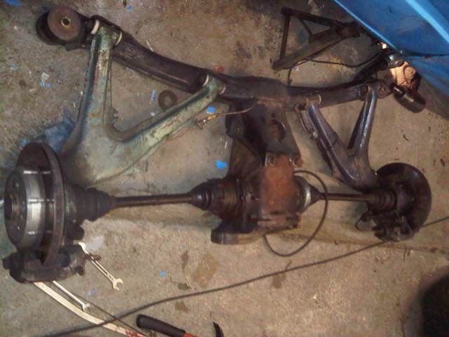

                right done a bit, dropped the rear end out to fit my modded beam, which frustratingly wouldnt fit! anyway got it in in the end but it did involve an angle grinder and the mig, meassured at back edge of the sill the rear ride height has come down a very healthy 60mm, with the very rear of the car being more like a stonking 90mm lower, and thats with a bit less camber in the back than before so i could drop the height a tad more, not a lot mind because the front can only come down by about half an inch

                ive also cut off the old arch and bashed the body slightly more back into shape, i cut the arch off for two reasons, with the new projected lower ride height tyre clearance would of been an issue, also last year (quite correctly) at one meeting the scruiteneers did complain the arch didnt cover enough of the tyre to comply with blue book, which was a bit of a surprise with the number of times its been through scruiteering and no one ever noticed before or come to think of it since!

                  Brilliant Graham, I think getting the car down lower will be a massive step forward and certainly help you to battle the fast front wheel drivers in the corners. Looks like a bit of panel beating is required though
                  is there a lot more to do mechanically on this shell if you are definately using it next year. If not then maybe i can take it for a bit of tidying and TLC while you get on with the engine(s)
