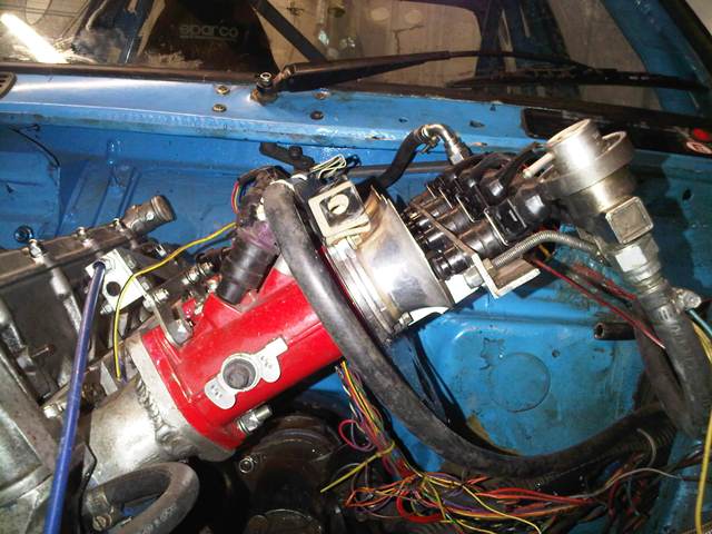

                          shock horror! look how short the intakes are!
                          as i said elsewhere about 3 inches longer gave better torque but robbed me of some topend, and judgeing by how much the backend twictched it certainly didnt need more midrange anyway!
                          we were getting pretty bad fuel stand off at some points that you dont experience with the large diameter big tapered trumpets, but then again they gave less power, whats probably happening is the bigger dia ones are killing the induction pulses, so you get neither bad ones that chuck fuel back or or good ones that aid cylinder filling,

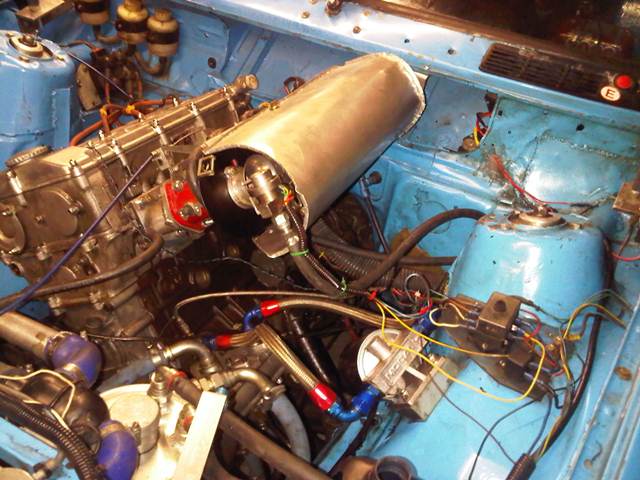

                          before brands i knocked up an airbox of sorts, well more of a splash shield really to try and keep the fuel around the intakes not blowing all over the place waiting to go woof!

                            #1573
                            That is an interestig setup. Some bundle of wires under the bodies. I can see how you would have clearance issues with the bonnett. If the trumpets were much longer you would have serious problems getting it to fit.
                            What is the currentl length from the end of the trumpets to the back of the inlet valves and what was the length with the longer trumpets? At what rpms were you getting the standoff?
                            What length are the exhaust manifold primary pipes. The standoff may be due to the exhaust not scavenging properly at certain RPMs
                              #1574
                              we tried so many different lengths its untrue! i'll have a meassure later for you, the stand off also varies with trumpet length, exhaust primary length, err not sure its about 16 inch, as its a pinto ashley i wouldnt be hard to find one to meaasure, same manifold on the 8v gave far less stand off.
                              TBH its got to stay as is for now, moneys all spent up! if i do anything i need to play with the diff which i probably will, fossie has pm'd me some interesting info, the only otherthing i might do is look to shed some of the 30 something kgs weight the cars put on over the winter because currently im 150kgs OVER the min weight and thats with just a couple of litres of fuel in the tank
