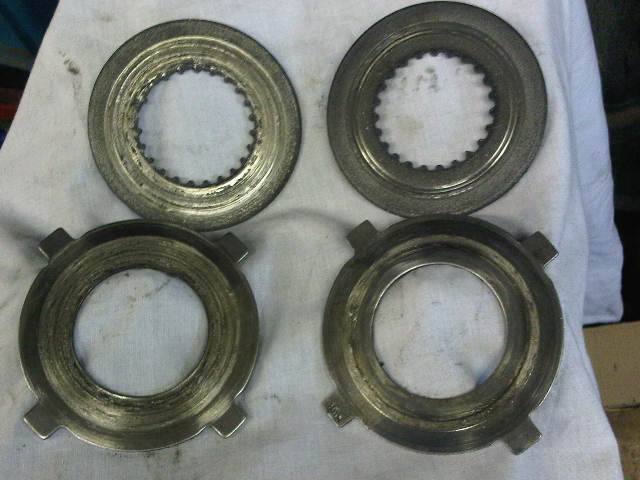

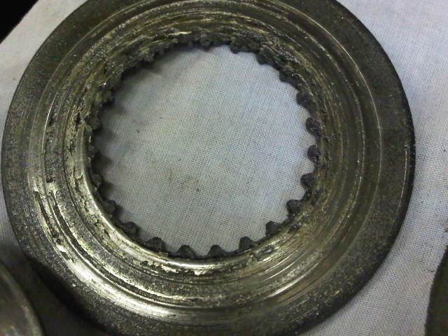

                                bit of a lack of updates, and quite deliberately, after my great scrap with bill richards last time out i didnt want to make it public that i was trying to make the car faster
                                these are the plates out the slipper!

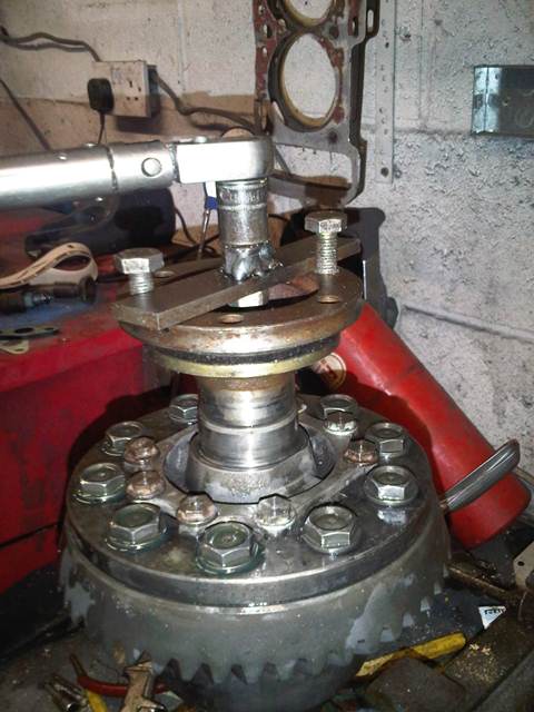

                                with advise from others and a special thanks for lots of emails and contact info etc from tom at fostek, the slipper has been rebuilt its now got 4 of each plate type in it as well as almost double the preload
