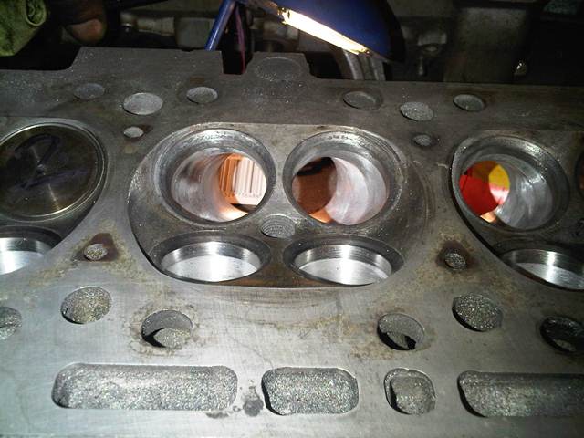

          Looking good Graham, how many hours would you have put into the work on the head?
            • 25258
            theres a long days worth of grinding in the head, it was taking me about 3 hrs per cylinder although i did need to have a few breaks to let the compressors catch up or the die grinders thaw out, thats grinders plural, constant grinding after a while cause ice to form inside them so they stop working, plus they freeze your hands even wearing gloves

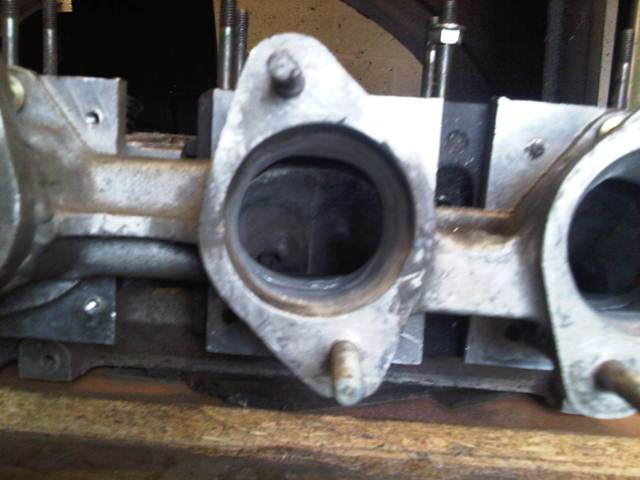

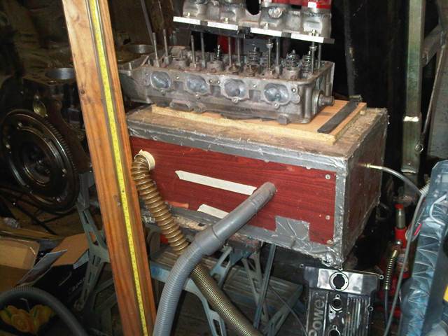

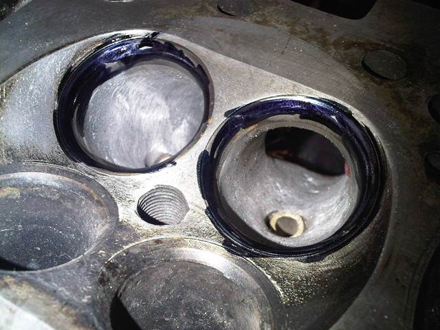

                          ok i dragged the £24 flow bench out again today, what i wanted to do was see what effect adding the inlet manifold to the head would have on flow, the answer being next to nothing infact adding the throttle bodies as well made more difference, i held the throttles wide open, but could close then a fair way before flow dropped more, i suspect it was actually the very long intake trumpets and joints between sections that was reducing flow, i did try without any trumpet and matters got a bit worse, but prob only because i didnt have anything on the t/b opening to smooth airflow, anyway im happy the modded oe inlet mounting thingys arnt hurting flow

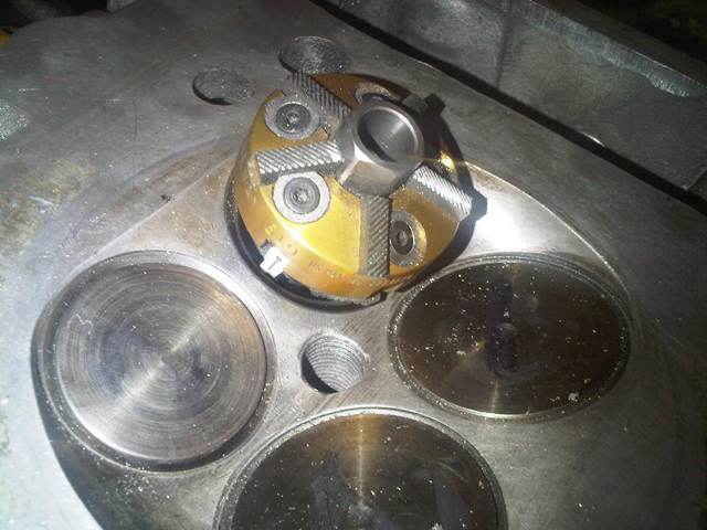

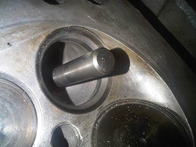

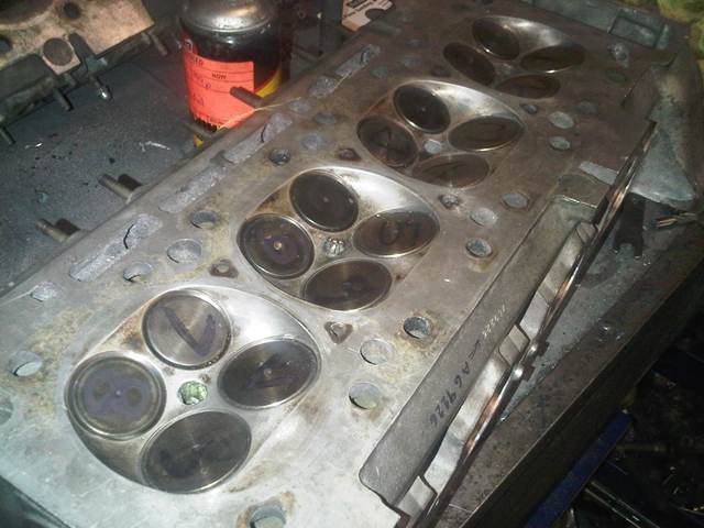

                          next it was time to finish tickling the valve throats
                          this head has had the seats recut before i got it, so i just lapped the valves in, turns out though the exhaust seats were very wide and left a sharp corner, so i put a 60 degree cut on them to narrow them, the inlets got a very very light 60 degree cut just to " break " the seat edges and improve low lift flow, worth having as the port shape looses some very low lift flow
                          TBH the guides are a bit marginal wearwise, and i had to "select" the best valves but the budget really has been blown wide open, especially as i just ordered a couple of new tensioner blades having decided i didnt have any used ones good enough to go again,painfull two blades are £ 420 did i say something about building an s14 being cheaper

                                Good to see the old flowbench being used again, I have been flow testing some different intake systems on mine with pinto manifolds, the trumpet makes quite a big difference to flow and the width of the throttle shaft is very important, the thinner the better.
                                About getting max flow with the throttle slightly shut, some people say engines can make more power when set up to give less than full throttle, it seems having the throttle open just enough to not restrict airflow can give better port velocity in some cases.
                                That is how fly by wire works, the engine is only ever on full throttle high up in the revs, which gives much better low and mid range power due to better port/intake velocity.
