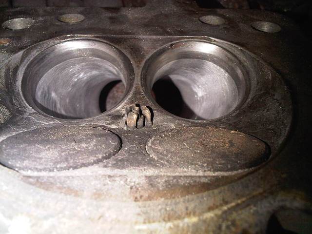

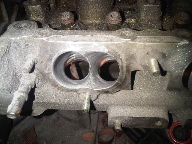

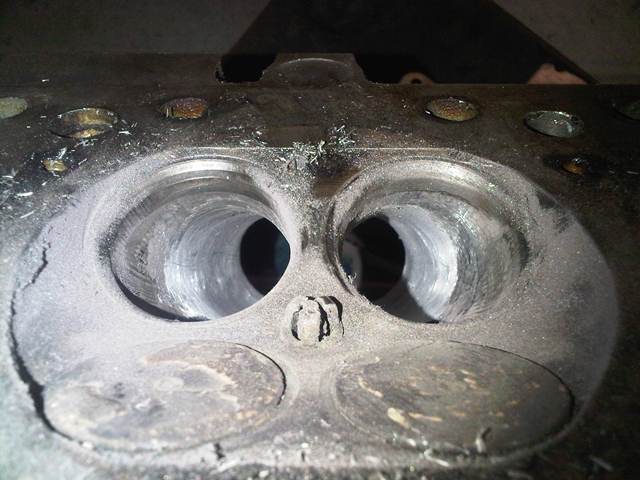

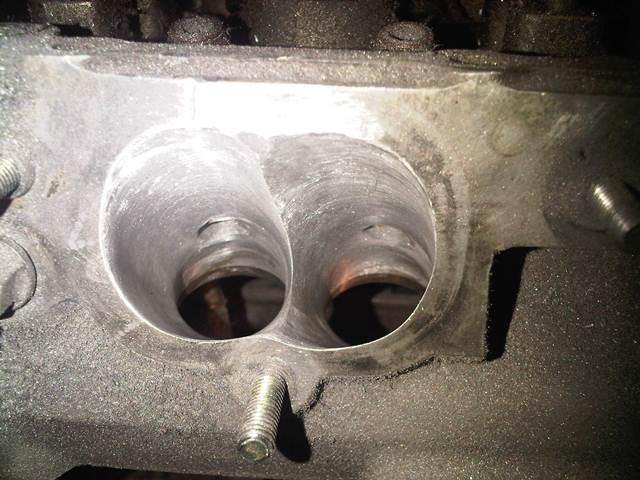

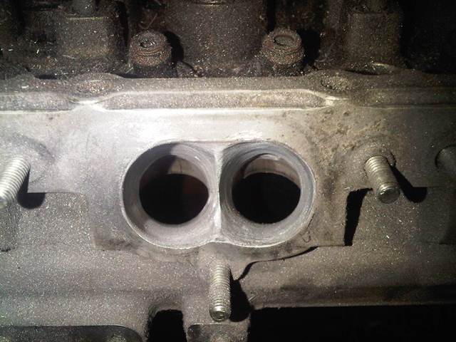

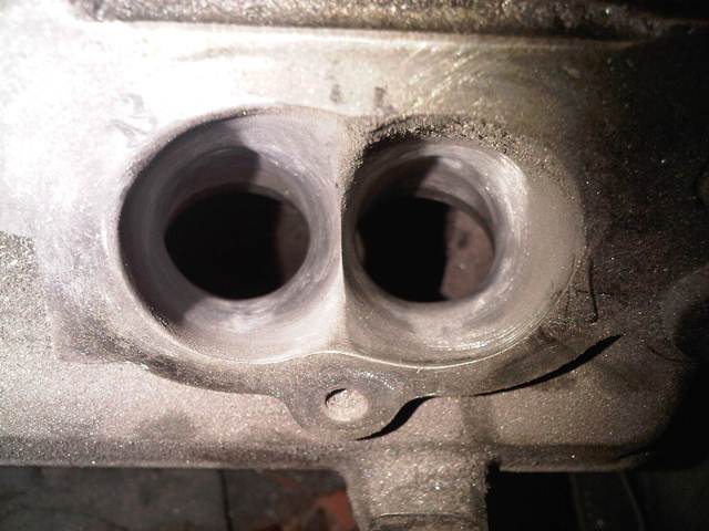

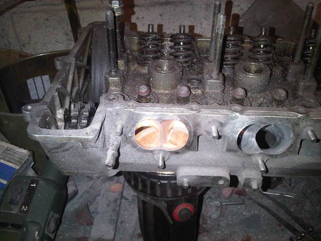

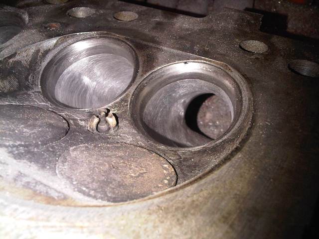

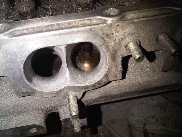

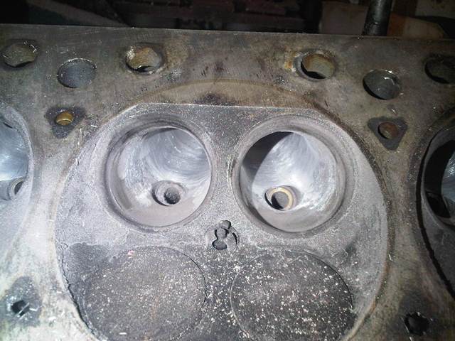

            a few pics from hours and hours of porting.
            the std inlet port meassures 26mm dia a mere 70 % of the dia of the 37mm valve it supplies, when i did the last flow test i'd opened the test port up 2mm and gained massively in flow so i've high hopes for the second stab at opening it up, it took one hell of a lot of grinding to get them out to 30mm which is 80% of valve size, infact i've finished the head at least twice then gone back for more! the last time i did some work on the radius of the short turn, ive probably lost some low lift flow and gained at high lift, i have a feeling though that on the face of it i 'd loose twice as the valves at low lift twice, i think i'll only loose once as on the closing flank the ram tuning at high rpm should keep piling the mixture in, well thats the hope anyway.
            of coarse theres always the chance i've made it worse but what ever its staying as it is!
            std unmodified port

              VERY tidy, hope it works as well as it looks !

                you might of noticed no mention of exhaust work, thats because its not needed the std exhaust port out flows the std intake by 120% so unless i get over 180cfm (unlikely) theres no need to touch em

                      great work on the head.
                      i love the all the development work in this thread,. keep it up

                              Some excellent work going on with that head, when will you be fitting it and getting the engine dyno`d ?
