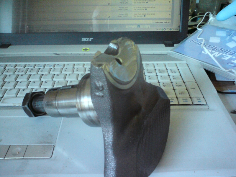

      SO, where did the crank break then Graham? Have you got a pic of the damage?

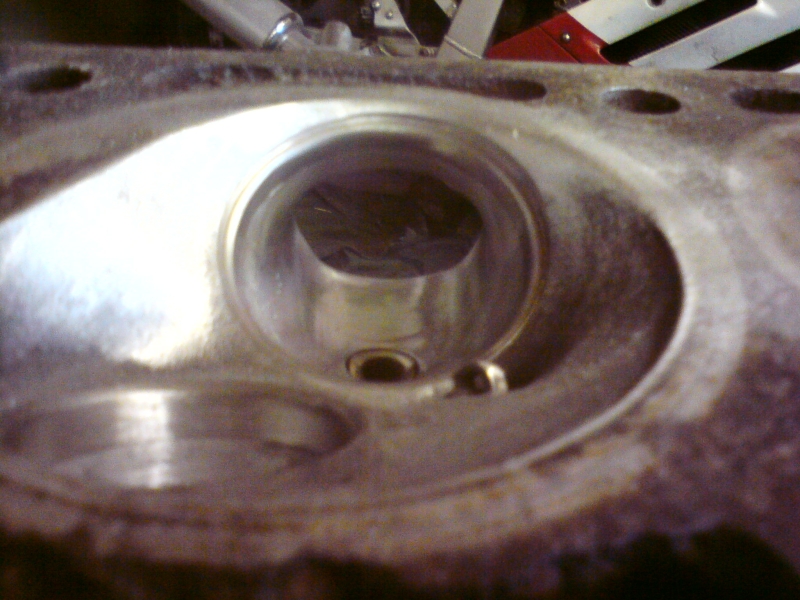

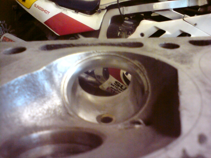

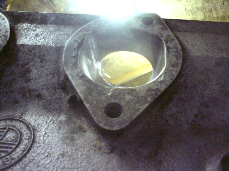

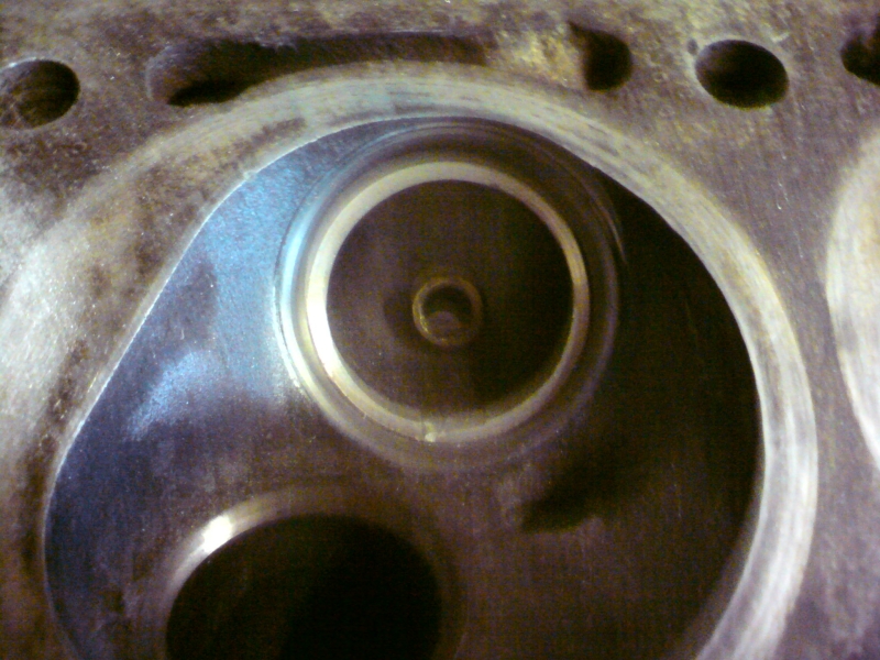

            still havent really done anything due to ongoing back issues, but i did recently get a bit of use of dave walkers flow bench,
            i took to of my experimentation heads with me, both i've had on my DIY bench, one was a small port 1.8 head, which has a raised port floor and i radically reworked, i had found flowed really well at higher lifts than my cam going and another more conventional 2.0 head, the flow V lift flowed the same pattern as my own testing.
            the 1.8 head flowed just over 120cfm, altough dave though it would flow better if it had a proper valve seat as the head didnt have an inlet seat because the 2.0 valve is so much bigger than the 1.8 one, so due to be opened up so much the inlet valve seated directly on the alloy head,
            the normal head ( which IIRC isnt as good as whats on my engien) didnt flow as well something like 110 cfm, but again dave thought he could see what held it back,
            so i've had a couple of inserts fitted to the 1.8 and done a bit more porting to both, the plan being to put both back on the flowbench to see which design im best using next year

              Do you think that your DIY bench is sufficient to develop a really good port or would you need to have the head eventually put on the pro bench to be sure that the work you have done is giving the expected results?
              What sort of bench is Dave Walker using?
                #1162
                Re: A race bmw 316, 240bhp Atmo M10
                dave uses a superflow bench cant remember which model thou.
                without doubt my diy bench is good enough to develop good port shapes, although my bench didnt give me flow figs, differences in flow between the heads at different valve lifts stacked up, so the results i got gave a pretty good picture of what was going on, in fact using it i found a flow gain from removing material from where you wouldnt expect to, which was subsequently comfirmed by a top tuner of these engines who has also developed heads on a flow bench, it just appears i might have missed a trick on the short side, but to be honest when i was last experimenting with porting i got to the point where i was running out of time and stopped looking for gains safe in the knowledge i had already produced a better port than i used to use on an engine which gave just over 100bhp per litre
                where i think the diy bench struggles is to record accurately very minor changes at high lifts, an example being i found no flow difference whether i built a plastoscene ring around the port but dave swears if makes a real difference on his

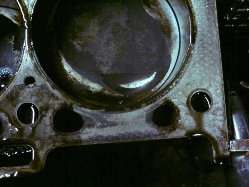

                        ok my backs finally ok enough for me to do a bit of work in the garage as long as i dont spend too long out there, wanting to make the job of getting the engine out easier i took the head off first,
                        as you can see an the exhaust valves (and most of the inlets for that matter) touched the pistons
                        hardly supring when you see the nose of the crank!

                          feck me, never seen that before.

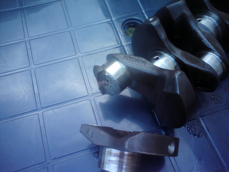

                            From the rings on the metal it looks like it started in the big end journal, probably where there was some flaw in the metal or some other weakness and worked its way out towards the place where it finally broke off. It does not look like there was much holding it in the end.

                              i'd agree , in fact there was nothing holding it other than no1 main
                              luckily the rods and pistons survived un damaged, the reason for drop in oil pressures obvious, clearly it shows how effecicent the pace drysump pump is because despite a severely knackered no 1 main and the oil way in the crank obviouslty being open i only lost 20psi oil pressure.
                              i'd say the crank broke simply through fatigue, after all it is only cast and has spent its entire life being revved to hell and back, the plus point is that clearly the dry sump has much improved lubrication, usually after all the use this engines had the bearings would be knackered but even no1 bigend which was obviously completely staved oil of when the crank broke was still in good shape and the rest of the bearing still perfect
