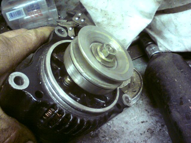

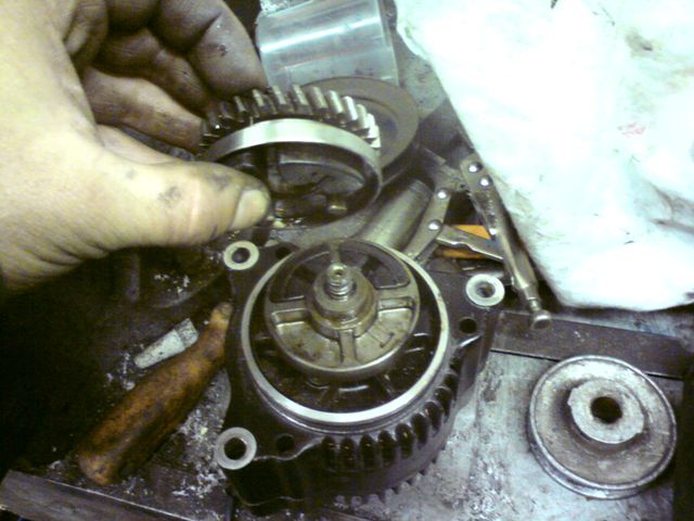

        the pulley on the alternator is actually two pieces, it contains a cush drive just like a bikes rear sprocket assembly, so i threw one half away and turned down an alternator pulley to fit in its place

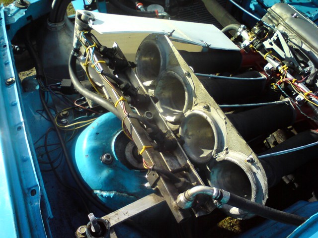

                      back in the paddock stephen found my glasses in the footwel and i had a quick look over the engine, in particular there appeared to be fuel on the fuel rail and around teh bulkhead behind no4 intake trumpet, it was fuel, fortunatly it was a cold morning so it haddnt evapourated, we assumed it was a leak, but running the pumps showed no leaks
                      then it hit me, it wasnt a fuel leak but at the top end the air rushing through the engine bay was dragging some of the fuel back, probably slightly starving the front cylinder of fuel and possibly over fuelling the middle ones and leaving the rear one about right, time to go raiding dustbinS
                      here we go a wind deflecter made from a bit of old halfords sign,

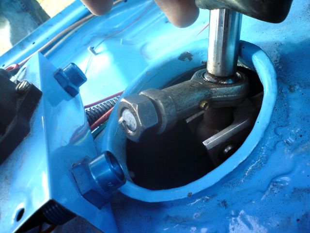

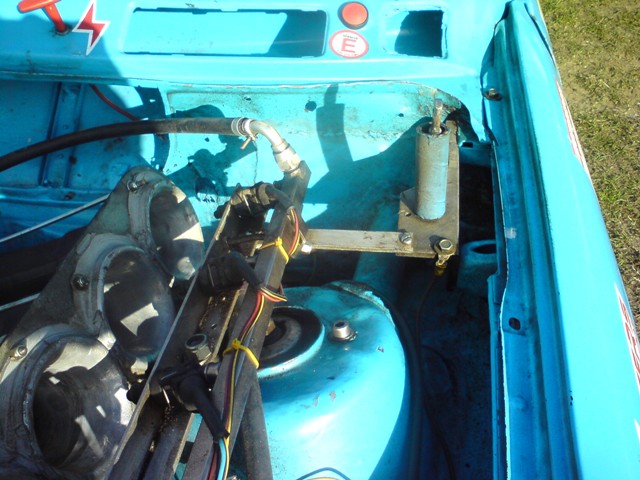

                      it turns out the gearlinkage remote stabalizer/support had snapped, a fatigue failure, a pukka race part i had bought some years ago, the bit that broke was a male thread cut (not rolled) into an aluminium shaft

                        Will the box be good again for Brands? If so I think the other class C cars will have a real fight on their hands now that you have a better diff ratio
                        With your injectors, how would they work if fitted into a cold air box? Surely the ram air effect would also disturb the spray pattern sending fuel away from cyl 1

                          the box will be fine, i just need to modify the linkage.

                          i dont think an air box would hurt because it has a back to it there wouldnt be a 120m
                          mph wind being able to blow straight across and away from the open intakes.
                          the old 2002 was fine in that respect the only difference betwen this and that was the 02 had a pipercross filter like yours and teh injectors stuck through it
