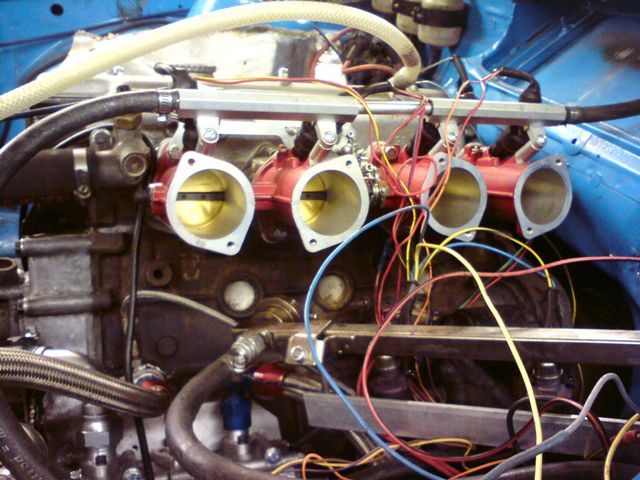

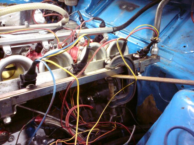

            one set of throttle bodies feeling rather naked

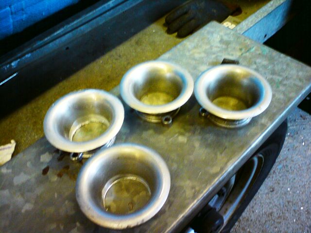

            to give some clothing options i bought some short rampips of cossie matt, these are intended for 48 not 50mm throttle bodies so

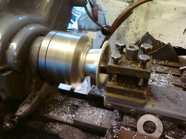

            i put them in the lathe and opened them out a bit, but to be honest i cant see a 2mm set doing anything, it certainly wont reduce flow

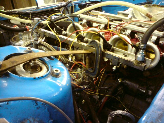

            with a strip of steel and a "G" clamp i have an adjustable mount for the outer fuel rail

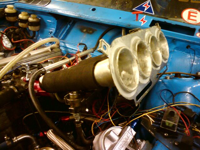

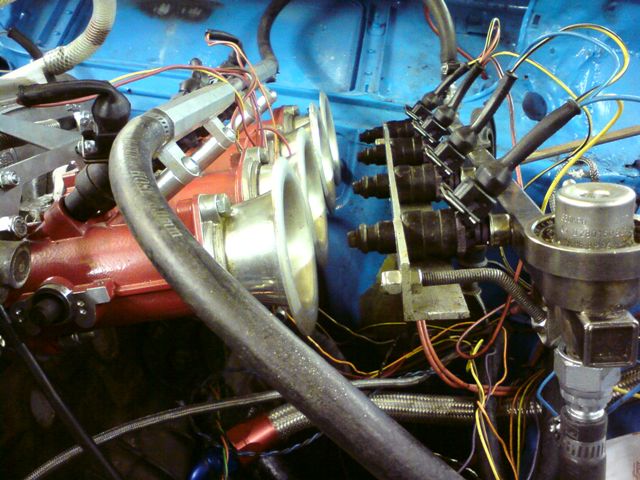

            the other intake trumpet option

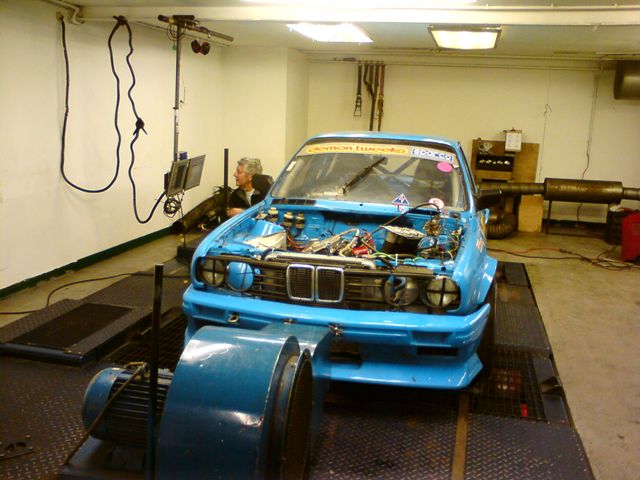

            dave walker fiddling with the ecu,
            we had a mapping session today and have learned a few things,
            we started out mapping it on the short ram pipes, peak power was a fairly dissappionting 206bhp with 185lbft,
            we then tried playing with the cam timing, allbet it i can only retard the cam, as theres not enough valve piston clearance to adavance it, it didnt like the cam being retarded, so a note to self is to put bigger still cutouts in the pistons over the winter so we can try advacing the cam,
            still feeling rather dissappointed with the power we switched to the very long trumpets, pwer leapt to 216bhp and torque rose by about 10lbft as well, still not great but dave looked at teh data log said err its gonna make more than that now cos its gone quite lean, and so it had,
            some more mapping and were upto 230bhp and 201lbft, which is more like it and the minimum i expected to achive, were going to have another go tommorrow and see if theres any more to be had

                        Did you try the 8 injectors yet or do they need mounting on the bonnet now
                          #672
                          were running it on 8 injectors because thats what worked best on the 2002, havnt tried it on only 4 mainly because i dont have 4 that are big enough without being way way too big, im using 8 purple ones from a late xe engine which are rated at 220cc per in @3.0bar
                          the injectors are all second hand, they havnt been cleaned but they have been flowtested and all were spot on
