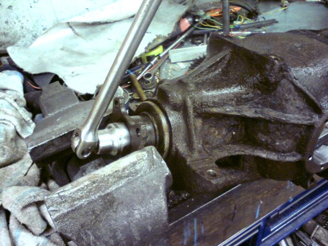

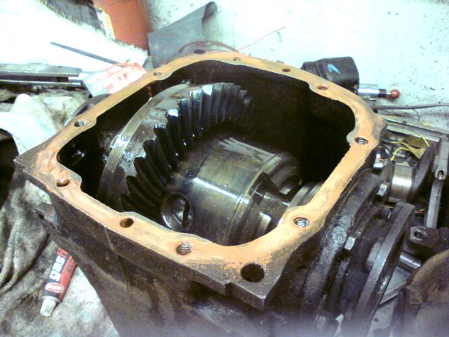

                      yanked the diff back out the car, wasnt expecting to pull it to bits so soon, but then again i didnt expect an engine with a cam that alledigily peaks at 8K to peak at 6.4,
                      i'd expected the big capacity to pull the peak down to 7 maybe but not that low
                      tightening up teh pinion nut on the 3.9
                      luckily for me i'd had the forsight to mark up the pinion nut and keep it together with its origonal ( unworn) bearings collapsable spacer and casing, so puting the pinion back in was litterally just a case of reassembling and lining up the dots, the rest wasnt quite so straightforward because i used the ouput bearing housings and bearings that belonged to the lsd rather than the casing to which the cwp belinged 3.9, it felt good when back together and "blued" up ok
                      i might add this sort of stuff really should be done by someone like tom fostek who actually knows what hes doing, rather than me who only sort knows a bit, unfortunatly tom cant afford free and if its more than free i cant afford it!
                      changing from a 4.27 to a 3.9 doesnt sound a massive jump but it makes a big difference especially when running huge 18 inch wheels like i am
                      i'll list speeds in top gear which is a direct 1.1 5th at peak power and at 7,000 which is where usfull power takes a dive
                      4.27 peak 113mph 7K 121mph
                      3.9 peak 123mph 7K 133mph
                      to behonest at a short circuit like brands i dont think the ratio change will effect lap times much but it will allow me to get from druids to graham hill without making either 3 gearchanges or revving the engine to 8.2 so it wil give both the engine and driver an easier time
