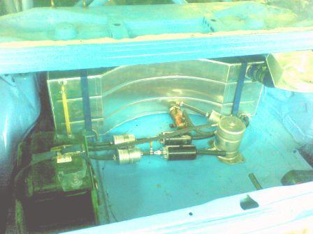

              i sorted out a new battery tray and retaining stap, as it broke free once or twice in a race last year the nice thing now will be i can change battries without using any tools once i change the terminals to quick release type, and not running an alternator means i do a lot of battery swapping.
              done a bit of plumbing now, tanks strapped in pumps are in, although i need to change the swirl pot, as you can see i have actually reused the facet, flow testing the pump on its own it actually pumped far more fuel than facet claim, but i suppose thats because it doesnt have a restriction to pump against unlike when being used with carbs, so i've stuck with it, it wont keep up with the main pumps and injectors once the injectors reach about 75% duty cycle, but i dont see that as an issue because they are never going to be open that much for more than 10 seconds at a time so the reserve of fuel in the swirl pot will keep the engine supplied

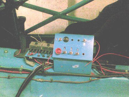

                i have been working on the car, although progress has been slow and theres little to see, most of the glazing is back in and most of the plumbing done, the exhausts back on
                i've nearly finished rewiring the car, its one job i really wish i hadnt started right now its taking forever, this car has a lot pf electrics for a race car

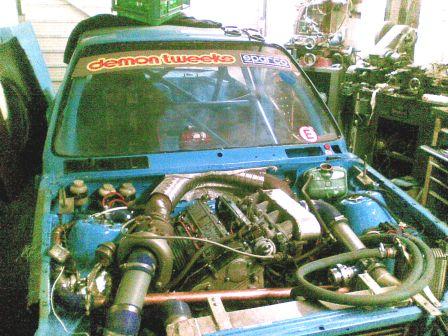

                    sorry for the lack of updates time is getting really short, but it now lives!

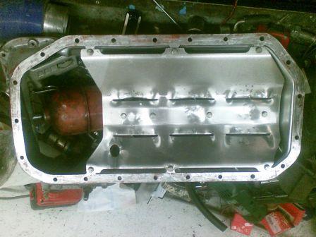

                    actually this is second time round, i fired it up yesterday and it had a horrible knock, rather big end like
                    although i new it couldnt be, after much head scratching i came to the conclusion that the bigend caps were hitting the scraper plate in the sump, which as rather baffling for a while because the sump is unclanged from last year, then i thought about the gaskets, the new sump gasket was cork, after retreveing bits of gasket from the bin i realised the cork gasket was half the thickness of the old one,
                    actually as the engine ran it quitened down a bit, did a dare leave it to sort itself out? after all it could only barely be touching or would that just fill the oil with swarf, hmm times a problem as sump off is either an engine out job or drop all the front suspension, either being a real git, eventually i decided i would have to have a look, after dropping lower well off the sump, i took out the steering rack, removed the oil pump and managed to wiggle the upper part of the sump out, sure enough the ends were hitting it, which was soon fixed with a big hammer, finding i didnt have any gaskets to put it back together i made some from some thick card in best hot rodding tradition
