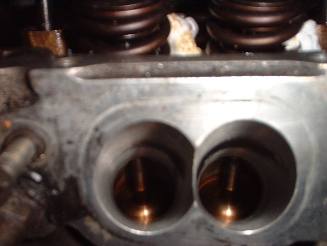

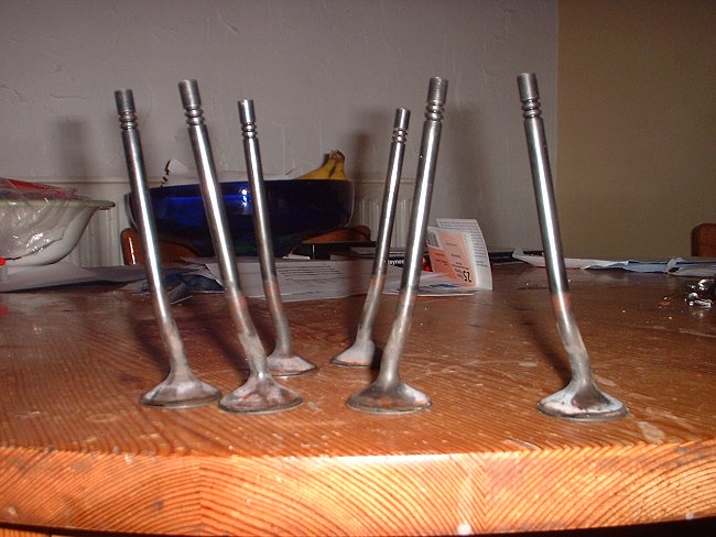

        head off and the exhaust valves are very bent!

          i've sourced another head, with a view to fitting that to get me back on track, although in the end i've just nicked the exhaust valves from it, as they will just seat on my origonal head, the reason for swapping valves rather than whole heads being that it saves swapping the manifold adapters over, needing to get a head refaced, and it haved the amount of work as i wont have to reshim the inlet valves, fitting the new would of probably dropped the power unless i sent a couple of days porting it to match the old head, the inlets in the new head being considerably smaller

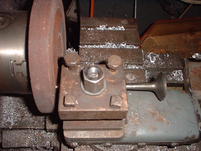

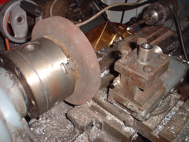

            after lapping in the exhaust valves to the head i realised i would have a problem with them being too long due to the head having been skimmed on both sides and the valve seats recut several times, which i recond would leave the valves at least 20 thou too long or in other words give me no tappet clearance at all, and i dont have shims going thin enough to get it either, they need shortening, unfortunatly you cant shorten valves on my valve refacing machine, so that usually means at least a couple of journys to a local engine reconditioner timming bits off and rechecking the lengths before trimming more off, a pain and time consuming and not something i can do over the weekend, after a couple of hours of thinking off and on i had the answer, the lathe, mounting a grinding stone in the chuck and a valve guide in the tool post i found i could accuratly shorten valves, and for free!

                    One thing though, thouroughly clean down the lathe after using a stone in there, its best to lift the tool trolley right off as you get bits of stone under there and it works like grinding paste on the bed.
                    We've got a lathe here that used to sit next to some blast cabinets, its a bit worn now ...
