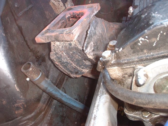

          back in the paddock gave the shocks a couple of clicks, only to realise later on they needed a couple more still, i also spotted a crack in the exhaust manifold, oh dear, fingers were crossed that it would stop at a crack, it didn't, the engine went like a rocket for a few laps, before the crack became a huge split and full boost became a mere 0.2 bar, i tried really hard, and made the beemer very wide, but lack of track time, not enough damping and sod all power ment i finished but down in 19th slot, still at least i finished twice, and was lucky to still have a turbo attached to the engine at all

              as for the manifold, to be honest it was to be expected at some time, turbo manifolds often crack let alone DIY fabrcated ones, i do need to think about how i might improve it, idealy have one made, but its about £1500 to get it done in the right material niconel i believe is the material to use for its low expansion and ability to withstand enormous heat.
              for the moment i shall just weld the manifold back up and hope that its worked out its stresses so its the shape it wants to be and wont crack again

                              heres some cracked manifold pics

                                Just spotted these pics Graham, must say it doesn't fill me with confidence about mounting my turbos
                                Could you have something cast rather than welded tubes. This should be a bit stronger and more flexible. My manifolds are cast and look really strong, the problem is though I haven't got a TVR or sierra width engine bay, so the turbos dont go straight on
